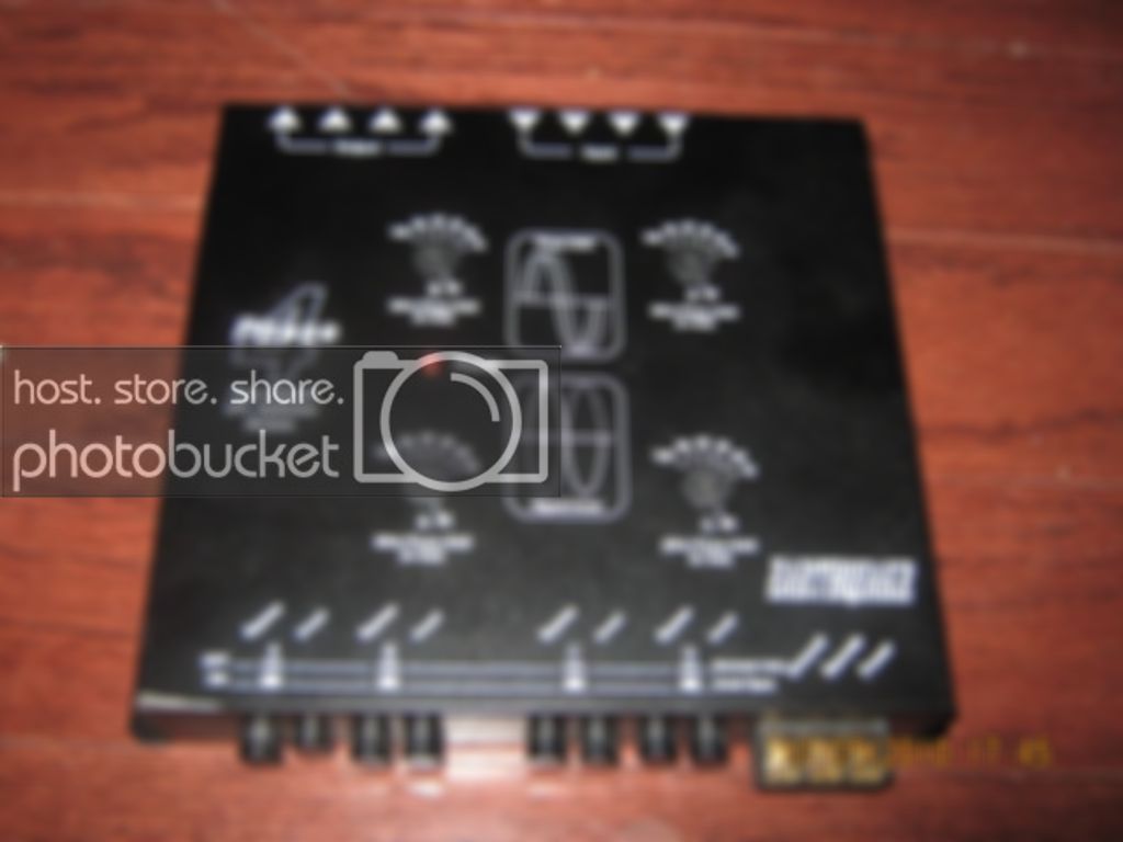

Yah, I'm not sure how a setup with a ton of phase shifts would actually sound, just that the sound would have highest amplitude at all frequencies when it reaches your ear. I do know for sure that phase shifting on subs can work really nicely, if you can actually shift the phase rather than just reverse the polarity like most amps have with the 0 or 180 degree phase. TA would be pretty nice but I don't wanna spend a fortune to get it. Weak.
