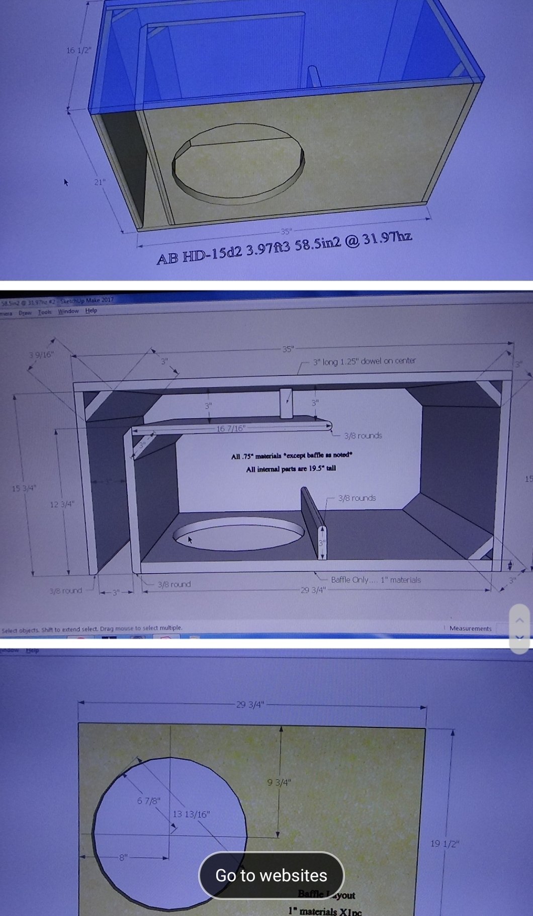

My box for a single American Bass HD15d2.

That’s port is gonna be 18.25 tall if it’s 3/4 mdf. If it’s 2 inches wide, that’s 36.5 in^2 of port area, which would be less than 10 in^2 per cube if there actually is 3.8xx cubes.
