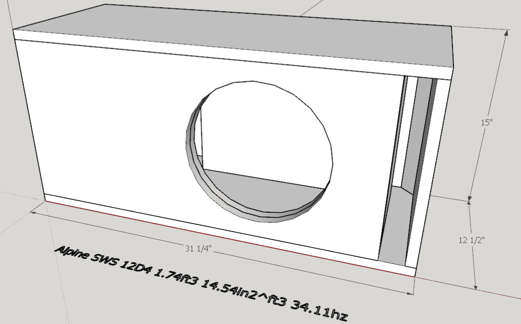

Pioneer GM-D8601, 2 ohms: 500 watts x 1 chan.Daily 35hz is fine. I read up a little bit on port tuning but still don't fully grasp what it means. The simpler the build the better of course; I'm on a tighter budget.
You think something like that would be too hard?
If you want the plans please private message me with an email as it's easier for me to group all the drawings together that way once I dimension and explode the thing.
That's for up to rated power and as large volume wise and low as I could tune with no power handling loss. Probably too much enclosure, but will do well on your power.

Dude got back to me about the sub enclosure
He said $150 to build it for me. He asked where the hole for the cables should go. Is it REALLY worth the extra $100 to go ported and custom built enclosure?
