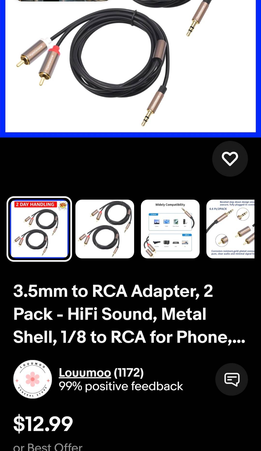

You can also try testing the amp by using a 3.5mm to RCA cable that connects your phone to the amp.
