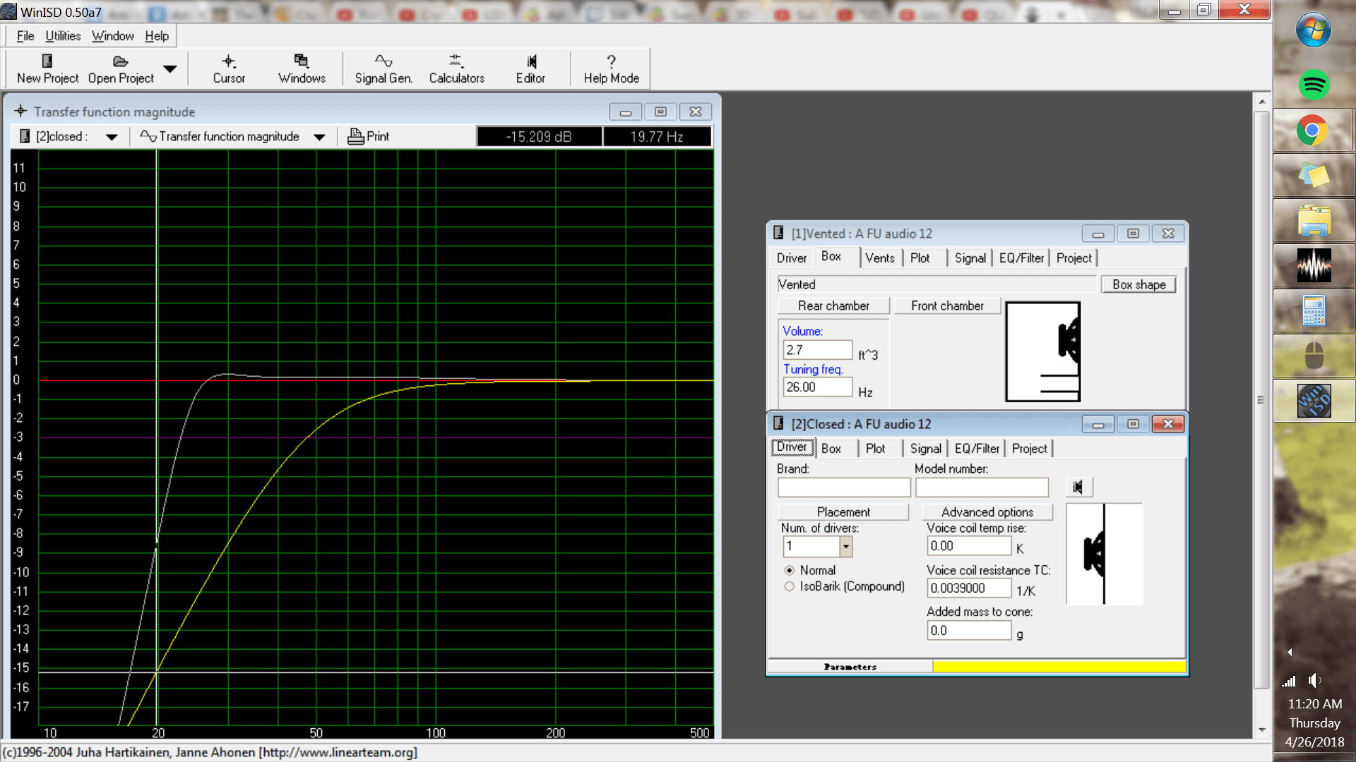

Sa-15 on a Synergy 3k... at... wait for it... 2 ohm... eventually ill get another and go ported but I modeled it up in a 4th and it may be peaky but it'll (or should) meet my goals. 2k+ on a Sa-15 should do ok... it's not a low tuned box but should go reasonably low for a tune of just under 50hz.

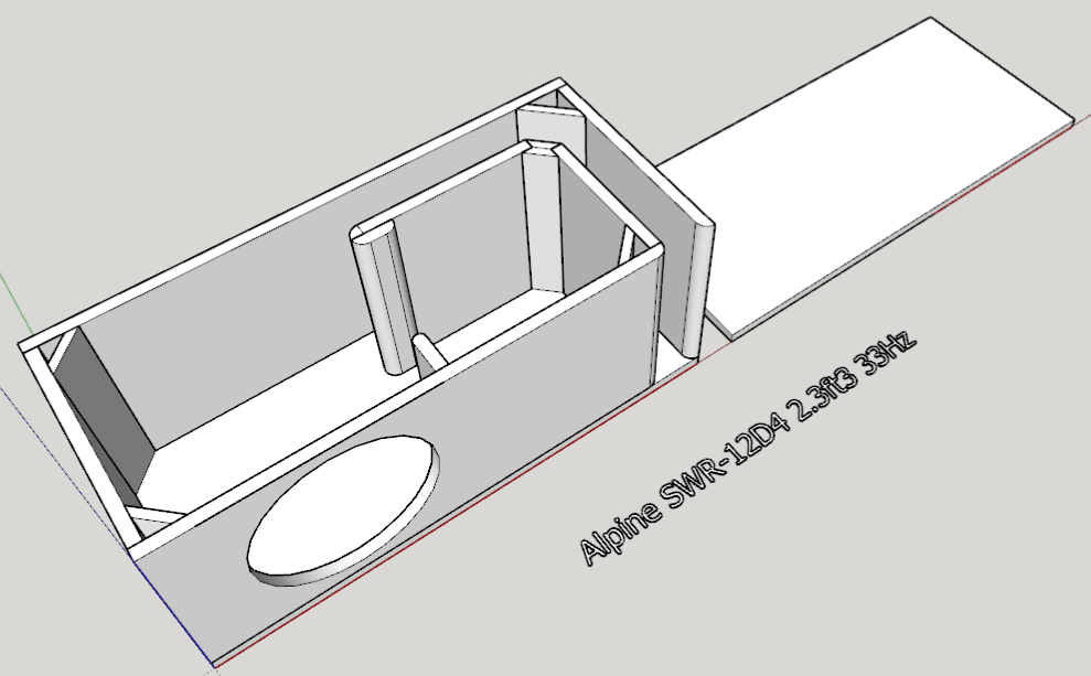

A truly well built and tuned ported box is what most would prefer over sealed. I am posting a picture of what you could do. But....

You need to learn how to model out subs in particular enclosures in winisd.
A proper sound quality designed ported/4th order or 6th order enclosure will have more bandwidth and accurate bass response than a sealed. If you have space, a 1/4 wave transmission line will outright destroy both options when it comes to sound quality.

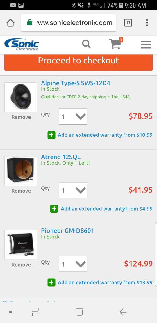

1.00 Cubic Ft.
https://www.sonicelectronix.com/item_31993_Atrend-12SQL.html
0.75 Cubic Ft
https://www.sonicelectronix.com/item_31990_Atrend-12SQ.html
So I'm planning on getting the Alpine. If I get a prefab, which one should I get? 0.75 because that's optimum, right?
I also found someone local who does woodwork and said he would be happy to build it for me, but I need to let him know the dimensions and everything else to send to him. If my budget doesn't allow, then I'd just have to get a prefab, then in the future perhaps get my own box built.

I'm reading above that you've found a builder, or someone who can possibly build something for ya'... If I help, lemme make sure I've got this correct.
Single SWS12 ported
Max dimensions 15h x 34w x 18d... that's 5.3ft3 gross BTW... it'll be a LOT smaller
What power you planning to run?.. amp/load?
Tuning?.. a daily 35hz or lower?
I'll post something up and you tell me if you're wanting to go ahead... at that point PM me
Would this be something too difficult or should I leave out the roundovers and 45's... simplify the port bend maybe?
BTW that's NOT for the Type S... that's a Type R enclosure below
I'll use some width but leave the depth as little as possible within reason.
I'm reading above that you've found a builder, or someone who can possibly build something for ya'... If I help, lemme make sure I've got this correct. Single SWS12 ported
Pioneer GM-D8601, 2 ohms: 500 watts x 1 chan.
