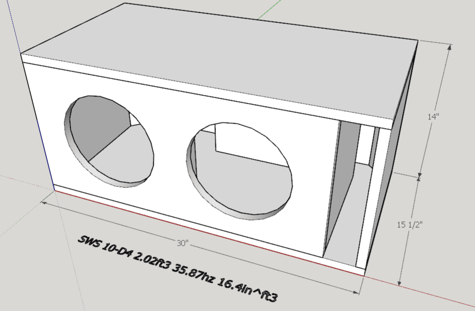

If it was me I'd look at the type S 10's or 12's and focus on having a correct enclosure built. They don't need a lot of power and sound good in a ported enclosure. Some folks like em in sealed but I'm about the way a ported box increases output where you want it to pound. Can you build an enclosure? Please don't pre-fab whatever you do. I wouldn't use a pre-fab unless it's sealed and then I'd use it for a last option. Doing the enclosure for the vehicle/subs/power and tune you want is super important... some people view it as just the box... lol... it's as important as the subs, you can buy a set of $500 subs and stuff em in an incorrect enclosure and that $1000 investment just sounds like a lot less... //content.invisioncic.com/y282845/emoticons/*******.gif.a649d21efc0d1fd4890a6428166586c1.gif...
Anyways that's one option and they are not very expensive, don't require a ton of power and sound good.
Do the enclosure right and you'll be surprised at how accurate it sounds...
Lots of other options out there for sure tho, but I like the Type S... 10's or 12's, whatever you got room for... which leads to the next question... what vehicle/space do you have available?
If it was me I'd look at the type S 10's or 12's and focus on having a correct enclosure built. They don't need a lot of power and sound good in a ported enclosure. Some folks like em in sealed but I'm about the way a ported box increases output where you want it to pound. Can you build an enclosure? Please don't pre-fab whatever you do. I wouldn't use a pre-fab unless it's sealed and then I'd use it for a last option. Doing the enclosure for the vehicle/subs/power and tune you want is super important... some people view it as just the box... lol... it's as important as the subs, you can buy a set of $500 subs and stuff em in an incorrect enclosure and that $1000 investment just sounds like a lot less... //content.invisioncic.com/y282845/emoticons/*******.gif.a649d21efc0d1fd4890a6428166586c1.gif... Anyways that's one option and they are not very expensive, don't require a ton of power and sound good.

Take a look at that enclosure above... think it'll fit and go in? That box would do well on a basic 750-1000 watt amp, most likely put those Pioneers you heard to shame. If you list max space for design help... make sure it'll go thru the opening.. lol
Okay, so I think I'm just gonna do a single since I'd like to save tunk space (and $$$). I don't think I could build my own enclosure. Tomorrow I can measure my trunk and update y'all.
