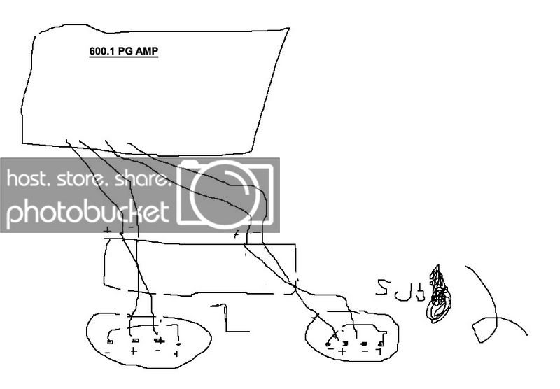

and I toyed around with it and now its messed up..... I even switched around the wires like 4 times to see if I got a difference, I know that would reverse the bass and instead of pushing air out it would push in... I believe.. but I dont know shit isnt correct maybe I will draw up a diagram how the wires are worked up...
Thats how it was before I touched it, and it is RIGHT now.. and I still have the problem... I put everything back the way it was...
Dont mind the drawing .. its really bad..
Each sub is in series. Are they dual 2, dual 1, or dual 4 ohm voice coils?
What are your amps and subs rated for?
Make sure each sub is wired exactly the same, including the + and - on the amp. If you have one sub wired backwards, the sound is likely to cancel out.

alright so the + speaker wire connected to the amp and box should be connected to the + VC on the sub?
They are a Dual 2ohm sub.
Yes...but just make sure that both subs are wired the same also. Because if both of them were wired backwards, then it was alright. But if you wire one of them normally, and the other is still backwards, then you're going to get cancellation.
I think they were both wired backwards to begin with... and I fixed the one sub that I thought was wired backwards and the other one was fine...
I thought the one sub would be messed up...
Anyways today I finally fixed it I put the wire that was dotted red on the + line not the negative both wires were there I dont know why...
I also noticed that one sub both speaker wires were switched around The amp - was going to the box + It was a complete mess....
anways I fixed it and I think it was actually louder then before... its not capping out at what it use to any more..
