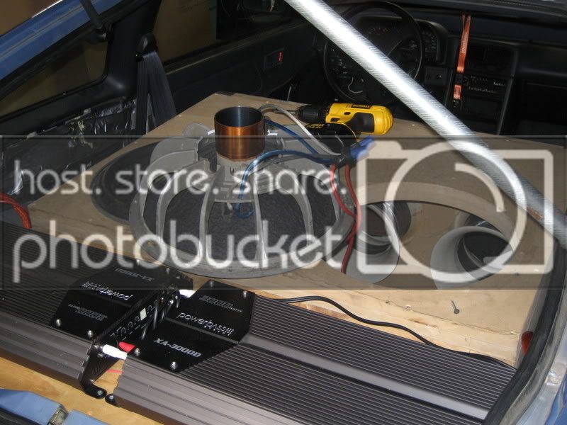

How does this happen?

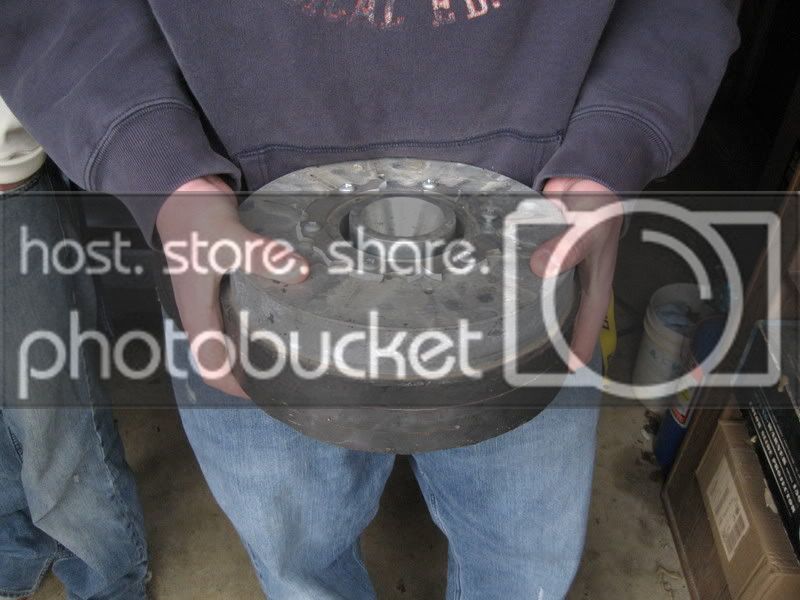

6 screws held the basket to the motor, no CA glue between motor and basket.
2 of these screws were the correct size, and 4 of the screws did not even thread into the motor because they are too small.
^^ See the size difference.
When the sub was removed from the box, only 1 screw was holding the sub together (one of the bigger screws).
Is the lack of (correct size, fitting) screws the reason this sub came apart?
