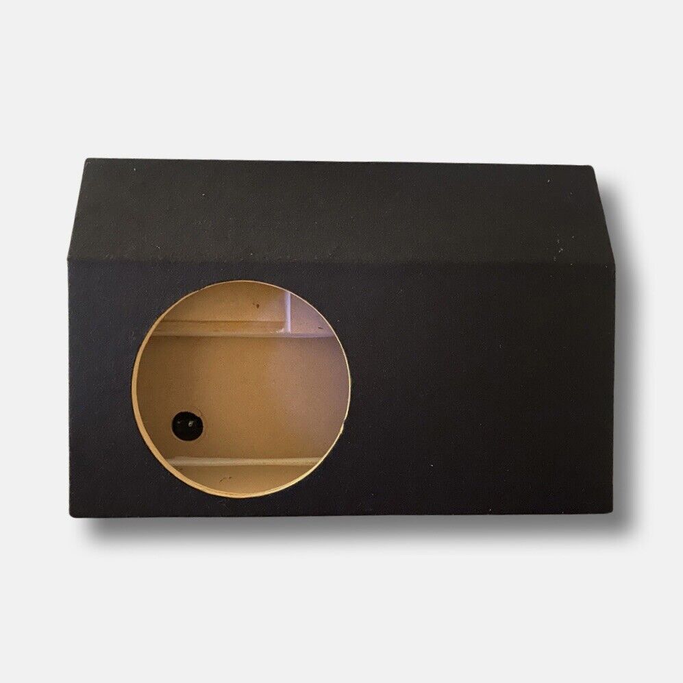

Sub cutout
Why not add a second baffle? Those L7 like more airspace than a typical 10" sub anyways so anything extra is a move in the right direction.

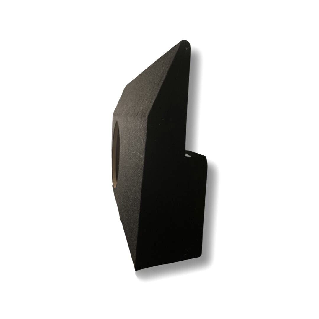

Problem with putting another baffle is this enclosure fits behind the seat of a crewcab Tacoma.

This enclosure is made to fit behind the seat of a crew cab Tacoma. So no room to add another baffle
