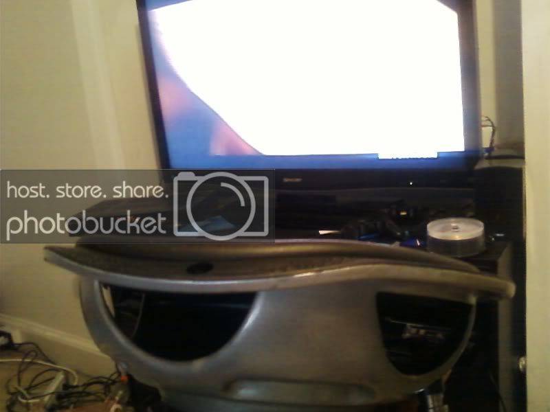

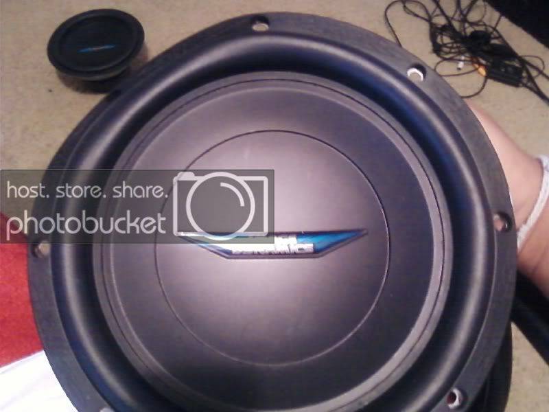

my sub is bent. are there any damage? any way to fix it?
did you buy it used? or new from an authorized dealer?
i bought it used from someone but it was definitely USPS fault. good thing its insured. if there are internal damages, imma file a claim. but if i could just hammer it out tor something with no damage internally, then i keep it

try screwing it into the box to straighten, not sure if thatd provide enuff strength might ned to try to screw it into a metal plate or something. Also, if its a metal basket (i guess it is?) it will lose strength bending it back, but i dont think thatd matter too much since subs are stationary hopefully it doesnt get brittle
ouch!! that would ruin my day. hopfully all it will take is sum hammering. id use a rubber maillot first to see if that would work might save it from dings or nasty scuffs. does it have any scrapping sounds right now the way it is, i hope it didnt pull the VC out of alignment. or bending it back might knock it out of alignment with the pole piece.
