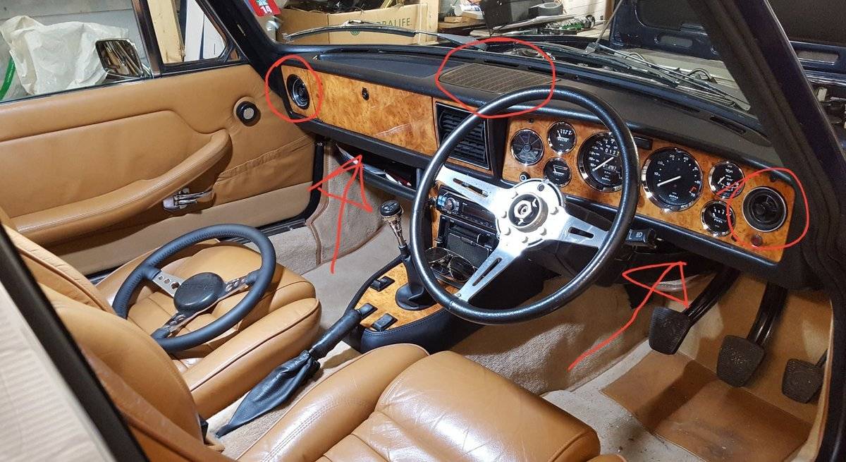

Hi – looking for some setup advice. I have a 1974 Triumph Stag and want good clarity, balanced sound while being discreet. I’ve lived with my first effort long enough and it’s wrong:
[SIZE=11pt] [/SIZE]
Two tweeters behind swivel air vents either side of the dash
Two 4” in the centre of the dash pointing up (this was original place for a single speaker)
Two 6” mounted under the dash pointing down into each footwell
Active sub in the soft top storage area
Speakers powered by Alpine head unit with good power (I’ll find out the spec and post later)
[SIZE=11pt] [/SIZE]
I was advised this would be a good result, and I was utilising some Bose speakers from an Audi A8 so was cheap too. However it sounds either too high frequency (even with the sub on full) or if I put more into the 6”, it’s too low. I rebuilt the whole car a few years ago and this in now the only thing letting it down, please help!

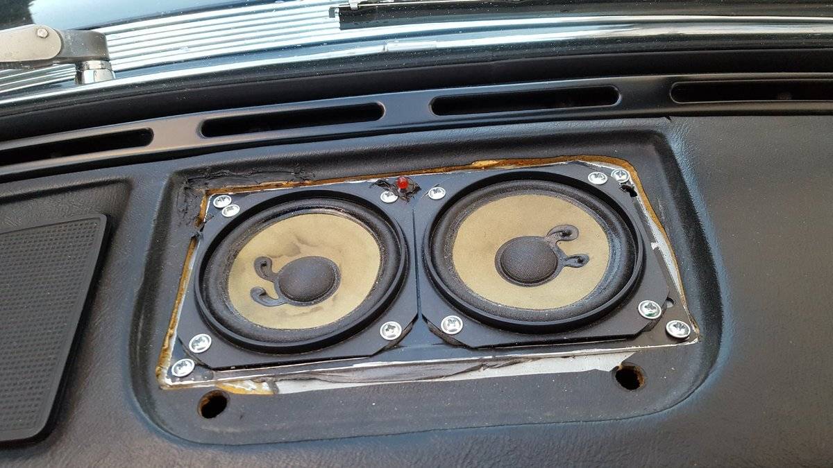

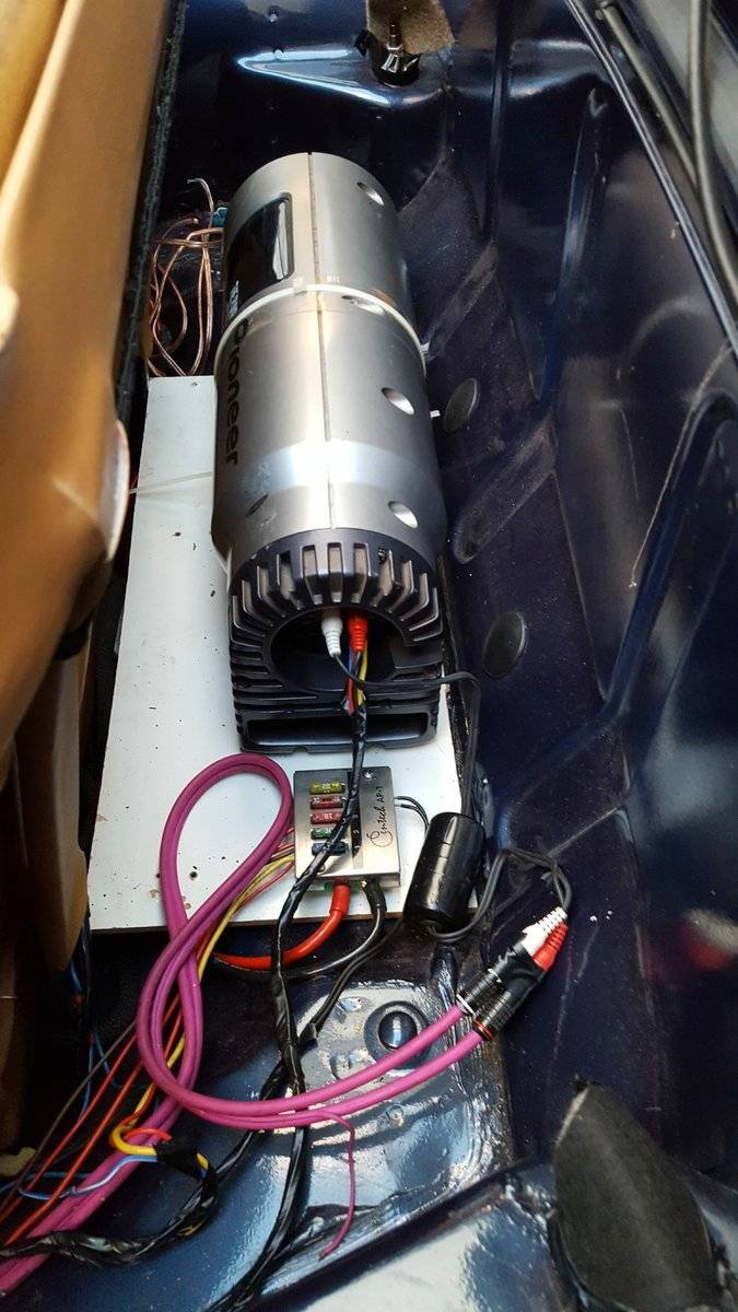

Sweet looking interior. I've never seen one in person.
for all this to work you need an 8 channel dsp to control midbass (6s) midrange (4s) tweeters and sub. You'll need a 6 channel amp or two 4 channel amps plus a monoblock or a 4 channel and a 2 channel plus a monoblock. You can also do  a 5 channel plus a 2 channel if you dont need that much bass.
You will get absolutely nowhere with head unit power so throw that idea straight out the window plus the head unit cant handle the ohm loads properly too, sooner or later you'll fry the head unit trying to force it to power all those speakers. Not to mention your distortion level is going to be ungodly high before you get into any real volume and that car is rather noisy i'd imagine you'd need to achieve at least a respectable amount of clean volume for any real listening.

Right now i'd do the amps plus subwoofer, plus this https://www.parts-express.com/dayton-audio-dsp-408-4x8-dsp-digital-signal-processor-for-home-and-car-audio--230-500 to control and blend everything properly together.
Allows you to control and blend all speakers and get a good tune. Your current speakers will amaze you when put on proper power and tune. You can think about replacing them afterwards once you see their true potential.
