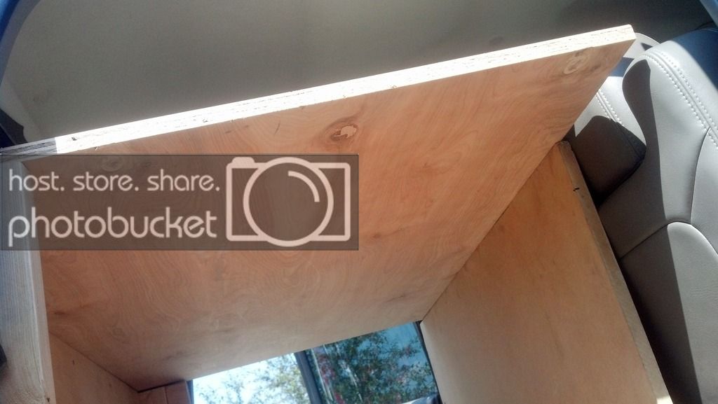

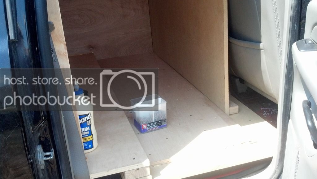

First layer of the top is cut:

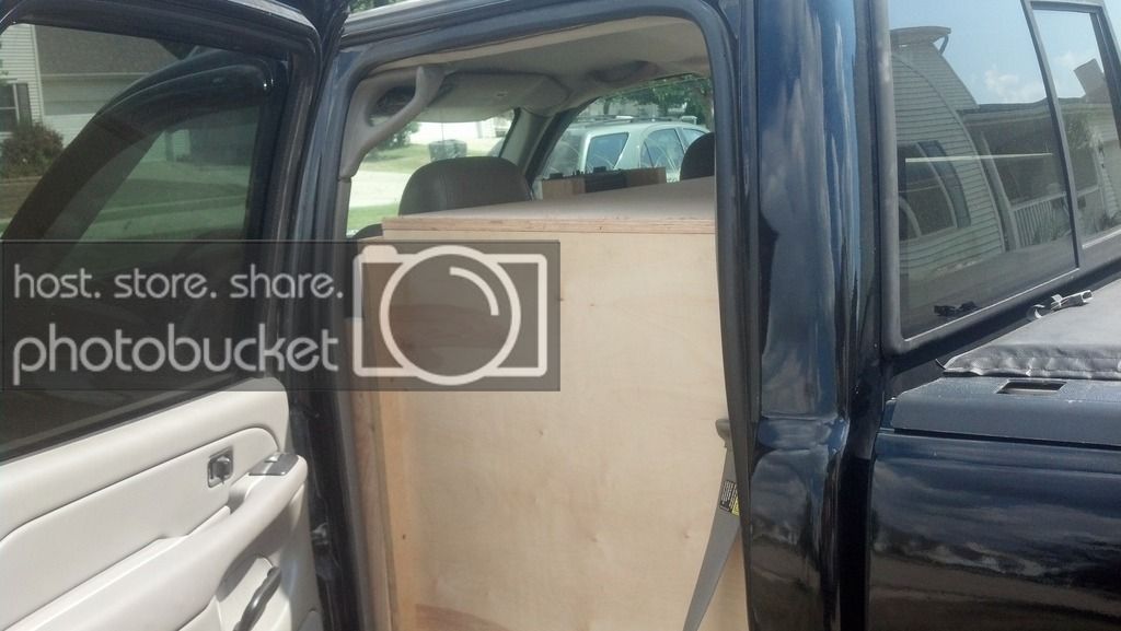

Then I got the first layer of the left side cut, glued, and screwed on:
Finally I got the second layer of the floor bottom cut, glued, and screwed on:
I'd like to see how that turns out. What's the specs on the 4th?
Thanks!
It's a 4:1 ratio. 5.2 sealed for the subs and a little over 20 cubes for the ported section. 250 square inches of port area 18 inches long.
Jack from DD Audio gave me Mike's number and said he was the man for a Z 4th order

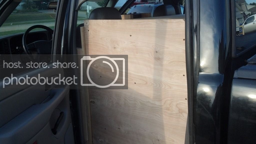

The second layer of the left side and the first layer of the top are now glued & screwed on. I just have the baffle, right side, and one more layer up top before I resin it and it's done //content.invisioncic.com/y282845/emoticons/smile.gif.1ebc41e1811405b213edfc4622c41e27.gif
