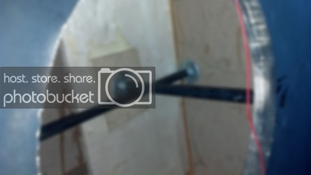

Got the third pipe threaded and installed. Hopefully I'll be able to do the last one tomorrow and resin the rest of the box

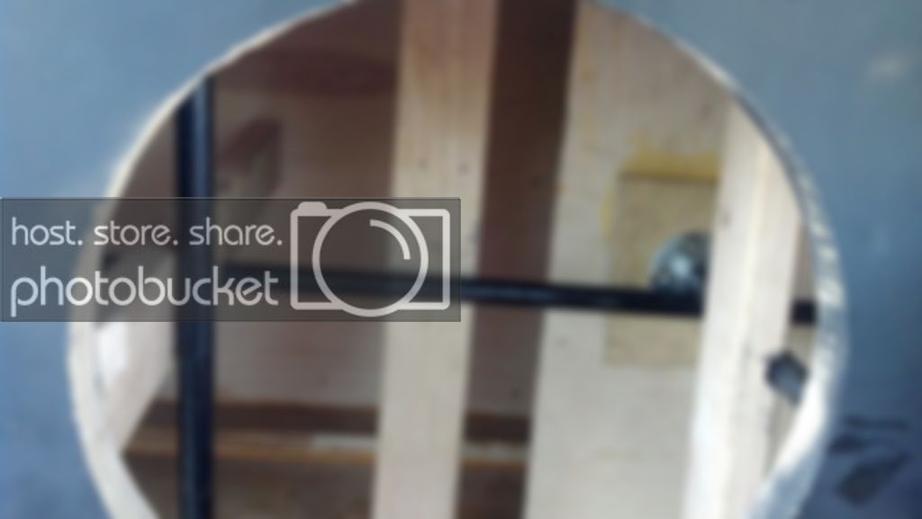

I called in to work today so I can hopefully get my box and driver's side door done. The inside is now braced with the following:
Top to bottom- Two 2x4's and a threaded pipe
Front to back- 2x4 and threaded pipe
Side to side- Threaded pipe
Port: Threaded pipe
I just need to finish coating the inside with resin. Then the box is done!

You give up on the pipe ? ? why 2x4 s ?
1. I had 2x4's laying around
2. Threading the pipe was a pain in the ass
3. Nobody is going to be able to see the inside when the subs are mounted
4. My box was plenty big, so the extra volume 2x4's take up wasn't an issue.
5. I returned the two pipes I didn't use and was able to buy duct tape and another flange.
I am adding one more threaded pipe front to back.
I lengthened the port to 43 inches now. The box is now about 17 cubes after bracing and still tuned to roughly 27hz. Port area per cube is now slightly more than 16 square inches //content.invisioncic.com/y282845/emoticons/smile.gif.1ebc41e1811405b213edfc4622c41e27.gif
I'm also currently adding a 45 to the corner of the port, and then sanding the inside edge

will that pipe slap against the wood if its not secured? never built a large enclosure so i really have no idea. just seems like it would
It's solid, but I was going to wrap fabric covered in resin around each intersection to add strength.
