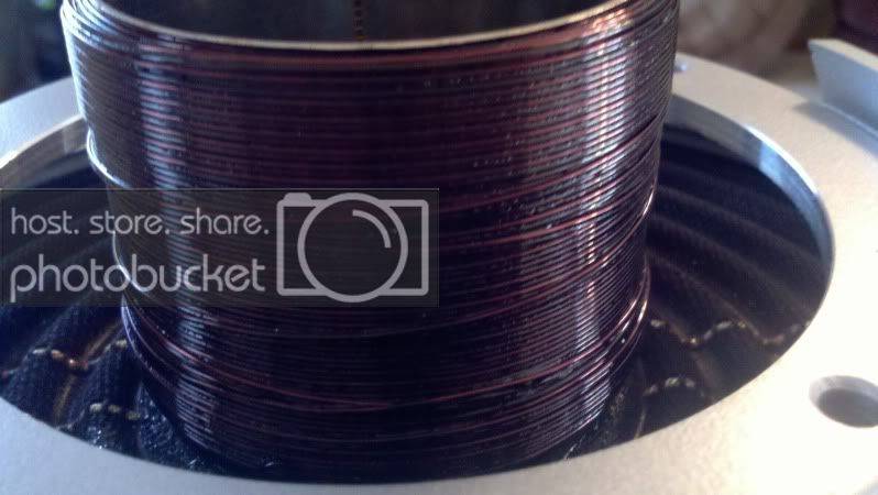

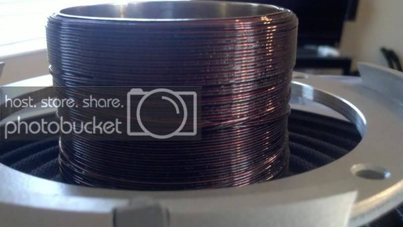

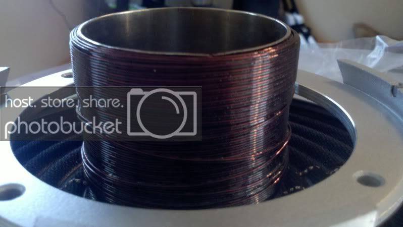

My 15 inch TC Sounds LMS-R showed up at my door a few minutes ago. While unboxing I took a few snapshots. Everything was fine until I saw the voice coil. Have a look.
This doesn't look right at all. Nothing is symmetrical and I doubt it would fit into the gap seamlessly. It actually looks like a 5 year old assembled the coil.
Am I way off here or is this just as bad as it looks?
I thought the LMS coils were designed differently, to increase linearity as the coil is moving in the gap. That does look sloppy though.

Doesnt matter what it looks like. Its designed like this for a reason, and you wouldnt see it anyway.
It's super difficult to wind an LMS coil -- inevitably they aren't super pretty coils... but don't worry, they are supposed to look like that.

Allows the BL to remain semi-constant at higher excursion levels.
