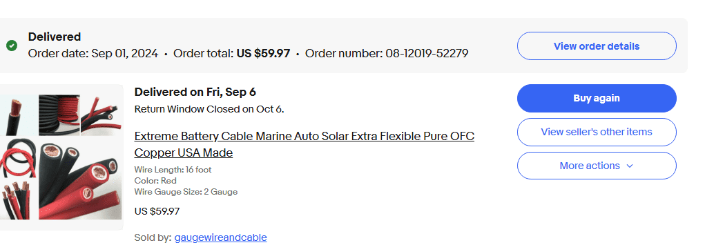

Do you remember the brand? Its hard to find good 2 ga
The cable has batterycableusa.com and trystar.com printed on it. It has a drop down menu that allows you to order various lengths.
Here is the link on eBay. https://www.ebay.com/itm/1320767374...d=link&campid=5335951755&toolid=20001&mkevt=1
