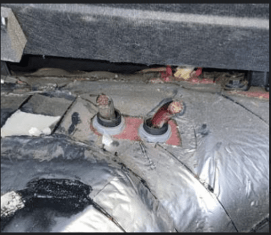

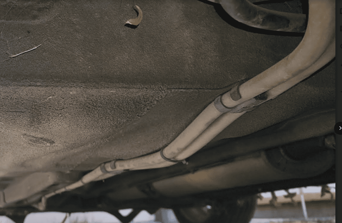

I'm running 2/0 between the fron to the back, under the car and up through the rear hatch.
Using thes clips underneath (eveybody alwasy asks)
This pic shows the cable coming up from underneath - previous build, but the same on my current car, a Mazda 3 hatch.

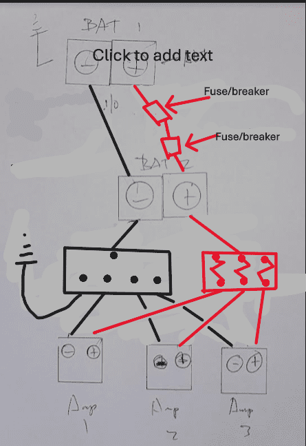

So is it safer to run the power wires outside of the car cause of the lithium or could I keep it ran thru the inside of the car. And I’m going to keep my stock lead acid battery should I get an isolator ? And what size fuse breaker?

For me it is a size thing. It is just easier to run larger cables on the outside then drill a few holes to get in the car.
I think it's easier, not asafety issue for me.
1/0, 2/0 ofc gets a bit bulky under the carpet inside the car, under the car is just the wayy i've always done large wire to the back of my cars.

Okay will do but do I need a battery isolator for using 2 different type of batteries?

An isolater is not required as the charging voltage on both is almost identical.
Charging voltage is the determining factor, not the chemistry.
