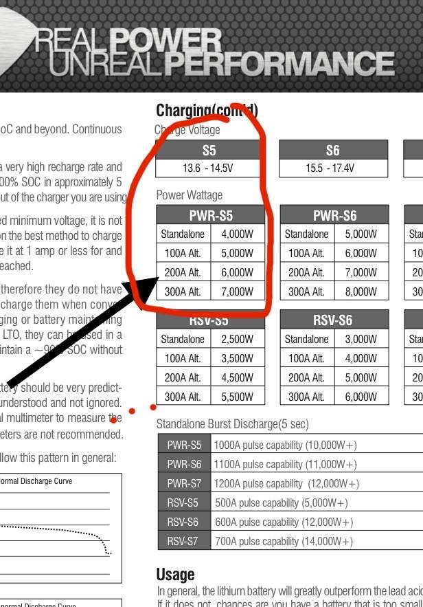

Okay so at that voltage that XS power battery would pop. They can not be ran over 14.5 volts. They are 5s .

No shit they are trying to make money. Did you mention your voltage at 15.3? 5 20ah Toshiba SCiB cells in series 100% SOC is 13.6 volts.
Even XS power tells you the warranty is void if charging over 14.5 volts.
You need sodium at that voltage.

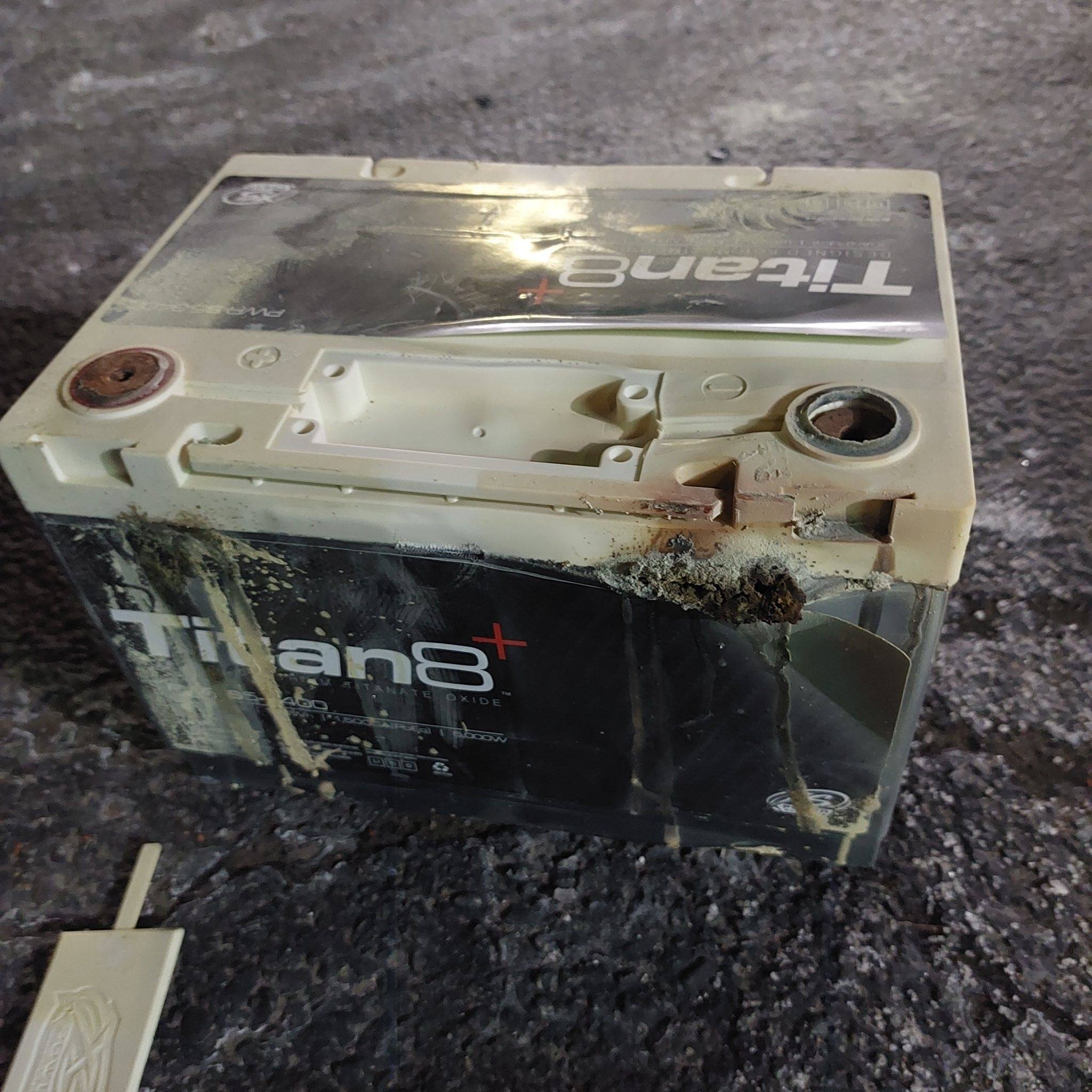

Feel free to actually do some research before you potentially catch your car on fire cause what do I know. :LOL:

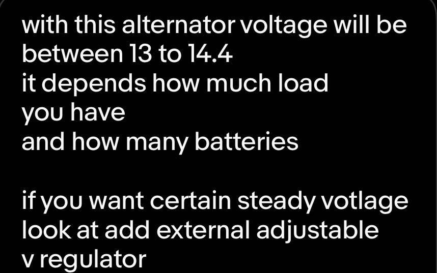

And this is what my alternator vender told me 👍🏽
Damn you must of learn from experience 🤣 yeah bud like I said before my radio showed that my voltage went to 15.3 cause when the bass hit it killed my battery I put the volume down at it just showed 15.3 for a second plus I contacted my vendor for my high output alternator they told me it only charges at 14.4 radio could have been wrong never tested with the meter that’s why I contacted my alternator vender told him my set up and the battery vender so yes I tried to do my homework bud plus that’s why I’m here trying to get good advice on a good battery set up

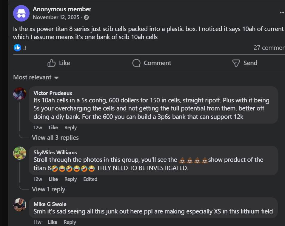

I just happen to know lithium but anyone who doubts my knowledge with it feel free to post in the Lithium car audio groups on Facebook and see what others have to say as well.
