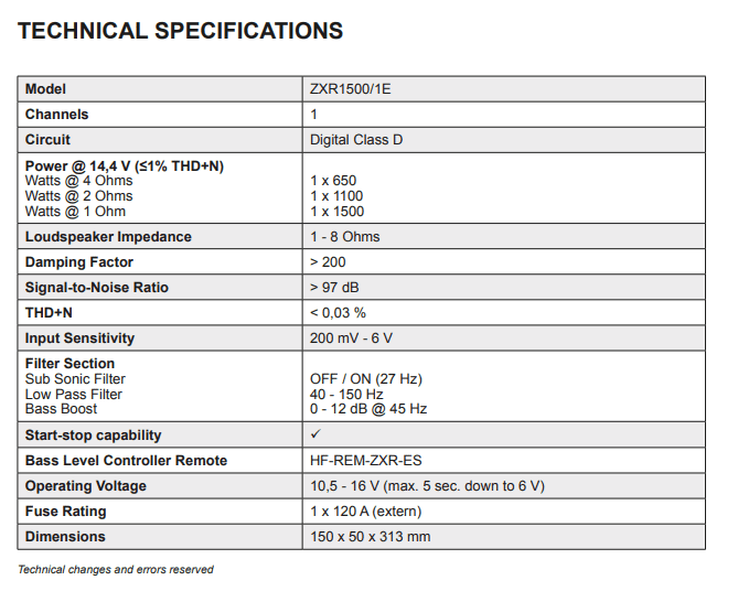

I don’t understand if the input level is the gain or what it is, since the manual doesn’t mention gain, so I don’t know if it always delivers 650W depending on the radio volume or how this amplifier works.

The amplifier's output power (650W at 4 ohms) is determined by the input signal and the gain setting. The amplifier will not always deliver its maximum output (650W) unless the input signal and gain are set appropriately. The gain setting is crucial because it adjusts the level of the input signal that the amplifier receives.
