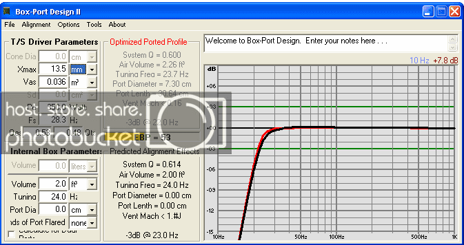

its just an example of what typically happens between sealed vs ported. sometimes seeing graphs helps a person to see what goes on.

This is the enclosure's curve, not the in vehicle curve
MY VENTED ENCLOSURE
THE SEALED ENCLOSURE FOR THE SAME APP.

BBP does. it has graphs for system impedance, cone displacement, group delay, phase response, vent air velocity, max electric input power, max acoustic power, custom amplitude response etc

heres the in car estimated frequency response for JL Audios 12w6v2 in sealed (yellow) and ported (red) in recommended size and tuning boxes
but does not account for every little difference from car to car and system to system etc...

I would be curious to measure some systems sealed/ported in vehicle and see with cabin gain what the response curve really looks like.
