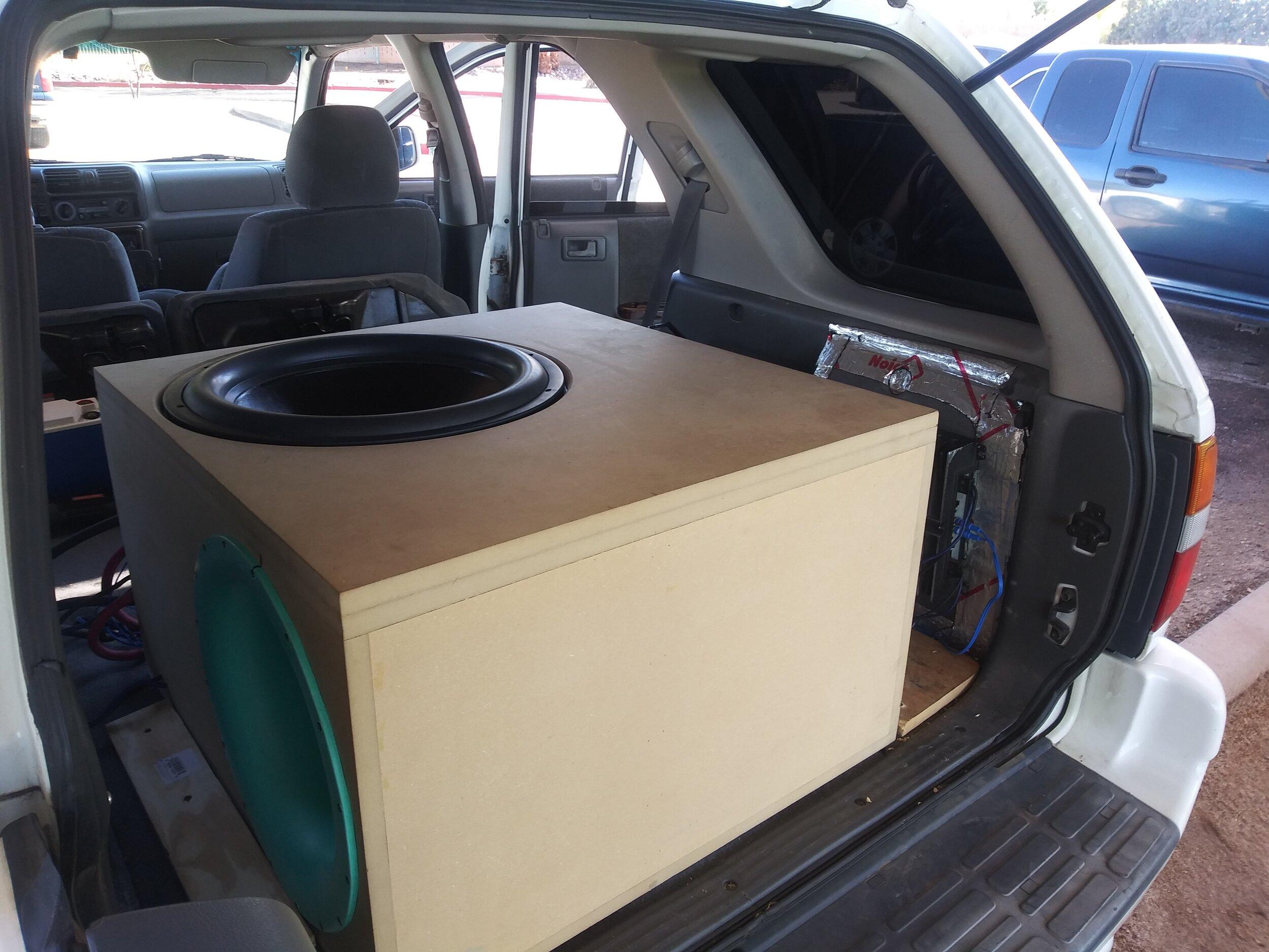

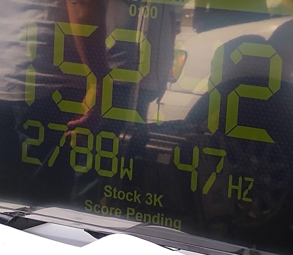

When porting a sub higher tuned, especially in a larger enclosure the peak will usually match cabin frequency and be boomy AF. Large enclosures with a higher tuning used to be the spl secret way back in the day, among other things.. Now its tune around the same and pour on the power as power is way cheaper than it once was along with driver power handling/capability. Through testing I went from a 6.5ft3 ported to 5.5ft3 ported and not only was I hitting better #'s with the smaller enclosure, power handling was greatly increased with the same tuning. And a lot less boominess when playing music... lol.

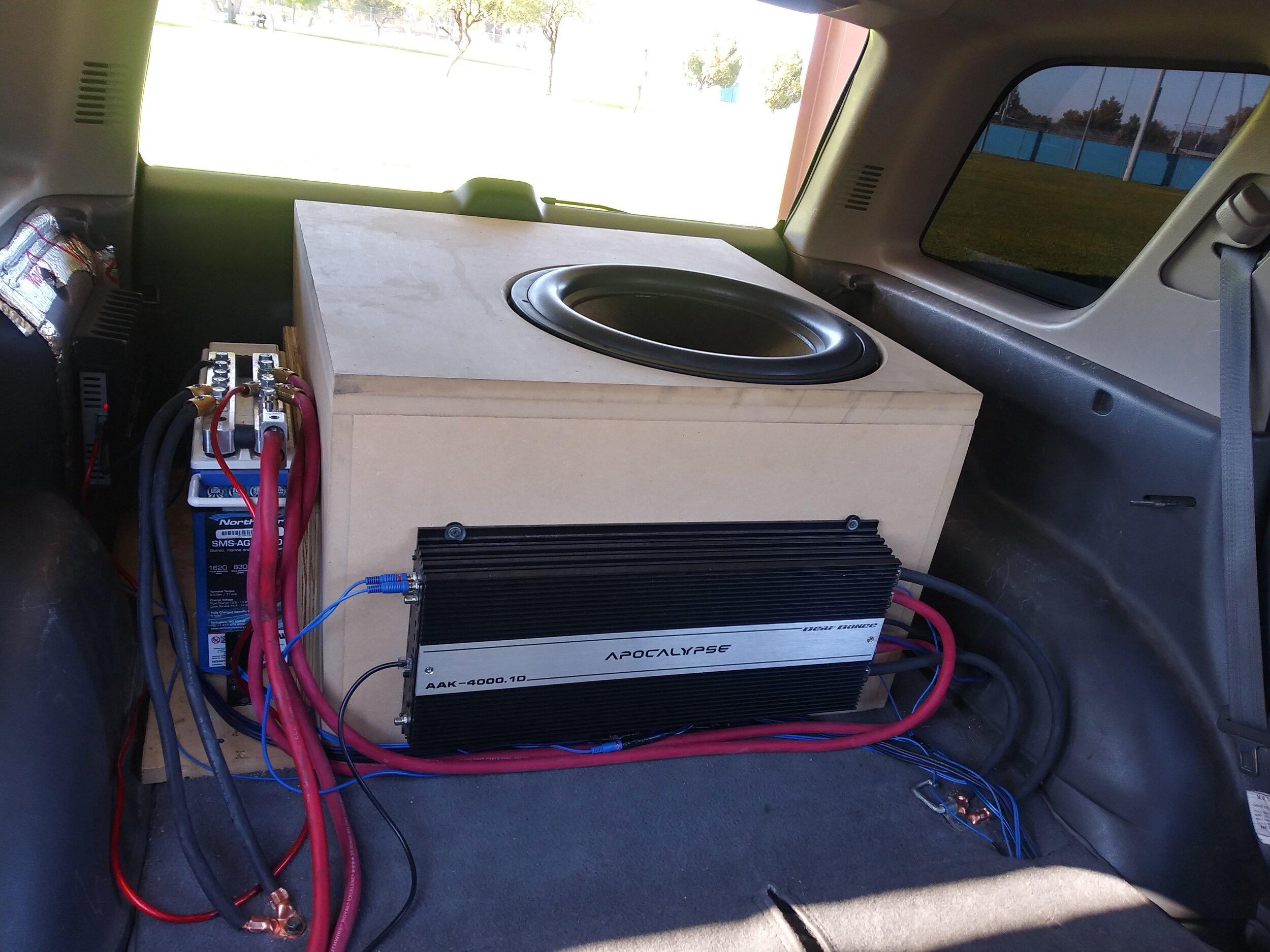

If the box is massive there will be a huge leak around tuning frequency. Kind of the reason I I don't use huge boxes anymore I just don't like the way they sound on the subwoofers I like to use. And if you look at the slope of a subwoofer with good motor force in a small box like 1.75 cubes tuned to 30hz, the slope is much more gradual rather than on a bigger box tuned higher and Unless you're in something as large as a Suburban or similar, you're looking at cabin gain around 40-50hz.
