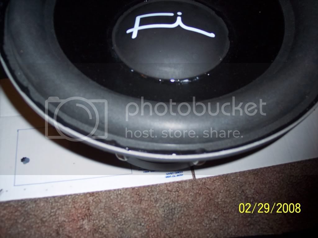

Here is a pic of what I did with my btl RECONE.
I put a bead around the whole outside edge to hold it extra
yeah. when i reconed mine i used blank sheets of paper untill i got a tight fit. worked out 100% for me.
I also used manilla folders for my shims but only made it tight enough so I could still get them out, You made it sound like the cone wouldnt move. Anything will work as long as you get it tight and don't overlap it.
