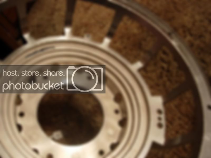

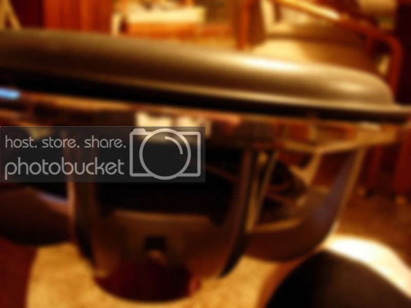

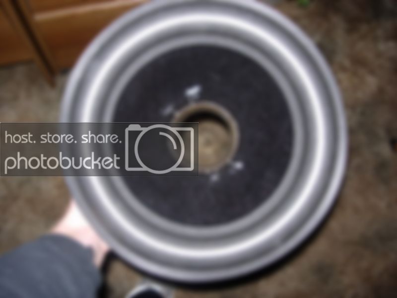

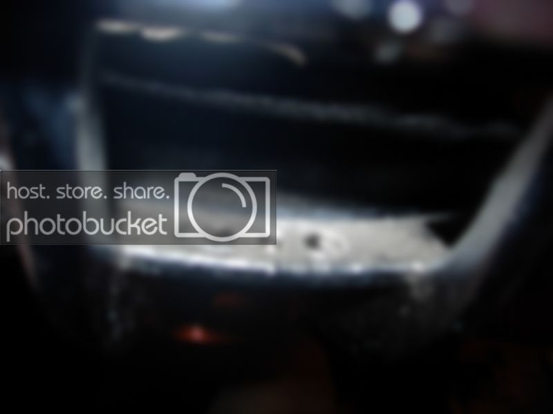

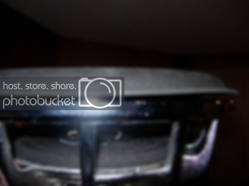

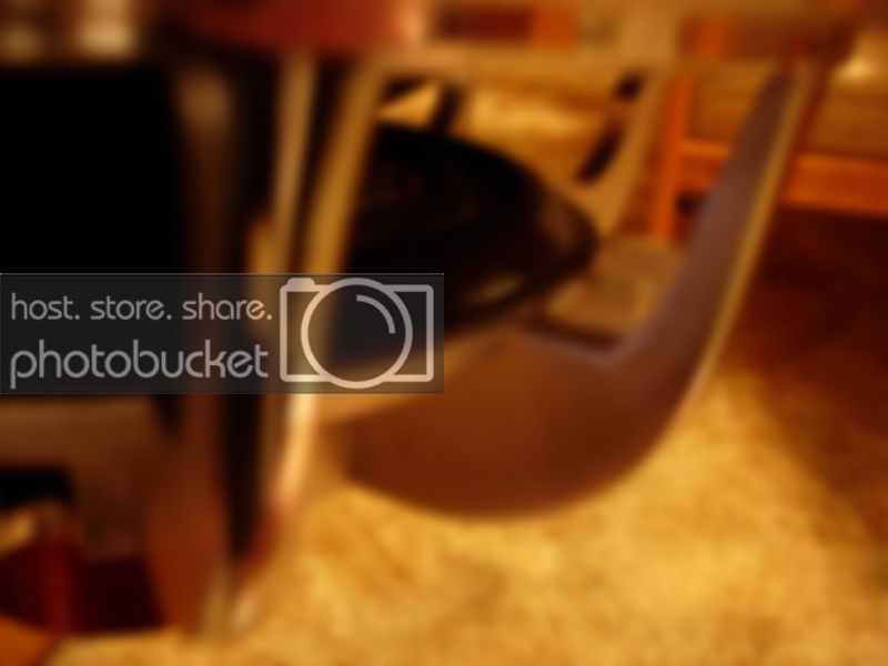

Well I got my recone in, and was about to glue it. I think the basket is too small. The spider sets right on the flat part of the ring and not down in the indentation like I think it's suppose to.
The cone does not set flat on the top ring and the spider is keeping it from going all the way down. Do I need to trim the spider or get a new basket. Here's some pics:
In the first pic, I artistically drew a black line; isn't this where the spider should set?
The spider is in the right spot. It dosent sit in the indentation it sits on the outside ring like in your pics. Now the surround does look a little high off the basket. Where did you get that basket from?
Yeah, it probably sets an 1/8th of an inch above. Almost level with very edge of the ring.
But, if I flip it over and set it face down with the weight of the basket, it will fit perfect. Is it just stiff? It's an old XXX by the way. Maybe since they're high excursion it's like this?
if its a 1/8 inch off i wouldnt worry. My BTL recone was like that. Just make sure to get enough glue under there to hold it tight. Do you have accelarator with the glue?
I have some CA Activator? I'm just worried about when I set the cone on I'm going to have to put something around the surround quickly. It will have to fit perfect around the edge. Shouldn't be a big deal I guess.
if you have the Black CA glue it wont dry that quick. Put a good size bead around the basket ring and a nice bead around where the spider is going to go. Put recone in and turn upside down. The weight of the motor should put enought pressure on the surround to hold it tight to the basket. Then use the accelerator and hit it on the inside of the basket. There should be glue that squeezes out when the basket is upside down. Once it holds turn it around and put some weight on the cone and then hit the spider with the accelerator. Then lay another bead of glue on the outsided edge of the surround and hit it again with the accelerator.
