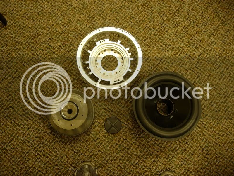

Alright, I've got it all laid out. I just need to find a bowl and get some clothes pins and I'm set. One last noob question ( and no where does any searching I've done say this): I do remove the shims before I put the dust cap on right?

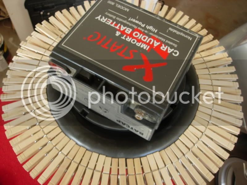

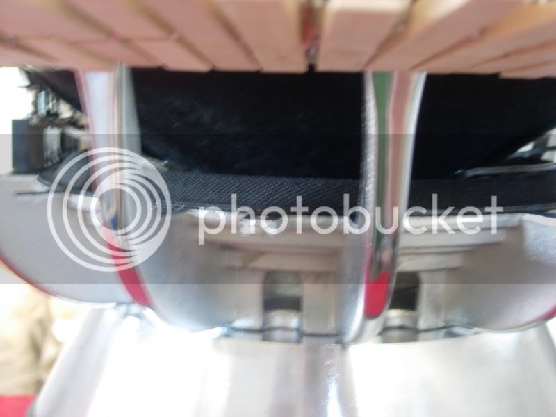

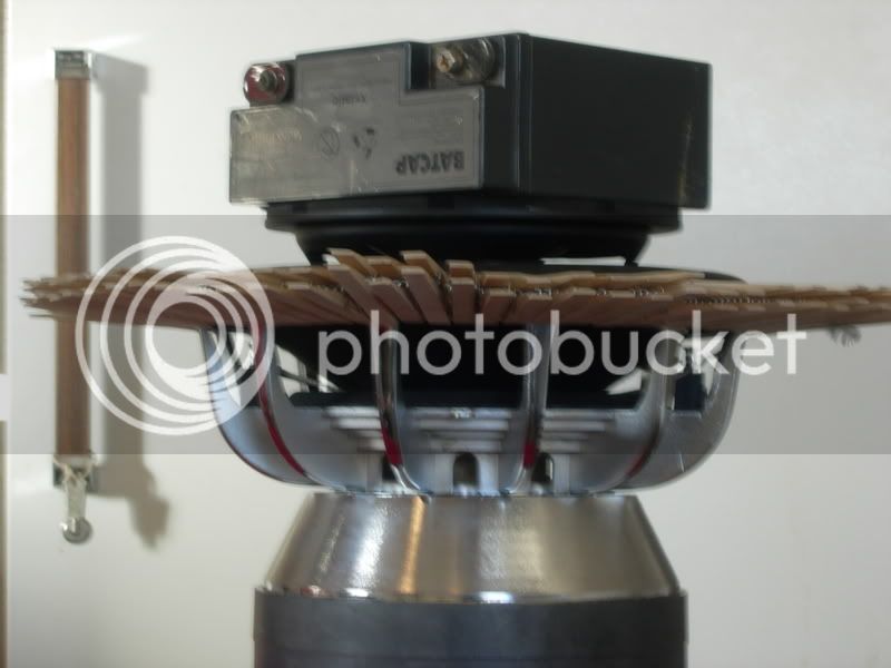

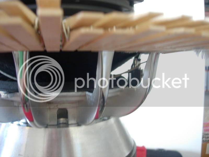

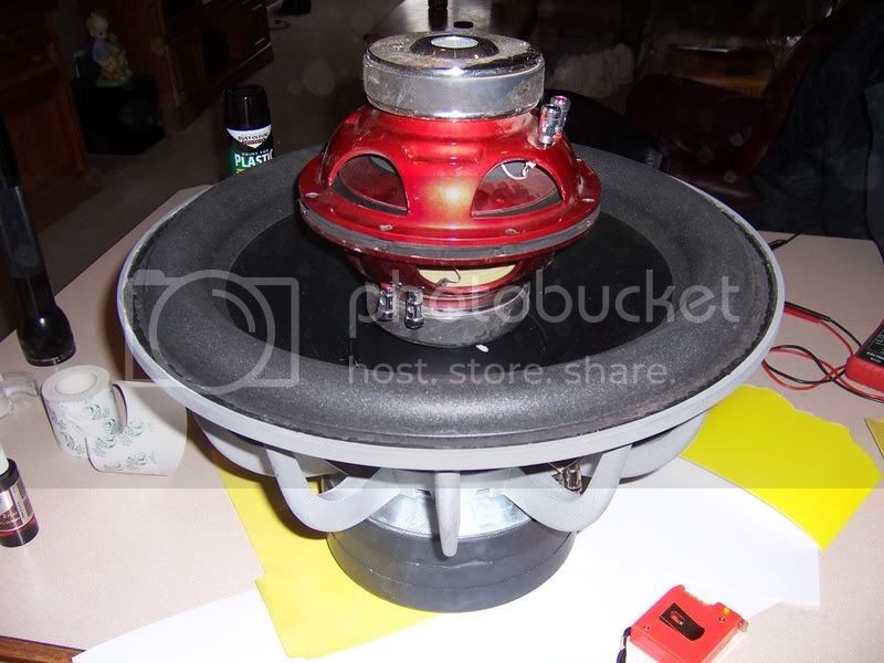

Well, it's on. Here are some pics of what I got so far. I didn't have a chance to do it last night; I had to be up at 5 A this morning. I JUST now did it and reconing really is easy. Take a look:

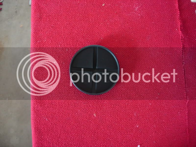

This last pic is a cap I believe goes on top of the coil, then the dust cap. Anyone think otherwise?
I followed the same procedure that pretty much everyone has been mentioning in this thread and others that are searchable. After I cleaned everything, I used a paint brush to apply the Epoxy. Yes I felt like using the 60 min Locktite over the CA glue. I applied Epoxy to the part of the basket where the spider attaches, then to the part where the surround attaches. Put on the cone, installed the shims, put one of the ED 8" & Batcap for weight and clothespinned the surround. Now I wait.
Before I go to bed tonite, I will hit the surround and spider once again with the Epoxy and let it set overnight. Soder in the morning, build the box and see what it does.
