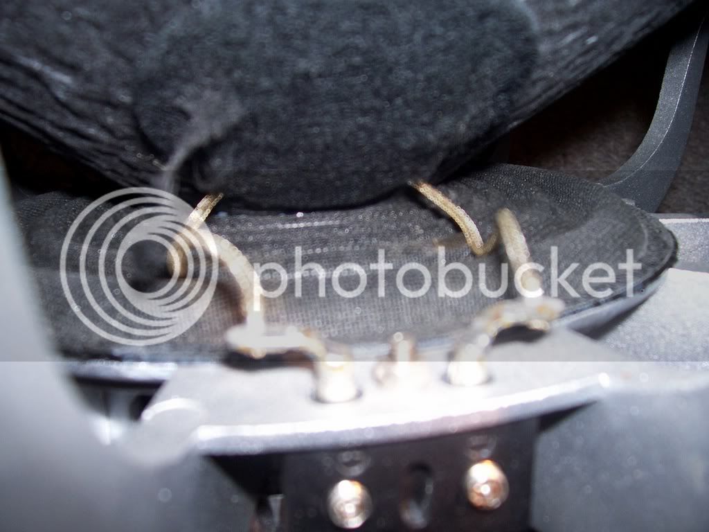

before you glue the center cap in remove the shim. you could free air it after 6 hours but on low power. give it 24 hours or till morning to wang away.
and i think your terminal post are mounted incorrectly. they should be on the bottom part of the basket. like this
