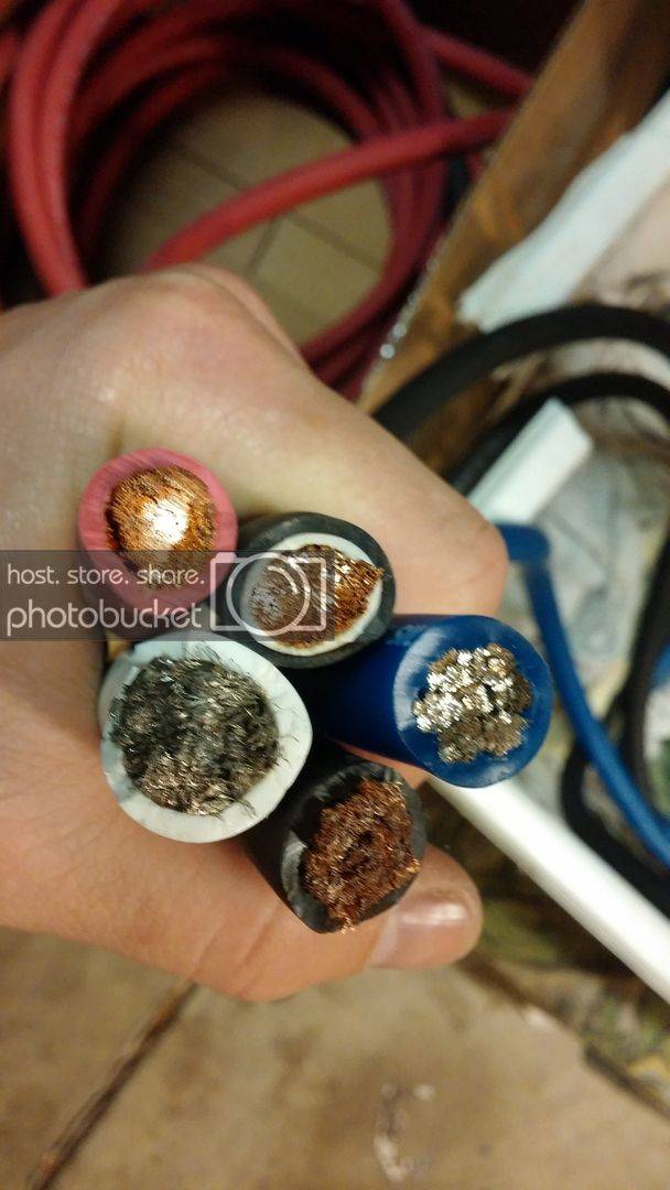

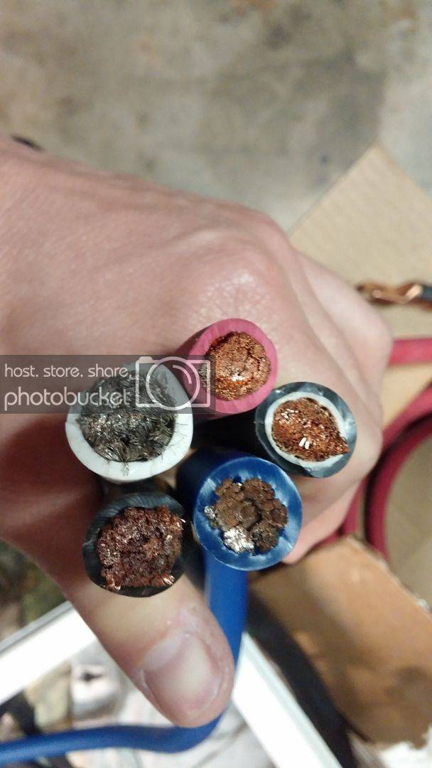

OK my 25ft of EXCELENE 2/0 came in. Looks nice, but for 2/0 its more like 1/0. I fit a 1/0 Ring Terminal on it. It's also not has flexible as my TryStar Cable. I'll have a couple of Pictures up soon.
thats because car audio 1/0 is oversized. welding cable is true to spec thats why we say get 2/0 so it equals 1/0 car audio cable. good stuff nonetheless
This I already knew...
Has you see in the Pictures the Exelene 2/0 is the same size as the TriStar's 1/0 cable.
Red - Excelene Welding 2/0 from E-Bay
Black/White - TriStar Welding 1/0
Blue - NVX 1/0
Black - Mechman 1/0
White - Connerwire Power Wire 2/0 (Freaking Nice, but way expensive @ $30 per ft)

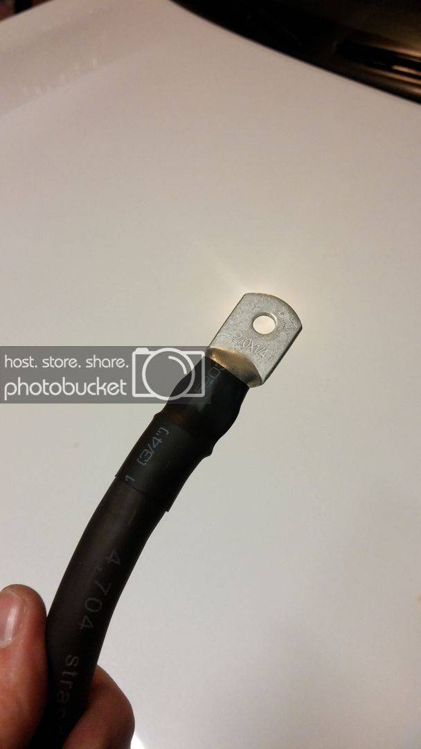

OK had a little time today to redo my grounds. Got rid of the Screw Down terminals in favor for Clamped ones. Used a 16 ton Clamp that made short work of it.

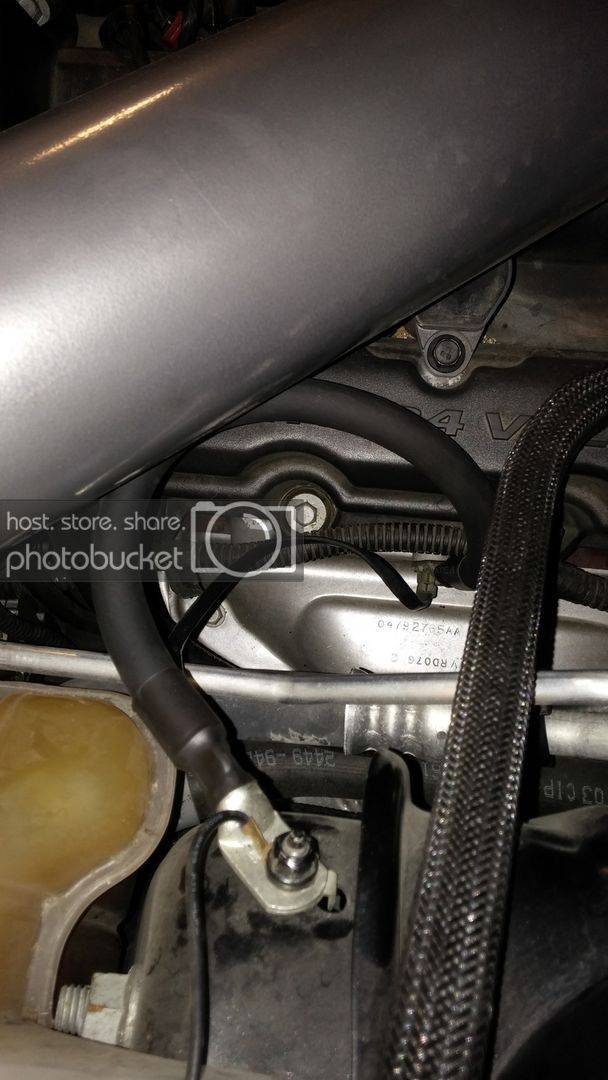

Added a ground to the Drivers side of the engine block. You can see the tiny Factory one just below the new one.

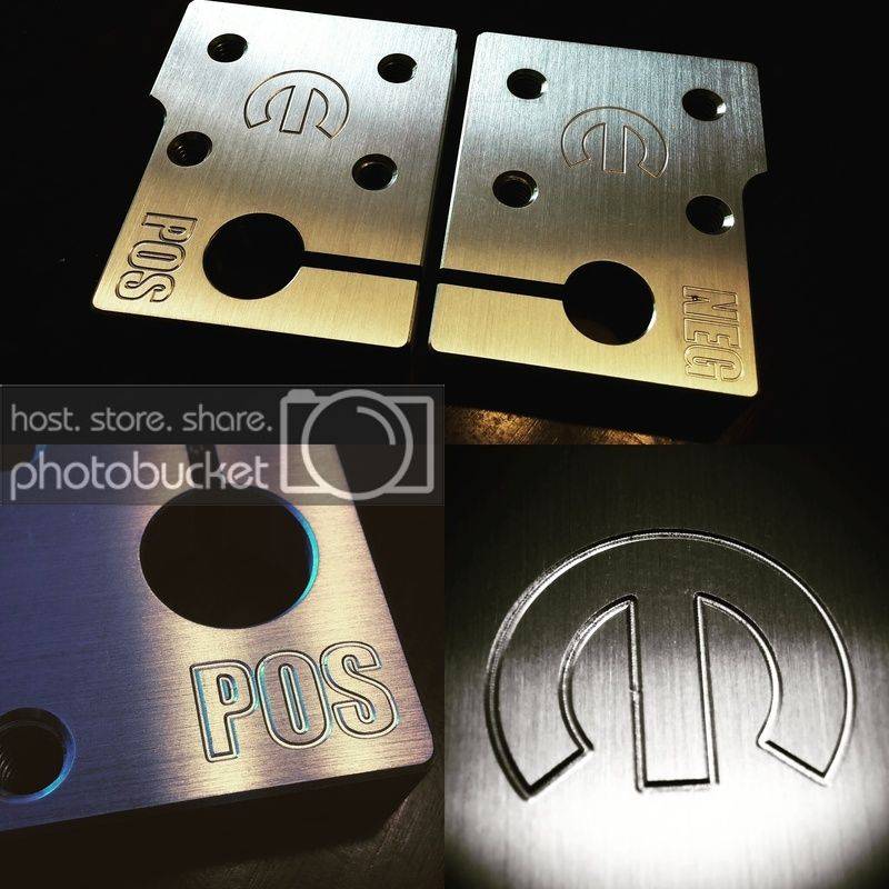

Test fitted the new Toolmaker Terminals. Perfect fit.

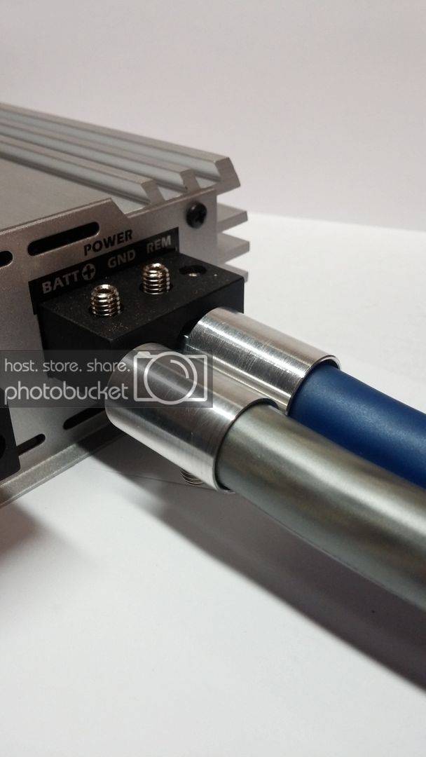

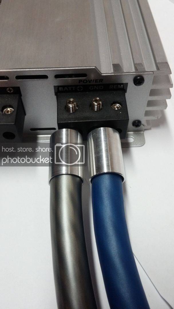

My new Toolmaker reducers came in...
And re-did my Sub wiring. Much better. No one is going to see it anyways, but this much better.

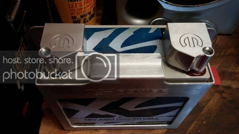

Ok.. One of my final parts came in and I can't be more happy with them. My Odyssey Battery Terminals from ToolMaker... They look sweet.. I was running into issues with space. Unless I rebuilt my battery box and laid my battery on it's side. But with these I shouldn't have any issues. They are compact and low profile.
