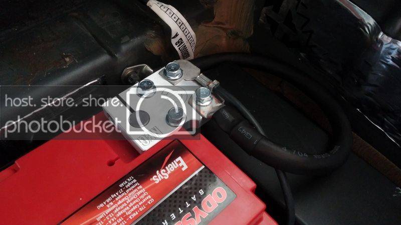

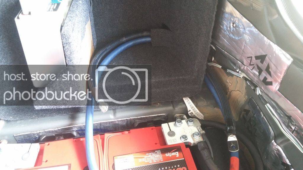

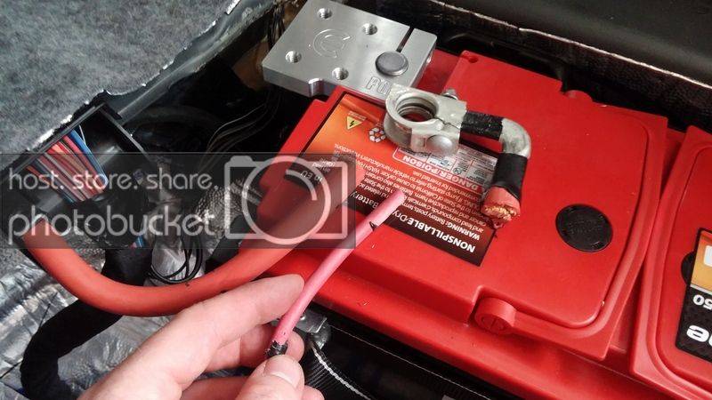

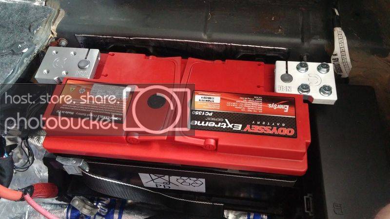

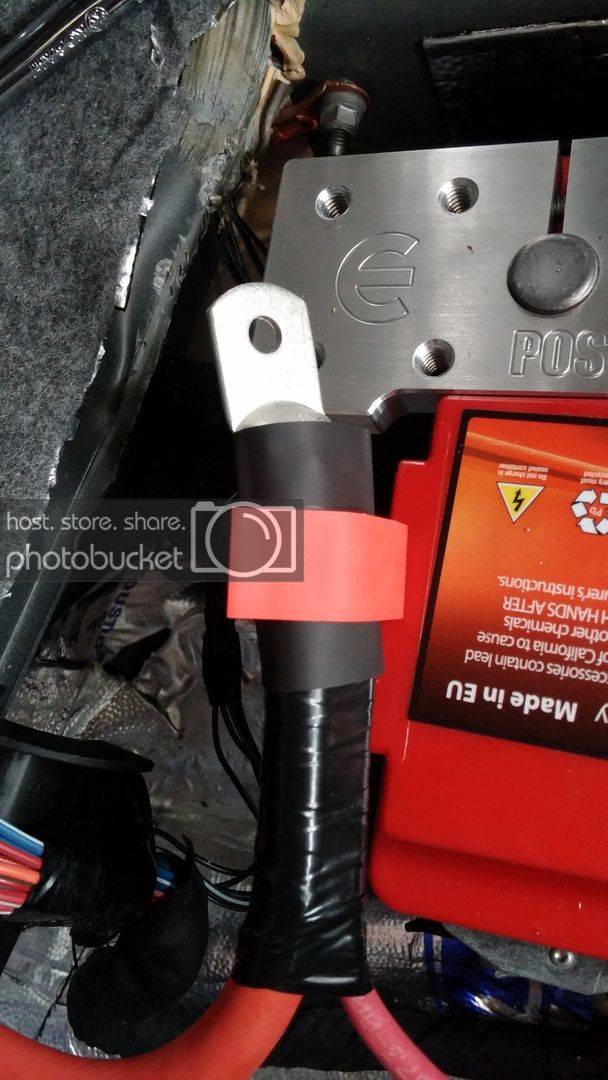

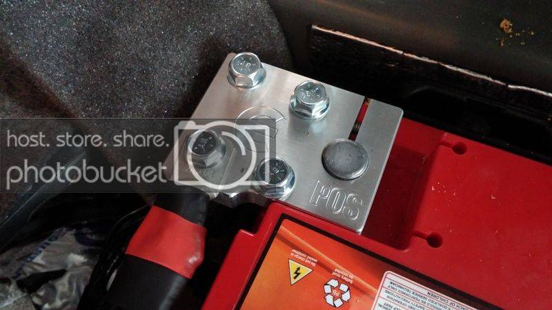

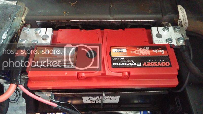

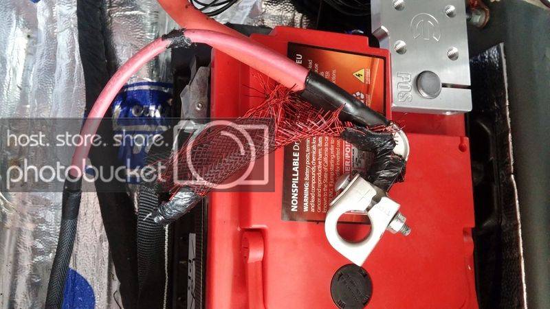

Well I finally got a tiny bit of time to get these installed. Ran into some clearance issues. I had to trim my battery box down on one end to slide the + post farther away from the Trunks Lip. Also had to cut and install a new end on the factory power wire. About half way through got a call from work for OT.. Had to wrap it up. I'll install the 2nd Battery and Mount and Wire the Amp up either Thursday or Friday.
Huge Thanks goes out to Toolmaker for these Terminals. They look sweet and work great. I have room to add my power wire from my Alt. and add to if future upgrades every come up.
Mounted up..
Neg. Side was Super easy..

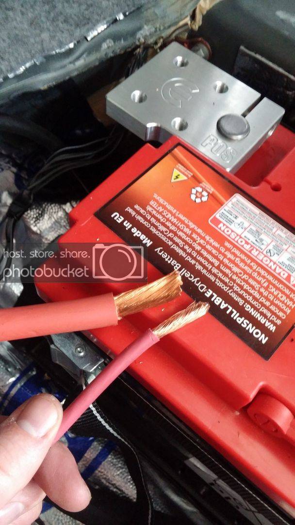

Removed the factory Terminal...No turning back now.
New 2/0 Ring Terminal installed
All Finished up...

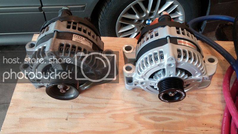

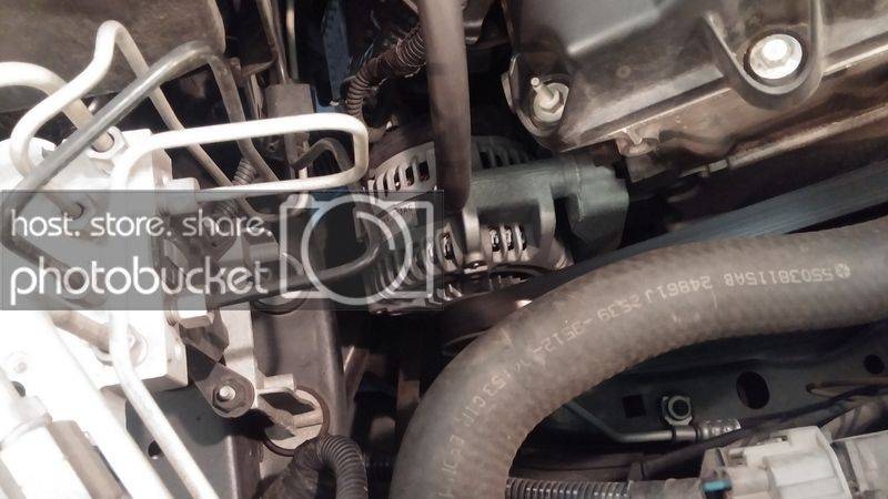

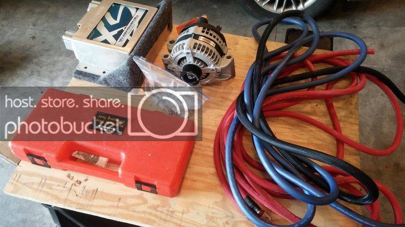

Alt. Pulled, 0/2 Ran, Seats removed... Just have to tidy it up and install the new Alt. from Mechman and the new Shorter Belt.

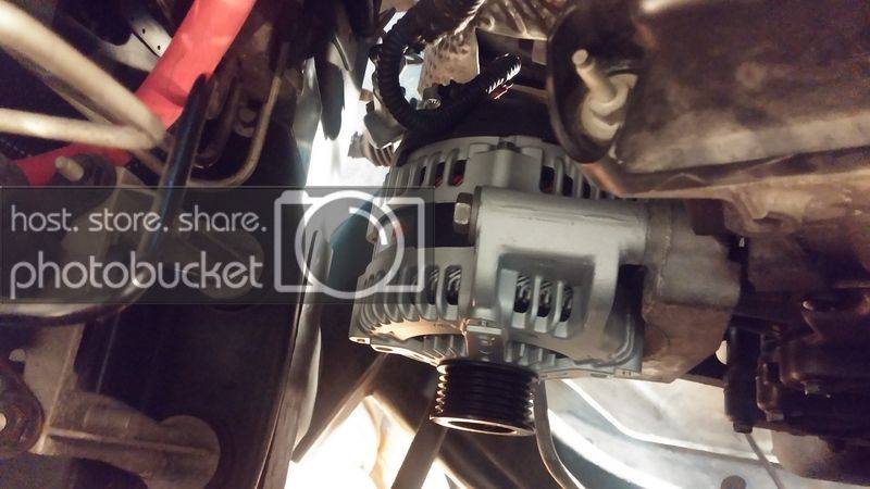

OK Got the Alt. In and Power Wire ran to the back. Just need to install the new Belt and one more Fuse by the Alt.
Stock Alt...Gone
New stuff Going in..
Car jacked up and Ready to Tear down..
New Mechman making the Stock Alt. feel bad..

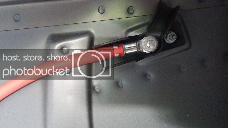

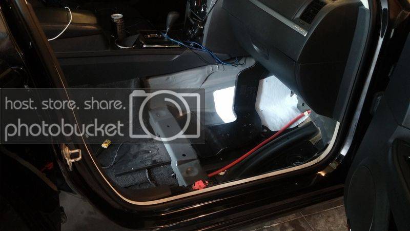

Front and back seat removed. Ran the 0/2 right beside the factory Power
Picture of the factory Power going through the firewall.. From the inside
From the Outside

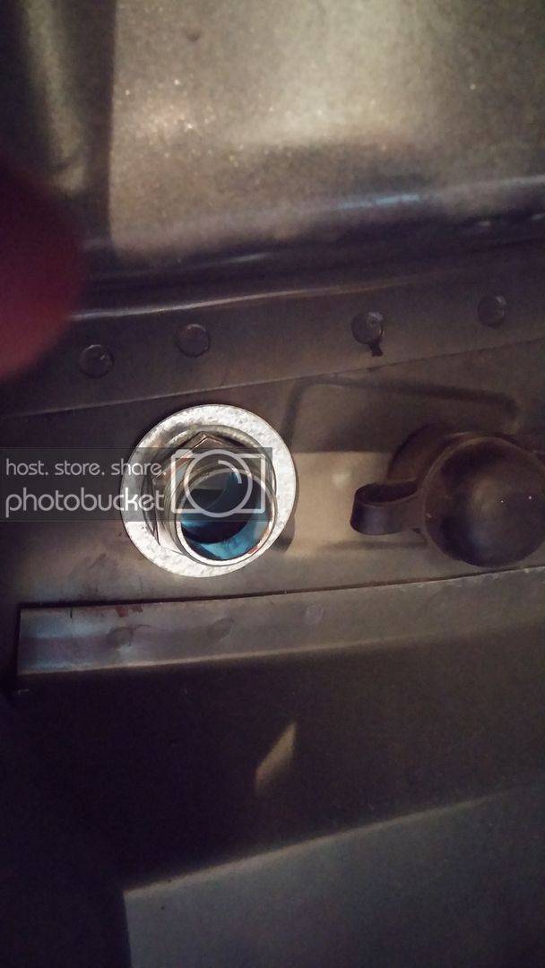

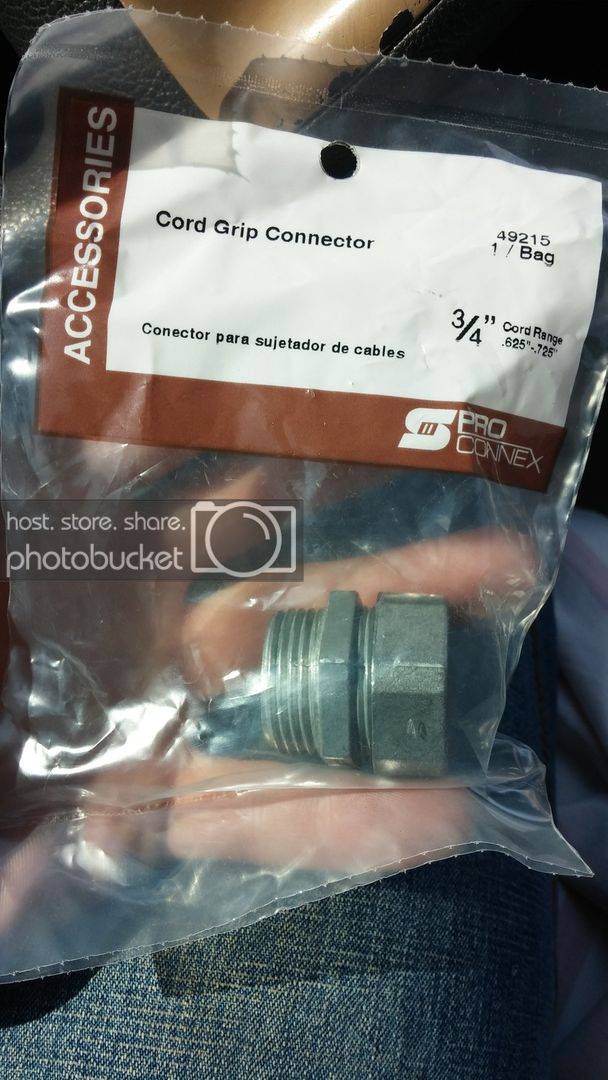

This is what I bought to go through the fire wall. Drilled a 1in Hole and installed this
New Alt. Installed

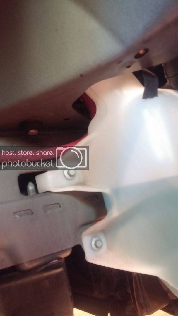

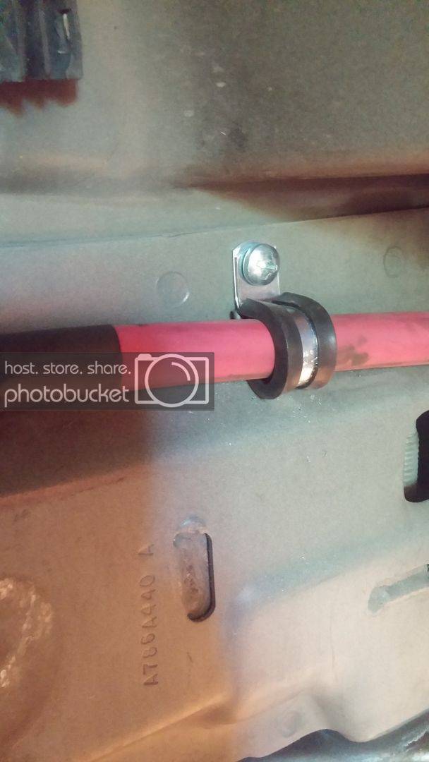

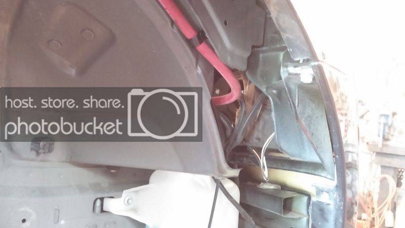

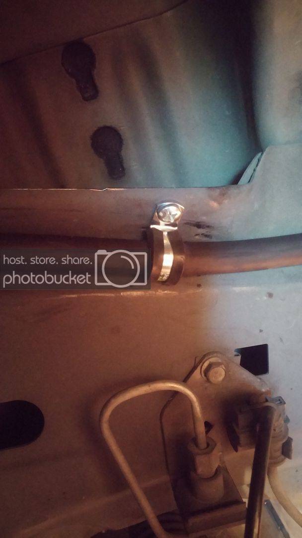

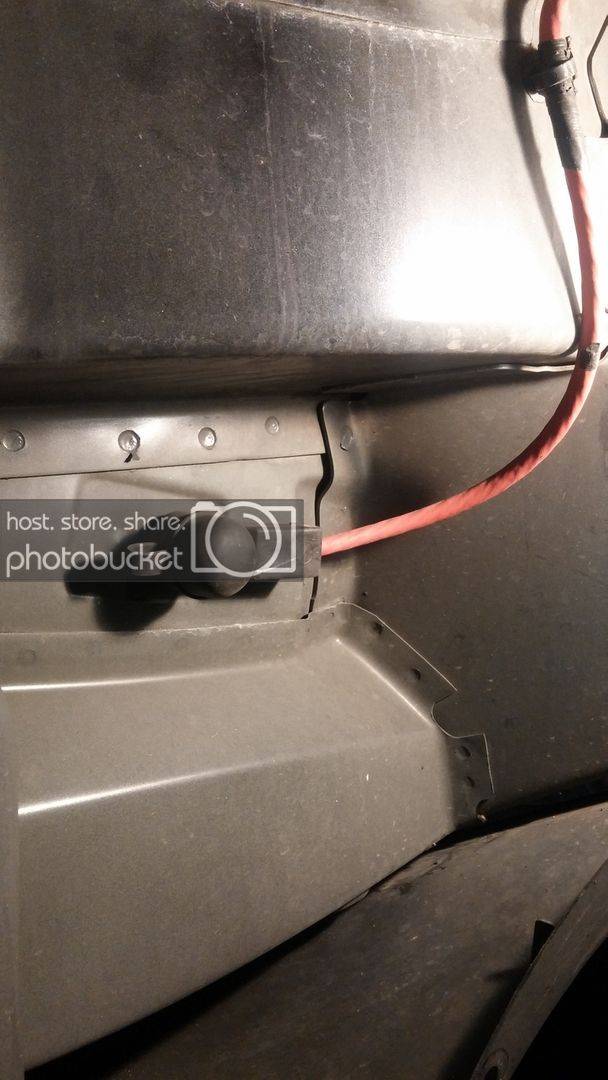

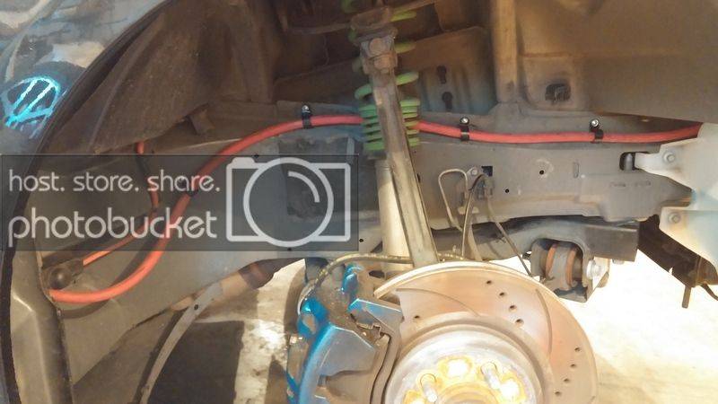

The 0/2 Is ran out by the Washer fluid Tank and behind the Inner Fender well. Once I get the fender well back in. You will only see whats right behind the strut. I'm going to go back to Lowes and look for some stronger Wire holders. The ones I bought are thin cheap plastic.
Redid the mounts for the power wire around the front fender. Found much better mounts. Also added a strip of black shrink wrap around it to hide it better.
Here is where I came through up front. Right around the Washer Fluid Tank.

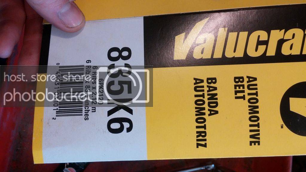

OK got a little more work done last night. I'm able to drive my car again. Which all I needed was to install the new belt. Picked one up from AutoZone for $19.99. Can't bet that.

Here is the 2nd battery being installed.
Here is the Belt I used. Just posting this for who every does this Alt. upgrade on their 2.7 Charger.
