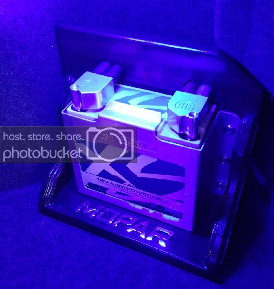

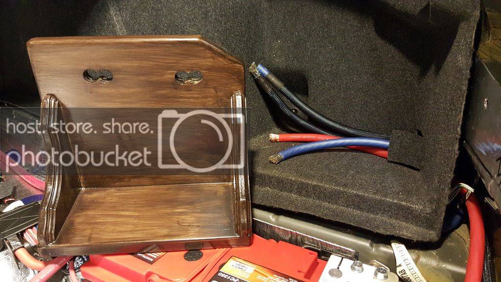

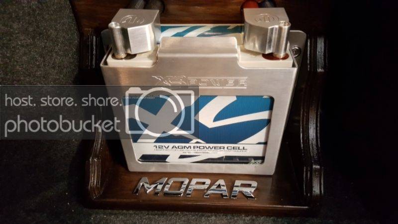

New 2nd Battery mount I just made.. The first just felt and didn't look as good as I hoped..
Thoughts? I'm not to good with wood and never stained anything before, but I'm proud of myself.

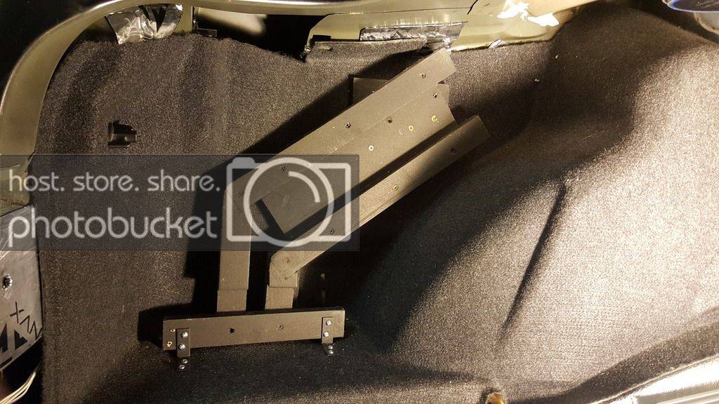

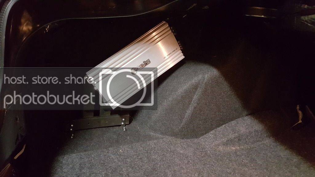

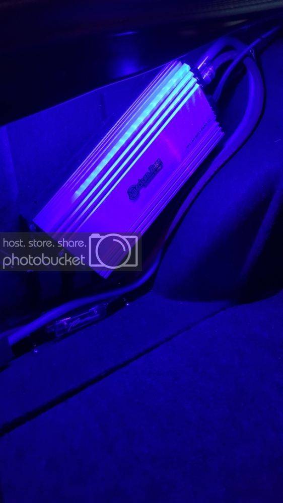

Amp Mount is installed..
Now the Amp mounted up.. I will make a Wall with a Window to hide everything but the amp.

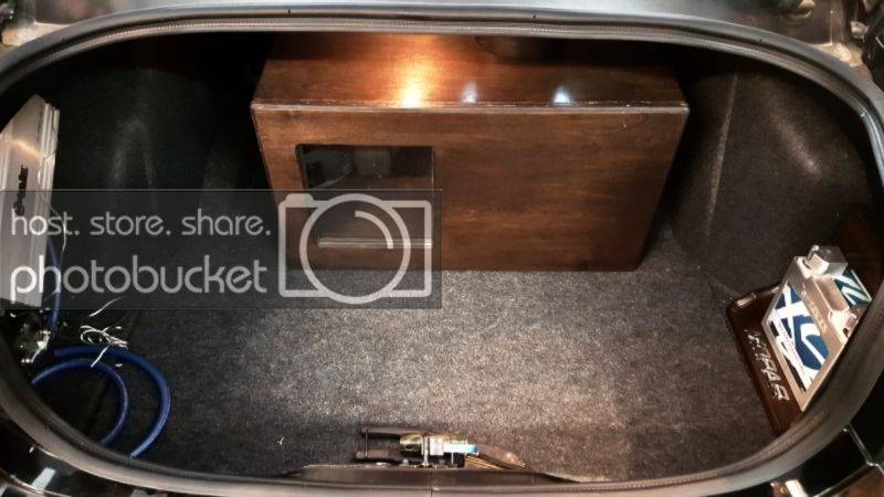

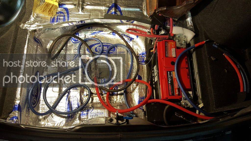

Wire ran for 2nd Battery and Amp
All the wire from the 2nd Battery to the Amp
Ok All Hooked up and Bumping...
Even with everything I have. 2nd Battery, 2x Zero Gauge from 240a Mechman to Main AGM. Big 3 Done with Zero gauge as well.

I do, I ran 00 welding wire on top of the factories 0 from the Alt to Battery with two 250a Fuses in line.

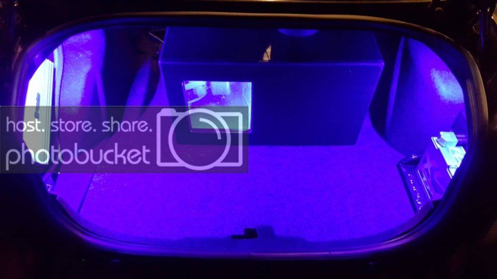

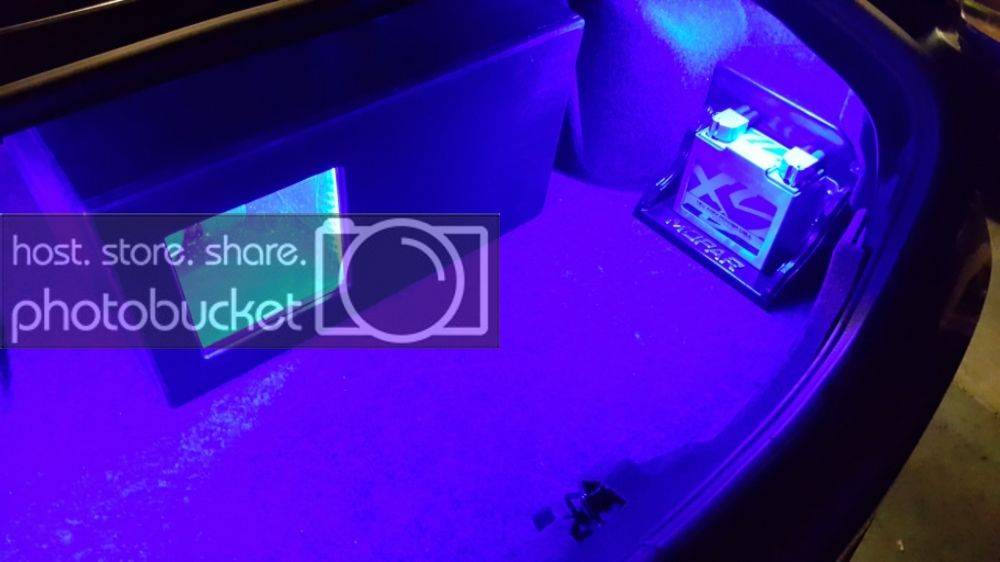

Got all the LED's ran and all that is left in the trunk to do is the false wall over the Amp. I still have access to my Spare tire too.

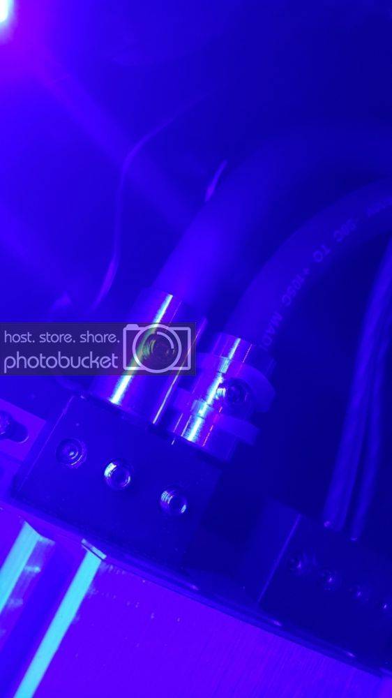

Had to make some O-Rings here to keep them apart. This is one thing American Bass needs to change. The POS/NEG are right by each other. Would be nice of the Remote was in the Middle.
The Amp glows pretty good, can't wait to get it behind a window.

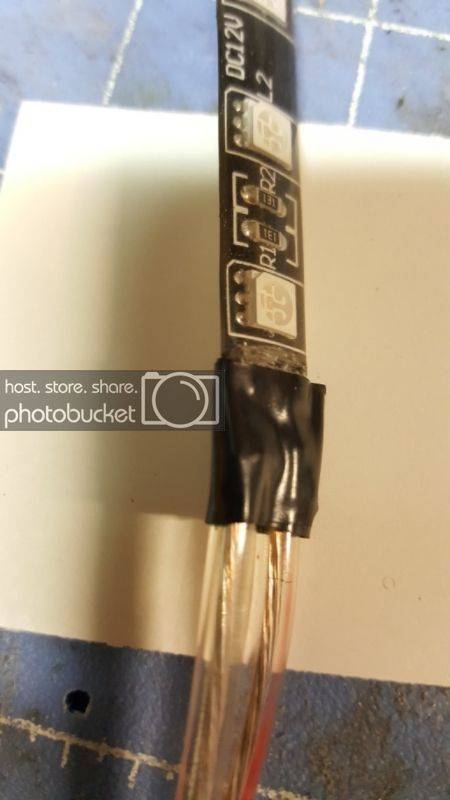

The company who made these LEDs told me they could be cut down but the left over would be wasted and not wired again...WRONG, Simple razor blade and solder worked perfect.
Bad news is I've got to pull my Subwoofer out and clean the Window. The **** Blue LEDs shows everything...I might be able to reach it through the Port. I haven't silicone it in yet.
