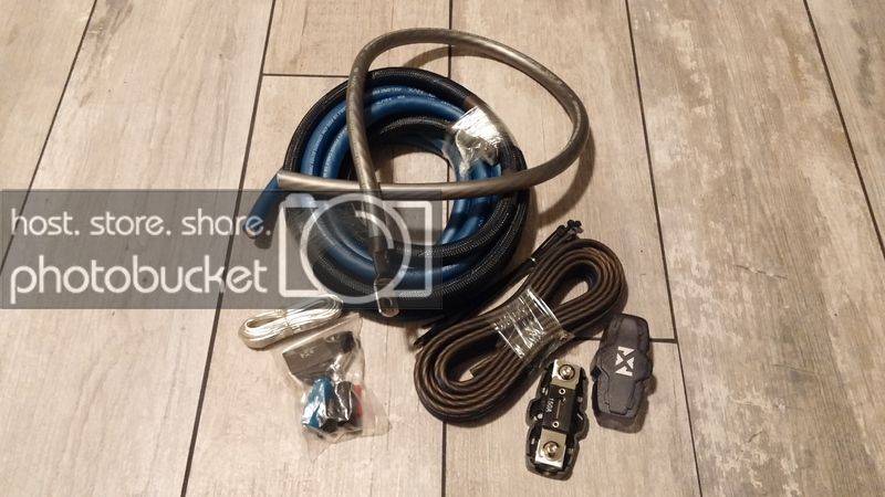

1/0 OFC Amp Kit

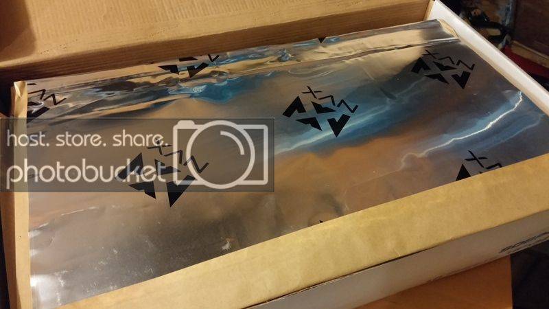

NVX Sound Deadener...40sq Bulk Pack
NVX 1/0 OFC Amp Wire Kit

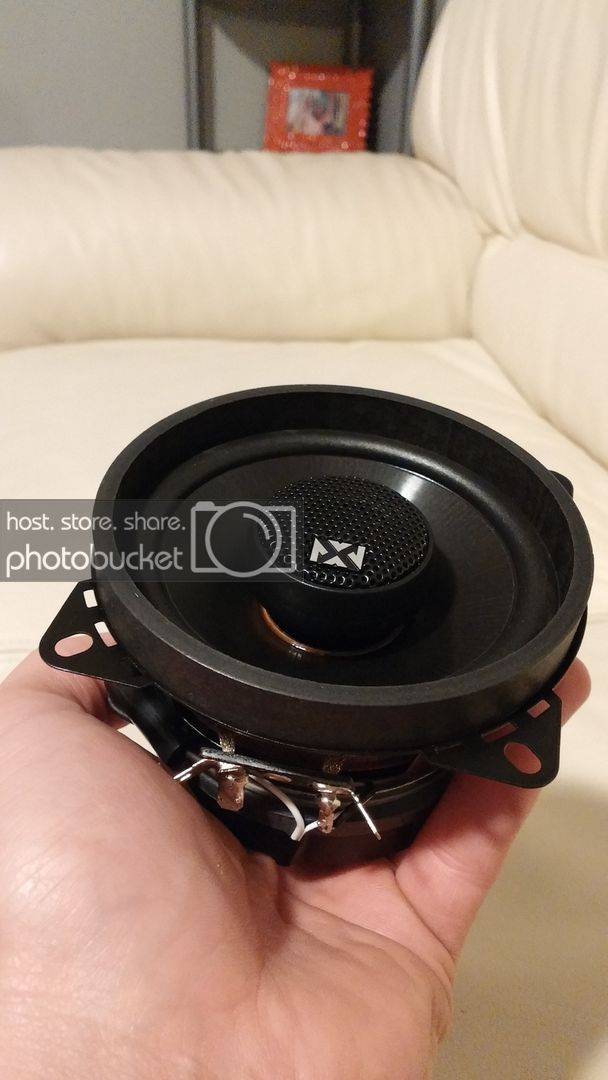

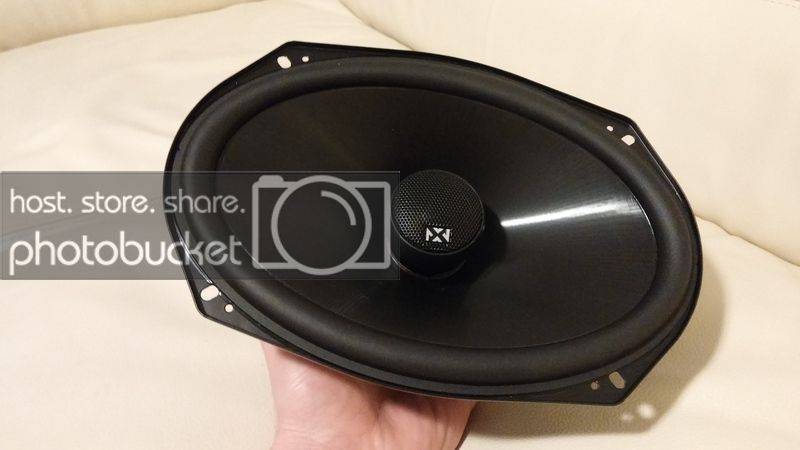

Front4" Dash Speakers... I'll be running these or a set of 3in Mids from Addictive Audio
6x9's Will either be ran in the front doors or Rear Deck. I might run a more powerful set off an Amp for the Doors.

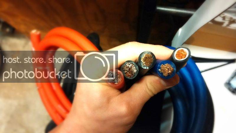

Here is Wire Comparison
From left to right
Mechman 1/0 Power
Mechman 1/0 Ground
NVX 1/0 OFC Ground
NVX 1/0 OFC Power
TryStar 1/0 Welding Wire
All of it is nice wire. The Mechman is CCA. The rest is OFC. Mechman is the most flexible with TryStar the least, but still plenty flexible.

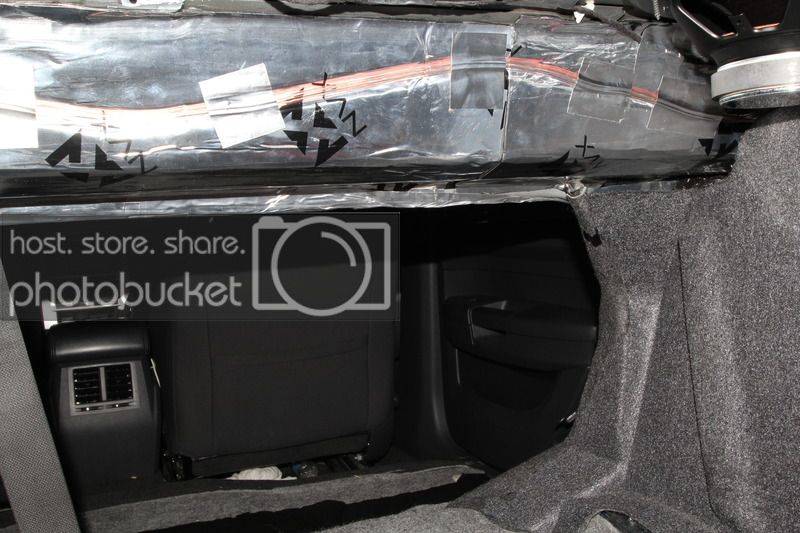

Got some more work done. I'm using NVX Sound Deadener
NVX Sound Damping
On the Trunk Side walls, Deck lid, Trunk lid and Doors.
I'll be using a Combination of Sound Deadener from Thermo-Tec on the Floors of the Trunk and under the Rear Seat. I should have some stuff left over to use on if rattles show up over time..
The stuff from Thermo-Tec I'm using is Thermo Guard FR, Suppressor Acoustical & Heat Control Mat and Seem Tape
Thermo-Tec : Products : Sound and Heat Barriers

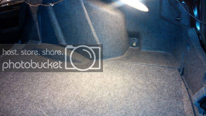

I got the Sides of the Trunk done and part of the rear deck. I also used some silicone in the hard to reach cracks.

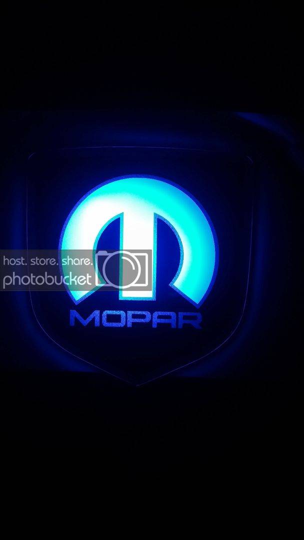

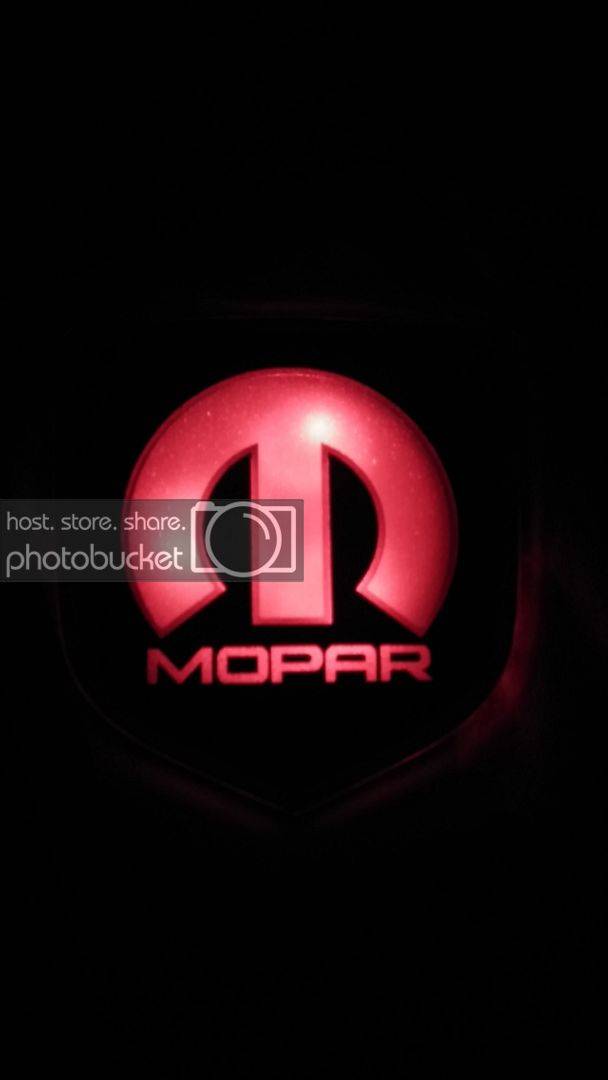

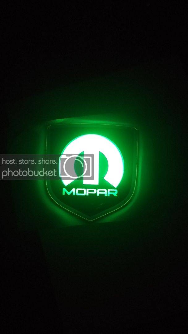

The Front Badge can be back lite with an LED.. Looks Blue with the Light off, but I can change the color to what ever I like with an LED..

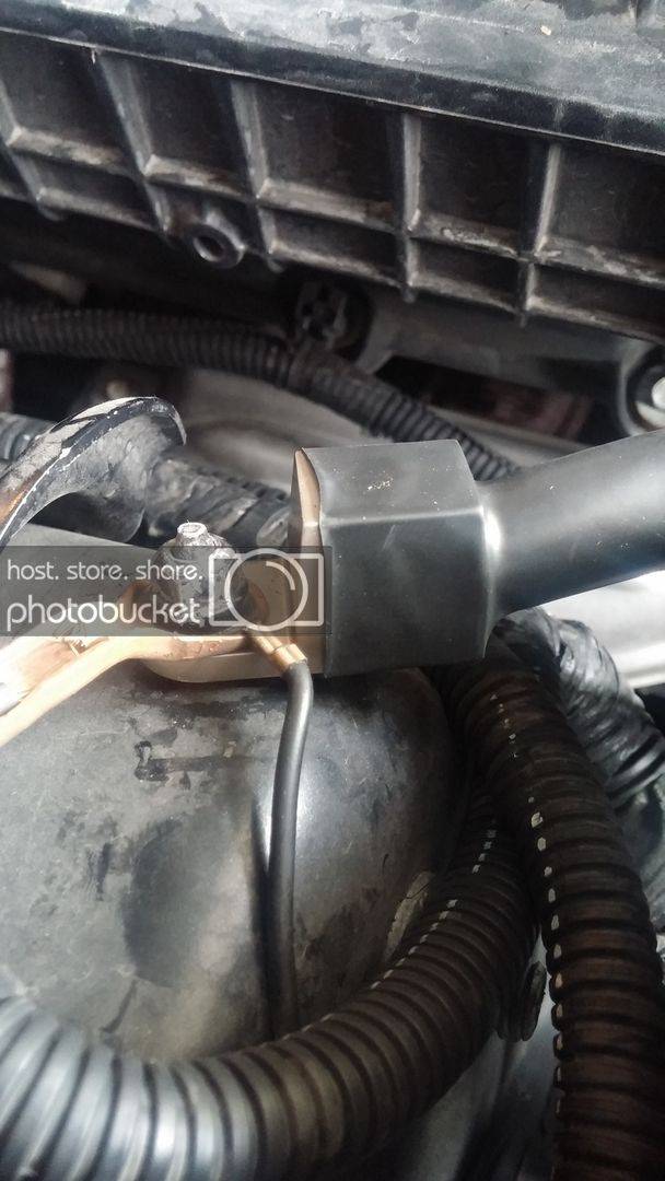

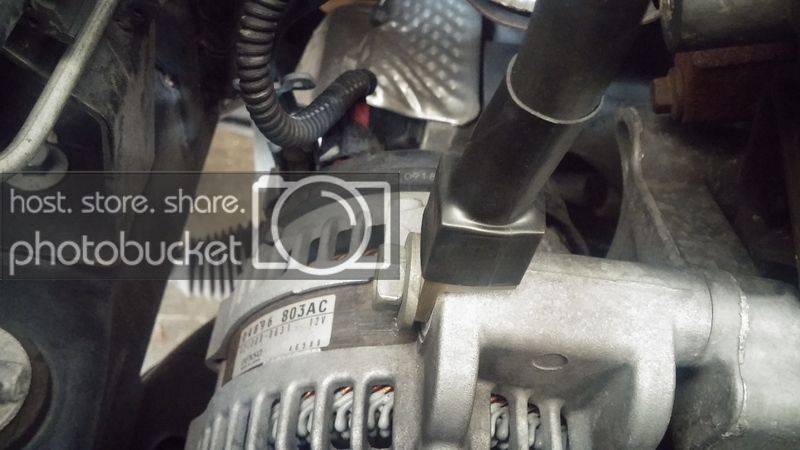

I installed the grounds from my Mechman Alternator BIG 3 Kit. I'll install the Power wire when I get a chance to install the Alternator.

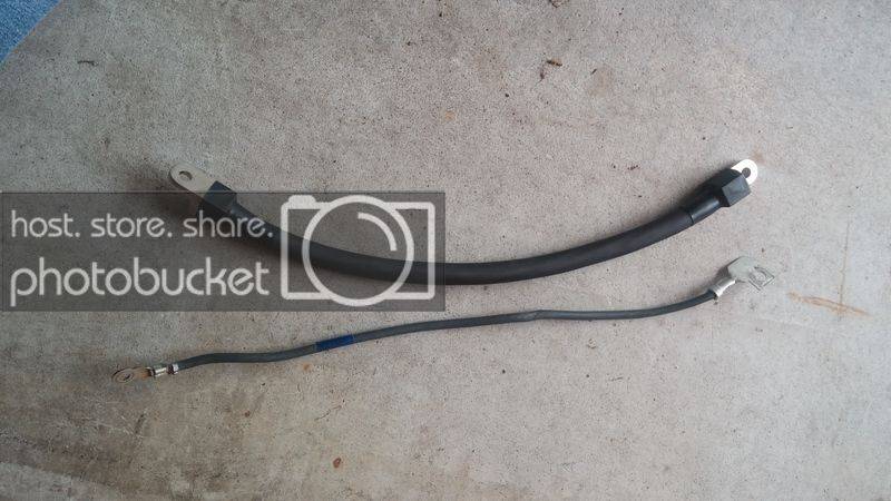

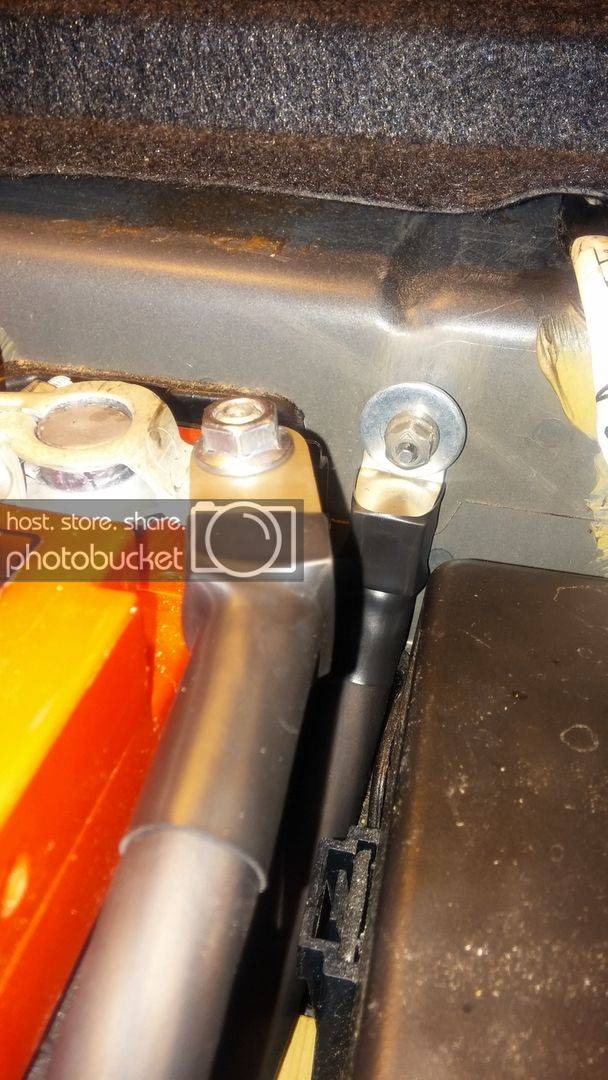

Upgraded Battery Ground from a Stock 8g (?) to 1/0
Added a Ground for the alternator..

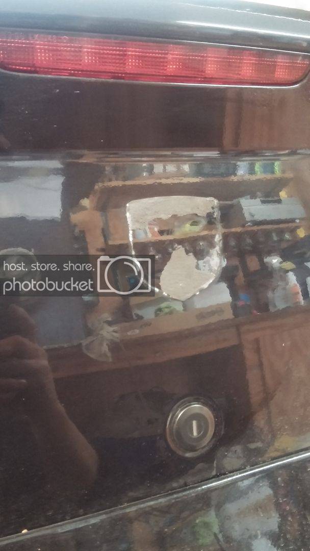

Removed my Rear trunk Emblem...

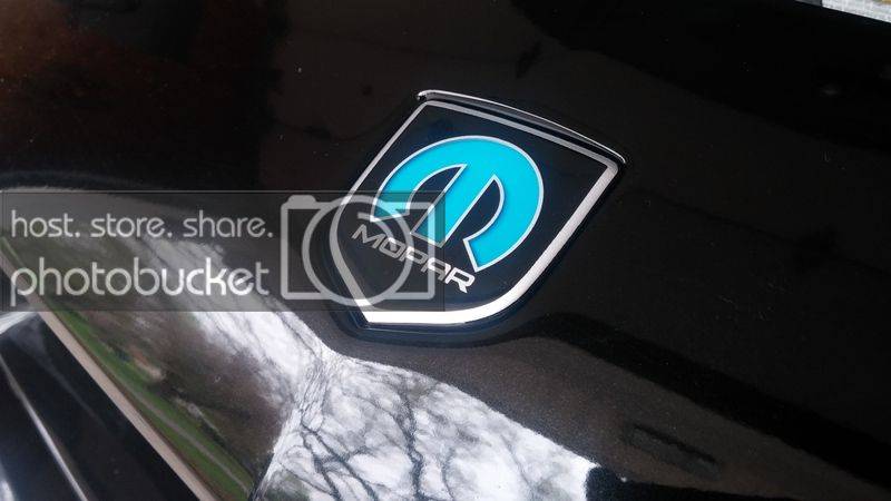

Test fitted my Front Emblem.. Can't install it till I get my LEDs ordered for it. Fits pretty good. Will have to double up the Thickness of the Double sided tape to make it sit level.

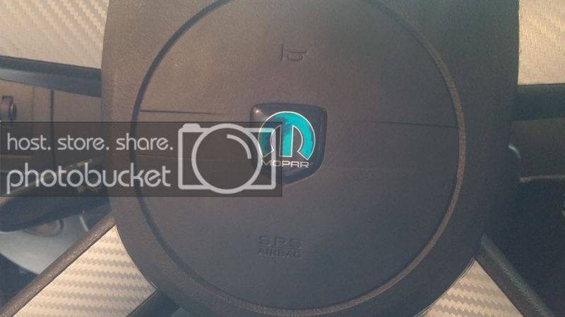

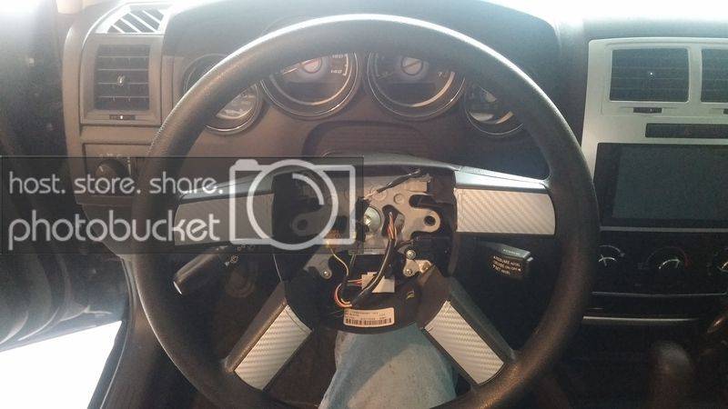

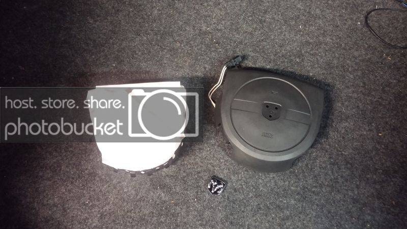

Went ahead and installed the Steering Wheel Emblem too. Not to hard. Trickiest part is getting the cover to un-clip off the Air Bag Case.
You didnt remove wire did you? Your not supposed to. keep the stock wire along with the upgraded. But nice overall man really doing some work here! //content.invisioncic.com/y282845/emoticons/thumbsup.gif.3287b36ca96645a13a43aff531f37f02.gif
I removed the Battery Ground Wire. It's a pathetic sized wire. The Alternator I added.. Whats the benefit of keeping the Stock ground? I can put it back I think... It's a very tight spot and even tighter now with the 1/0 in the way now.
i also removed that tiny azz ground wire from battery to ground as well. that thing is pathetic. makes no sense dodge gave us zero gauge wire from alt to battery but then gave that dinky 16 gauge wire from battery to ground. ne ways. man is that amp SMALL. jesus i did not expect it to be that tiny, ive heard it was small but that is ridiculously small. hope it puts out what you expect.

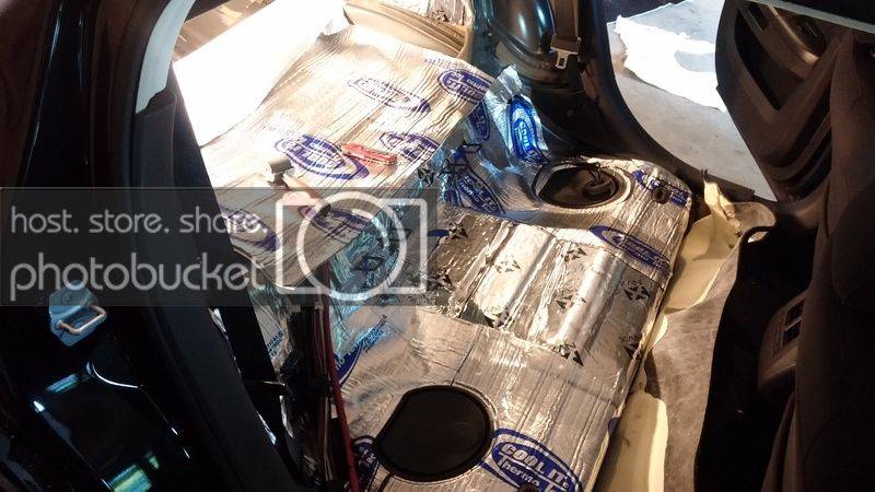

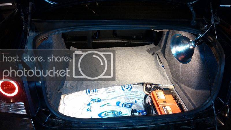

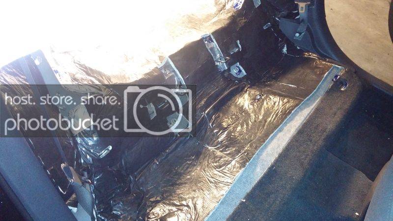

I added the Factory ground back.. No big deal. Got a lot done tonight. A lot of deadener and sound barrier laid. Got the Trunk and under the rear seat done. was really aiming to cut down on a little drone. It did, but not as much as I would have liked. Maybe I'll notice a bit more as I drive over the next few weeks.

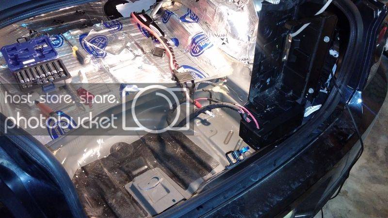

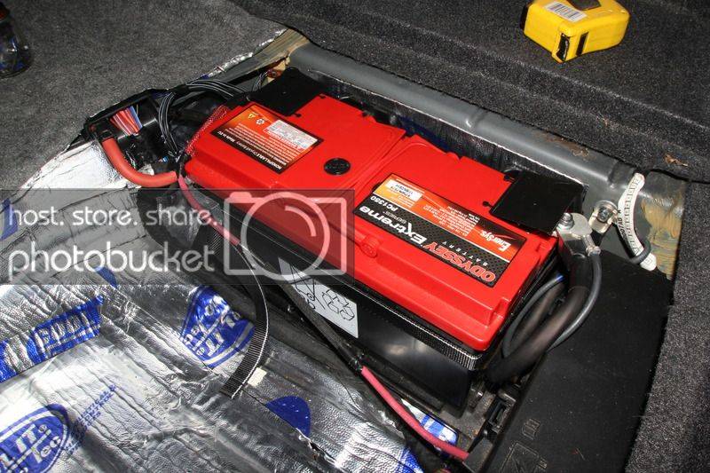

I'm ready to mount the Amp and 2nd Battery Now. Just waiting on my reducers and Terminals from ToolMaker. Then I can run all my wire. Going to install my Alternator next Wednesday or Thursday.

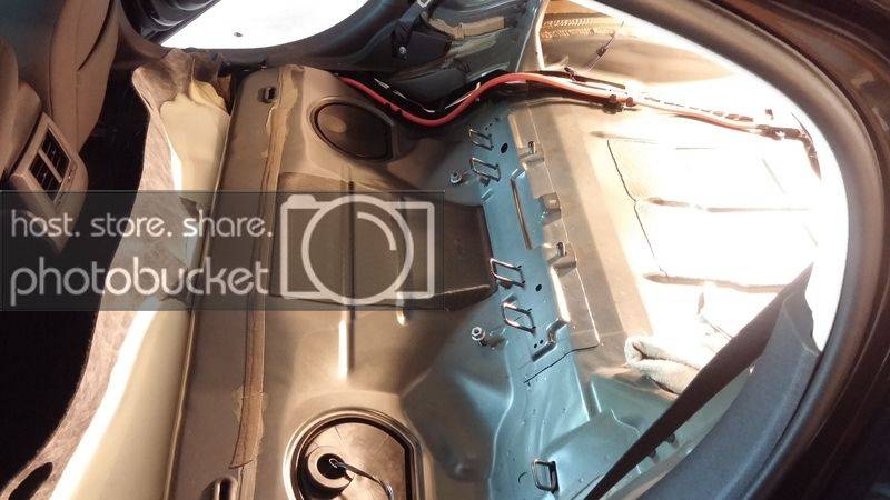

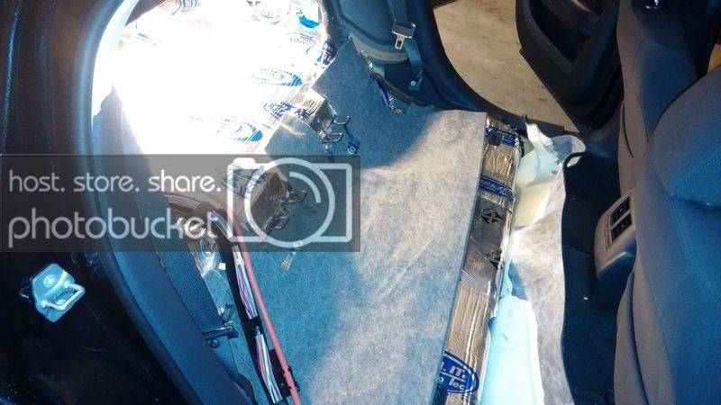

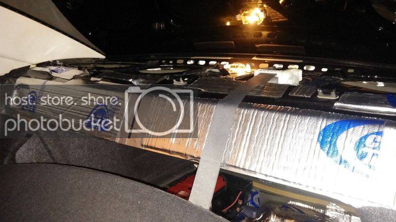

Laid a layer of Thermo-Tec Thermo Guard under the Back Seat and back into the Trunk Area.
Then laid the factory Insulation back down on top of that.
Everything is back in now..

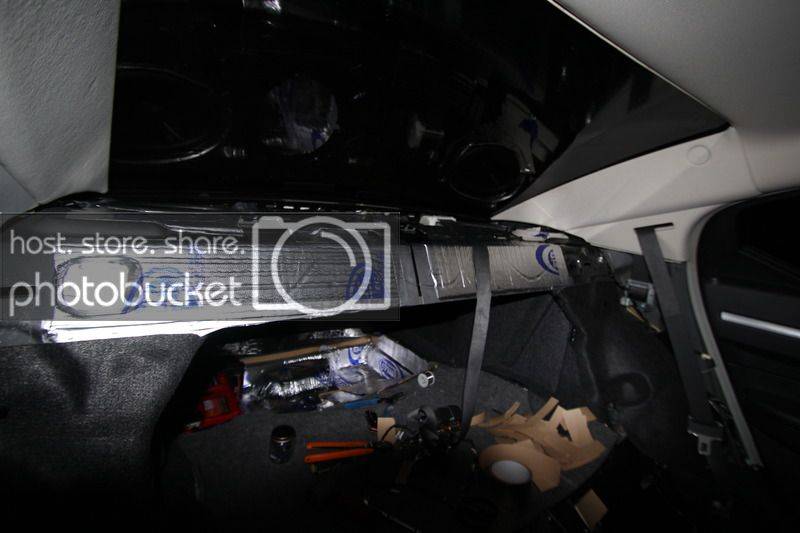

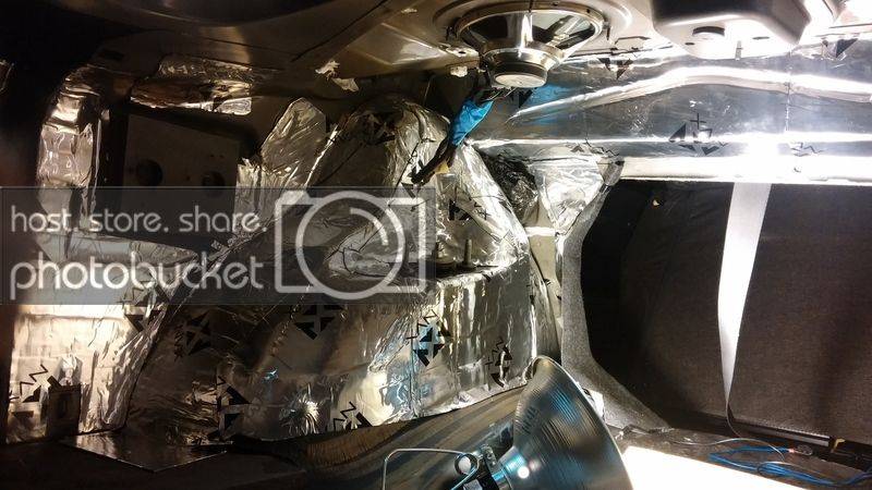

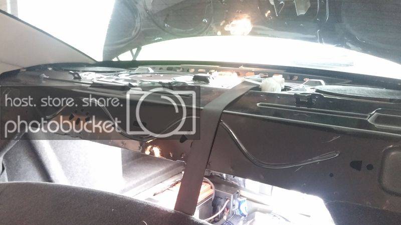

Deaden the Rear Deck
Before and After

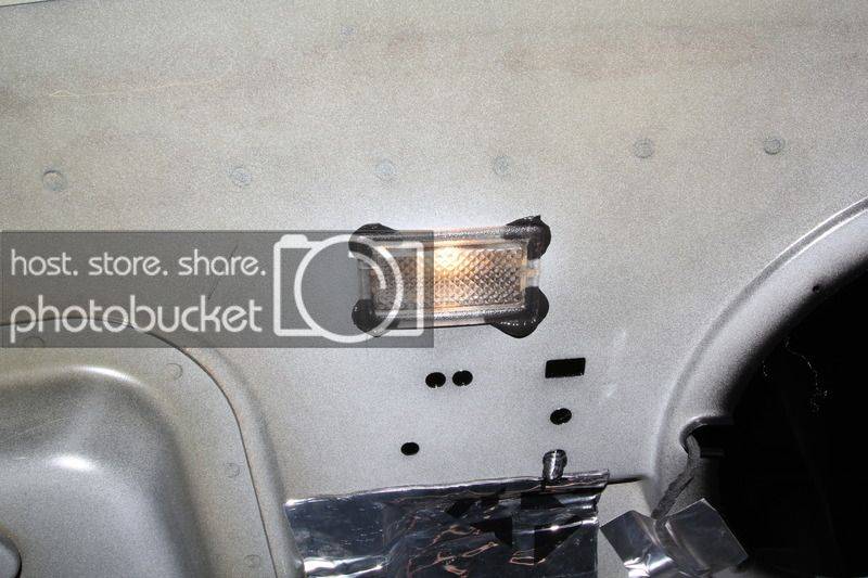

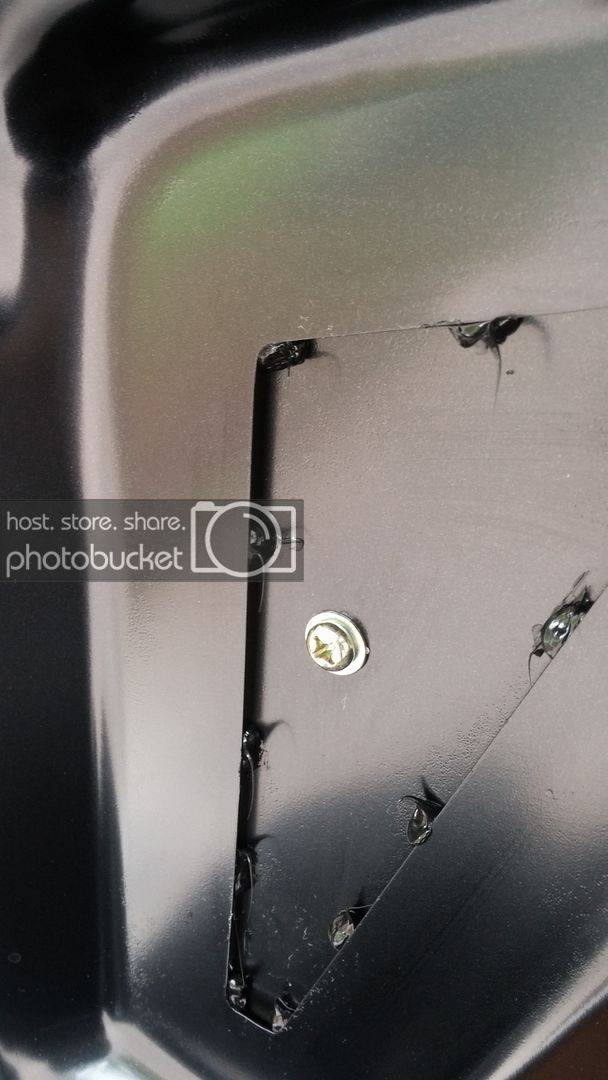

RTV Siliconed the Rear Trunk light.. Just by putting tiny dabs at the four corners.
RTV Siliconed The Wire Plugs that attach the wires to the rear deck.

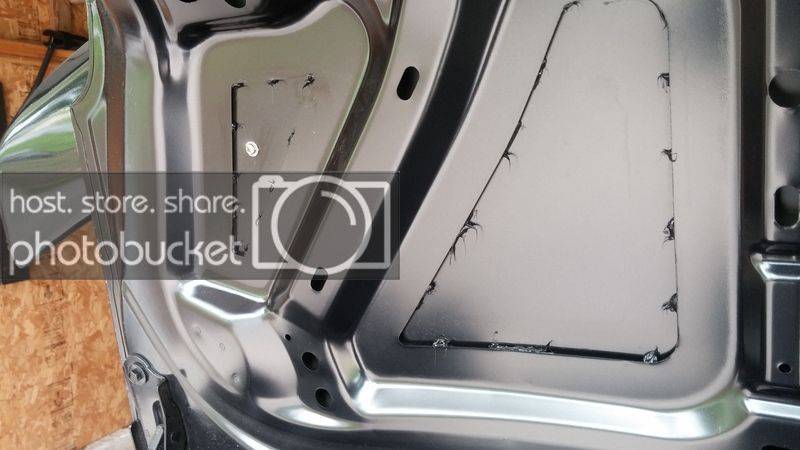

Also put little Dabs on the Trunk deck Lid with RTV Silicone... I may add some Deadener later, but wanted to try this first..

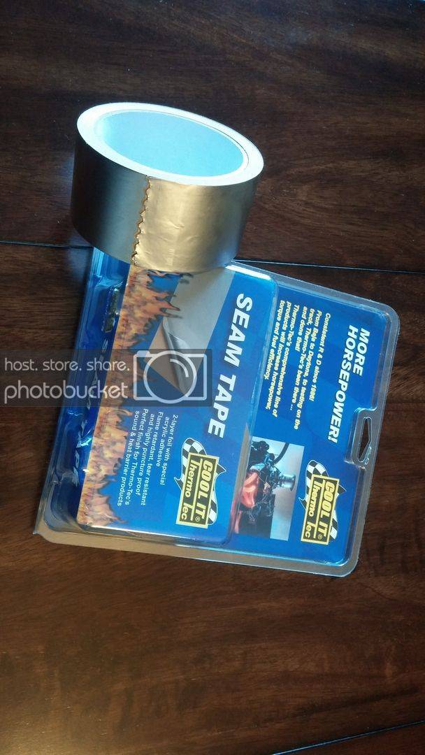

My Seem tape came in from Thermo-Tec.. Went back over some of my Seems with it. Will use some of it on my front Doors.

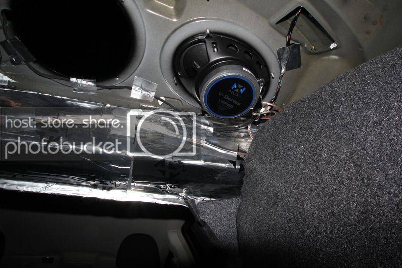

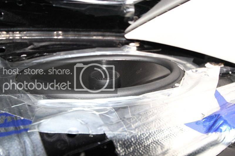

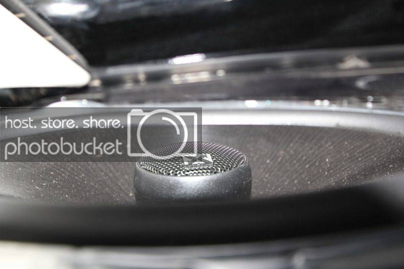

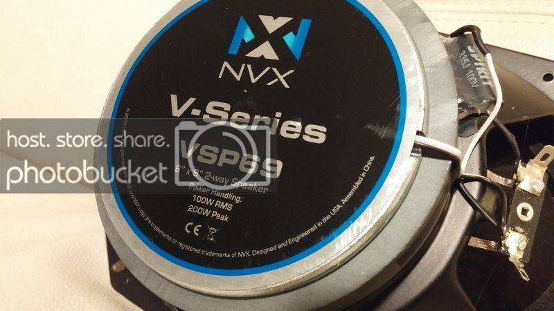

Going back out now to put my rear NVX 6x9's in and seal them up...

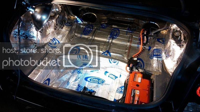

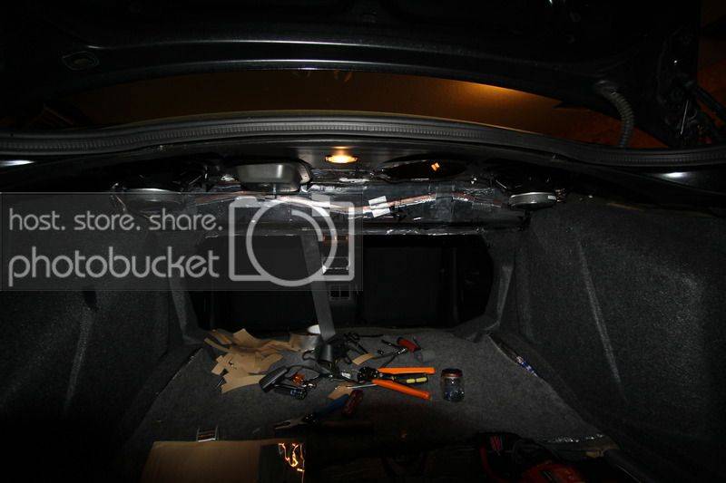

Ok some Pictures...Stayed up till 5am working on it.
VSP69 6" X 9" V-Series Coaxial Car Audio Speakers
Fixed the Trunk light from ever rattling..
The New Trunk Speaker wire running across the back instead of just hanging like Dodge had it.
Better Picture of the Odyssey PC1350 And Mechman's BIG 3 battery Ground

All Finished and starting to clean up..
