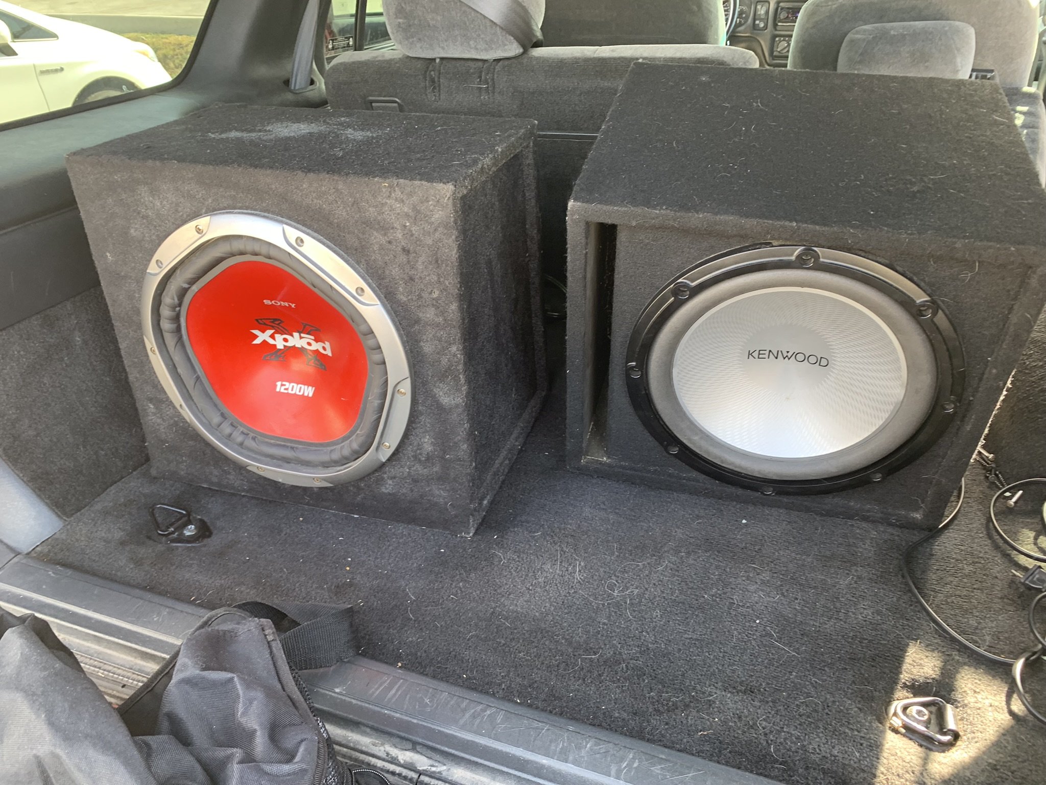

Ive ran it in both boxes. The box on the left just sounded really sloppy and like it was flexing the sub a little too hard. I have it in my rear bed space pointed towards the hatch. What’s really strange is I checked my old amp (Sony XM4060GTX 600Watt) to find it was only running 150 Watts RMS Bridged to my Sony Xplod XS-L120P5W (350 Watts RMS) and was at least 30-40% louder than my current setup. I’m just a little confused as to why my current Kenwood setup isn’t nearly as loud as the old poorly matched Sony setup I had previously.
Just to be clear, the Sony subwoofer is blown leaving me with both boxes, my Kenwood sub and amp. Probably due to running it pretty hard off of an amp that was only 150 Watts RMS when the sub is rated at 350 Watts RMS.
Subwoofers have a certain range in box size they want to be in. Measured in cubic feet (usually). Look up the specs on your Kenwood sub and see what size box it needs. Ported box specs and sealed box specs.
In the pic you posted above; 1 box has a port and the other one doesn't. Is that correct?
Make sure the box is right first.
Sending it clean power (gain setting, power wire and ground location) is second.
crossover settings (low pass, high pass) third
That's how I would generally approach this if it were me.
