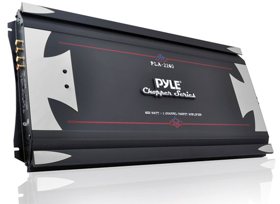

That sub is very underrated, get this 4000 watt amplifier
http://www.pyleaudio.com/itemdetail.asp?brand=&cat1=Car%20Audio&cat2=Amplifiers&model=PLA2260
