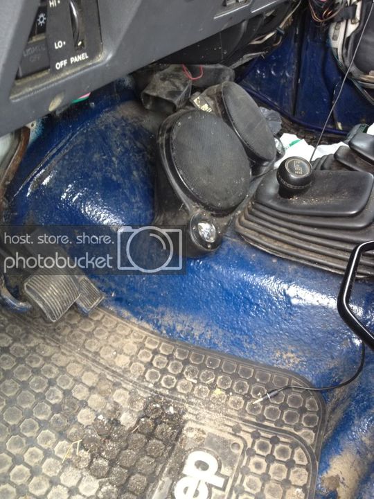

Ok so since I have nothing but time and already have a photobucket lol.. Here we go... An before I get any wtf you got it all jammed in there it's because I was taking it there to show the guy what I have remember.... The only thin hooked up is that 12w7 to the hd1200

Hope those pics help... My main question is, is the custom enclosure from them going to make that much of difference? He says huuuuge difference

I don't know about that. People tend to talk up their own skills to make a sale like that. Have you seen any of the boxes he's built?
Trumpet if it was your jeep.. Going off what I have. What would you do/add to finish it off... The reason I got ye 12w7 in the h.o. Box is because of how well it fit between the wheel wells.. Deck/ speakers?
I don't know, man, a Jeep is so far from the kind of vehicle I would buy. It would have to be strictly "just for fun", so the idea of carrying groceries in it wouldn't even matter. I'd probably try to optimize the sound bar and put better speakers in there, and do sound deadening to make sure it doesn't rattle. I probably would not fuss too much trying to get the speakers sounding great because of the nature of that vehicle, as it's very noisy and open. I'd probably use those Infinity 4" plate speakers and try to seal off the rear of the speaker from the front, possibly using a heavy sound damping product. That would have to be figured out as I had the dash apart. I'm not sure if I would use the center console speaker pods.
I'd use a head unit without a CD player and use Bluetooth to stream music from my phone. It appears to be discontinued, but the Clarion FZ502 would be on my list.
The 12W7HO box could probably get bolted to the floor. It does look like it fits well. I wouldn't add the 8s. The only reason I'd consider changing to a sealed box is if that HO box doesn't play high enough to mate with the speakers. Midbass is going to be a big problem.

I used it in jeep on other amp.. I have no carpet, it is as the picture shows:) rhinoed blue an clear coated... Should I dynamat the whole inside of my jeep? And for my gain settIng am I understanding right 12w7 1000w at 3 ohm so target voltage is 54.7.. That with the gain/input sensitivity ??? What is the filter freq. (hz) knob and how do I know what it's supposed to be at?? And what setting do I set my dmm on? I feel like a child
