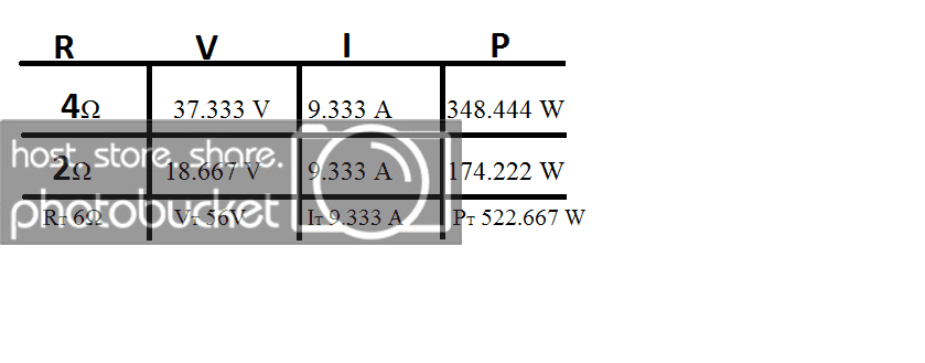

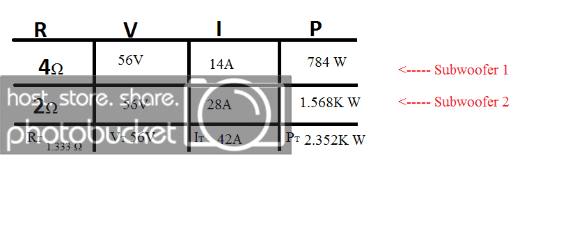

J Jskiles 10+ year member Junior Member 13 0 West Virginia Mar 25, 2013 #5 The reason you can't wire different ohm subwoofers is because the will recieve different amounts of power. If these subwoofers are in the box there will be some cancellation issues and other things. These pictures are just to give you an idea
