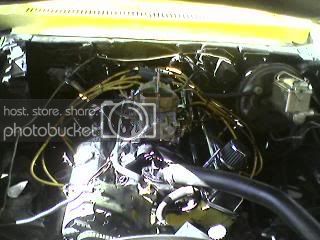

it has a problem starting when it hasnt been started but once i get it started its ok it will start right back up after a couple mins but when i turn it off fuel will trickel down into the carb i can hear it when the air cleaner is off idk whats wrong with it weather it needz a rebuild or what i was also thinking maybe my fuel pump on my engine is meesing up as its old maybe thats why my car will go to dye is it not getting fuel to it?
i put the fan shroud back on because when it starts to get at like 180-190 it starts to shut off when i stop.
put the fan shroud on and cleaned the wires up a little put some extra wire clamps on em so it looks a little better

well i sold the carb waaaaaaay to big for my engine it was flooding my engine out so i put the smaller one on and with the money imna paint my rims either stright black or black and yellow any sudgestions?
