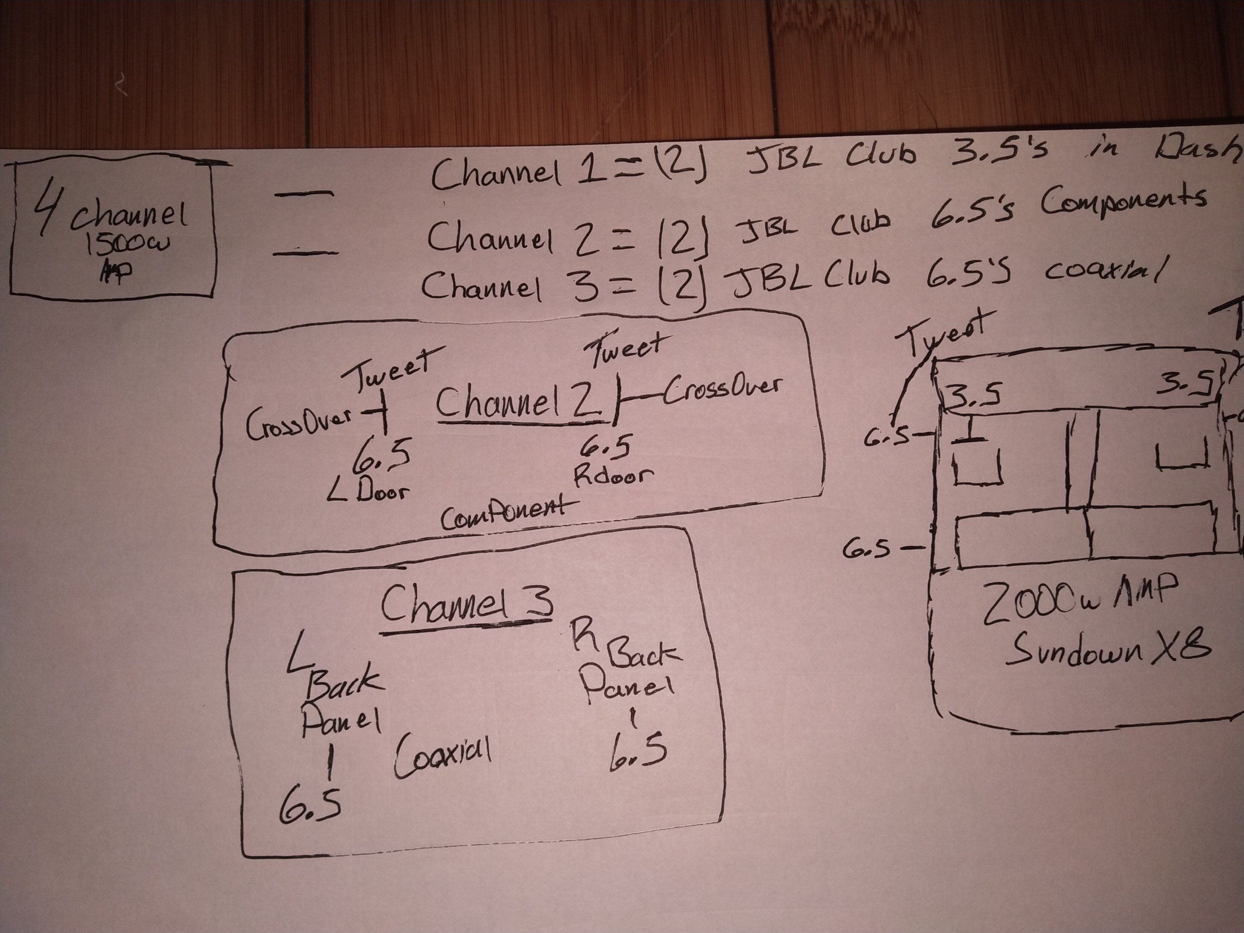

I quickly drew up an idea... Does this make sense? I drew a really rough diagram of my
I'd put nothing in the rear or on the dash, throw the money saved into the Stadium GTO600c for your doors and put proper care into sealing/deadening the doors. Use a 2 channel amp on those with the passive crossovers included.
2000W is way too much power for a single 8" woofer so you could probably go smaller on the amp unless you have plans to add more/bigger subs down the road.
Alternately if you simplified into just the one set of components and single sub you could probably do it all with a nice 5 channel amp (the DD D5.1500 comes to mind) and have options to run active crossover or just bridge channels 1-4 for more headroom.
Seems you're pretty dead set on just filling every factory hole though so give it a whirl and see if you like it, but I can assure you, you won't be lacking output with a strong set of 6.5" components up front on 125W or so.
The Kappa's have a high sensitivity rating of 93 db so the X802-5 would be fine. A good high sensitivity 8" sub in a properly sized box would fit...
