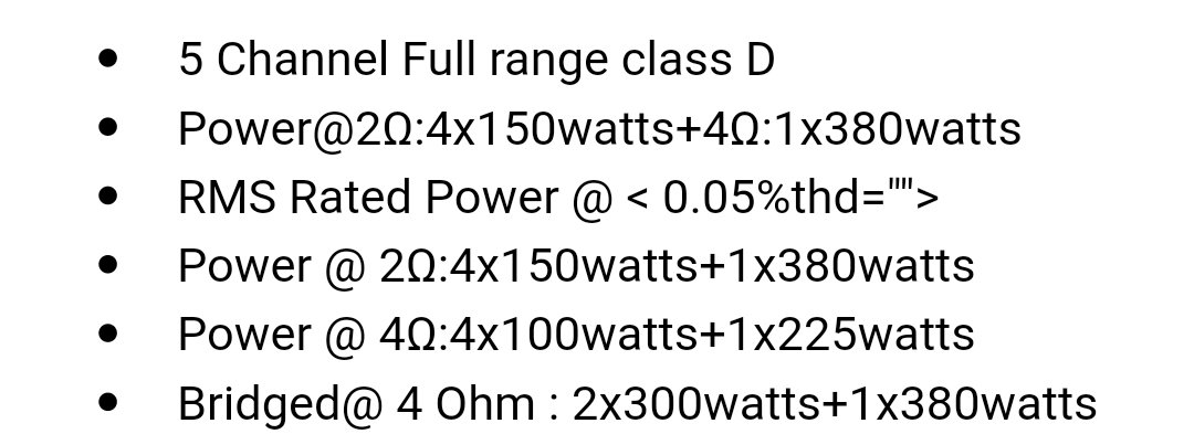

Lastly I'd say that pretty much any outboard amp will be an improvement over whatever power your source unit is driving, and even 50-60Wx4 + 300Wx1 into a sub should get you a big upgrade. Not sure who all makes good quality fairly priced 5 channels these days but you don't need huge power numbers to have plenty of output and you should avoid brands with over-inflated power ratings on general principal since companies who come out the gate lying to you typically aren't selling good quality products.
Something like this.
