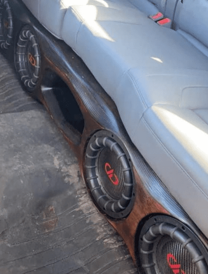

They look nice but $1200 is crazy. How did they sound Bobby?
It actually sounded better when the port was covered. The port was just way too big. The owner had some Fi 8's ($200/each) in it originally. One problem, Fi doesn't make 8's. So, we took one of the subs out and what do you know? Somebody, had taken four cheap Skar 8's and changed the dust caps and sold him $60 Skar 8's for $200 a piece. So, in closing, the Ampere 2.5 8's sounded good, but the box was still holding them back. The amp was an Ampere Audio 2K. We know who did it to the subs, but no need to mention names.
That sucks hard. When I first read Fi 8’s I was questioning that as I’ve never seen one. Sucks for that dude. So I’m assuming the box was loaded when he bought it?
That Ampere Audio amp was on my short list a little while back.
That ***** hard. When I first read Fi 8’s I was questioning that as I’ve never seen one. ***** for that dude. So I’m assuming the box was loaded when he bought it?
The box was loaded and cost $2K. He ended up getting the money back for the subs after calling the guy out. Then, the guy who did it to the subs had some BS story and banned some people from going to his business anymore. The same guy also broke one of the Focal crossovers and didn't say anything. So, that had to be replaced also.
