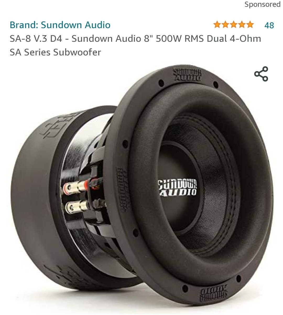

As far as sub stage I would probably do
4 of these. D2
Amp for subwoofers
Then get a box design from Buck on here and have a box built.
The Sundown Sa8v3 would be a good choice as well.
