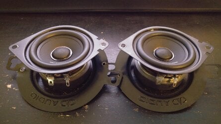

I’m just reluctant to go three way because the morel ccwr254’s that I’m looking at for the factory mid location say they play up to 19k but I’m not so confident that expecting 3k-19k out of a 2.5 is optimal compared to distributing across a midrange and a tweeter. Plus I’m looking for a quality soft dome that has no grille or housing.

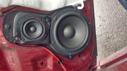

2.5 wideband drivers can get up to ~20khz if they're on-axis. Off-axis, expect them to roll off at ~5khz. Take a look at CDT, they have decent 2" wideband driver. I'm not sure if that wideband is available in any of their 3 way kits.
I too would say go with the 3-way. Depending on the amplifier(s) you use you may not need a 10 channel dsp as a 8 channel might just be fine with additional planning. The amp may have the ability to bandpass for mids and midbass. Just remember... you can run more than one DSP as well. I would run the 3-way and just figure out the best way to run each channel. I ran 3 1/2's and tweeters with passive crossover while using a DSP... saved me two channels and I still ran 6.5" midbass. You have limitless options.
