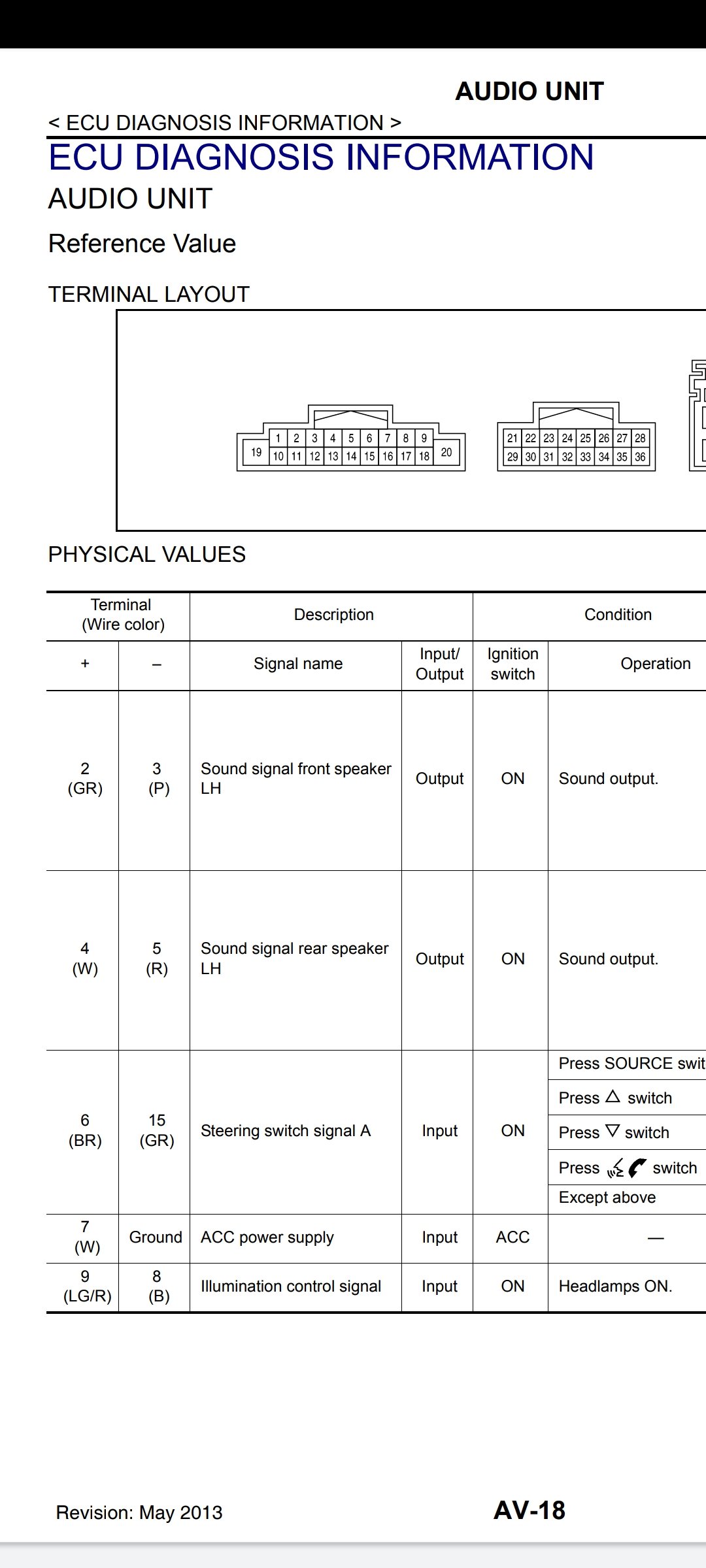

1. The black wire (ground) coming from the adapter says for Subaru only. Where does that ground go. Im thinking it needs to be pinned and go to the ground pin from the car. I have the pin layout from the car, but wanted to make sure which pin is the ground I want. (Picture attached)

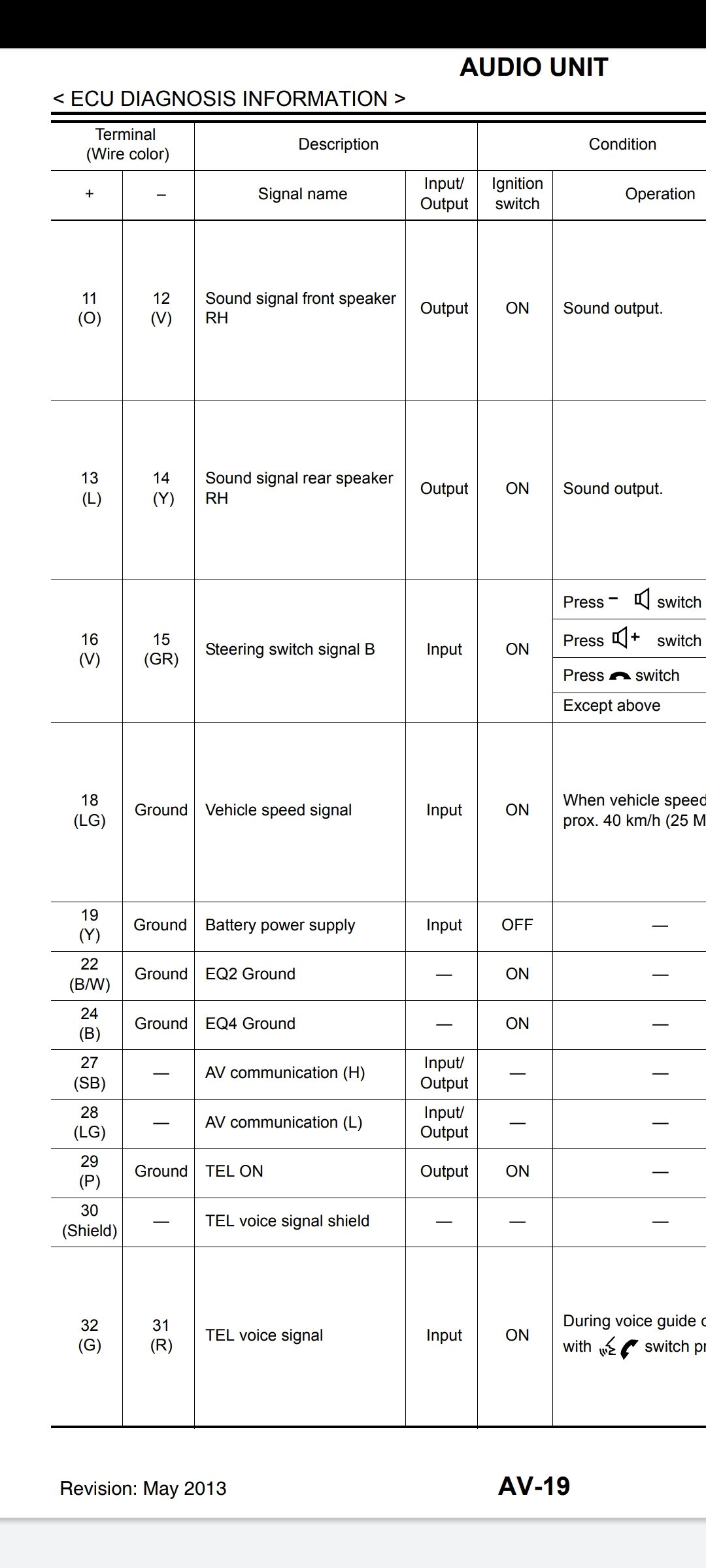

3. Im also not sure where to connect the speed control wire.
I attached the table for the pins, but i want to be 100% sure.
1. So from looking at that pinout it looks to me like the black wire on a Subaru needs to run to the harness maybe for some sort of sensing or fusing, but on other cars it's acceptable to just run it to the vehicle chassis. Use a terminal loop or alternatively you can add the pin and run it through the harness. There's not really a disadvantage to either way. A lot of radios have two ground points, one that goes to the harness (the car's official ground near the fuse box probably) and a terminal to hook directly to the radio cage which is well connected to the chassis. In general I think having 2 is good, but adding a pin in this case isn't necessary if it's just a ground point, just make sure you sand the location around the bolt you use to get a good connection.

3. The speed control wire if you're talking about where to connect the head unit's wire it'll be with light green, pin 18. If you're saying the head unit doesn't have a corresponding use for it that's most likely because while your stock radio had volume adjust with speed, the aftermarket unit doesn't. I personally find that to be an annoying feature to enable anyways, but theoretically it can save your volume knob some use. If your head unit doesn't support it then just tie it off.
