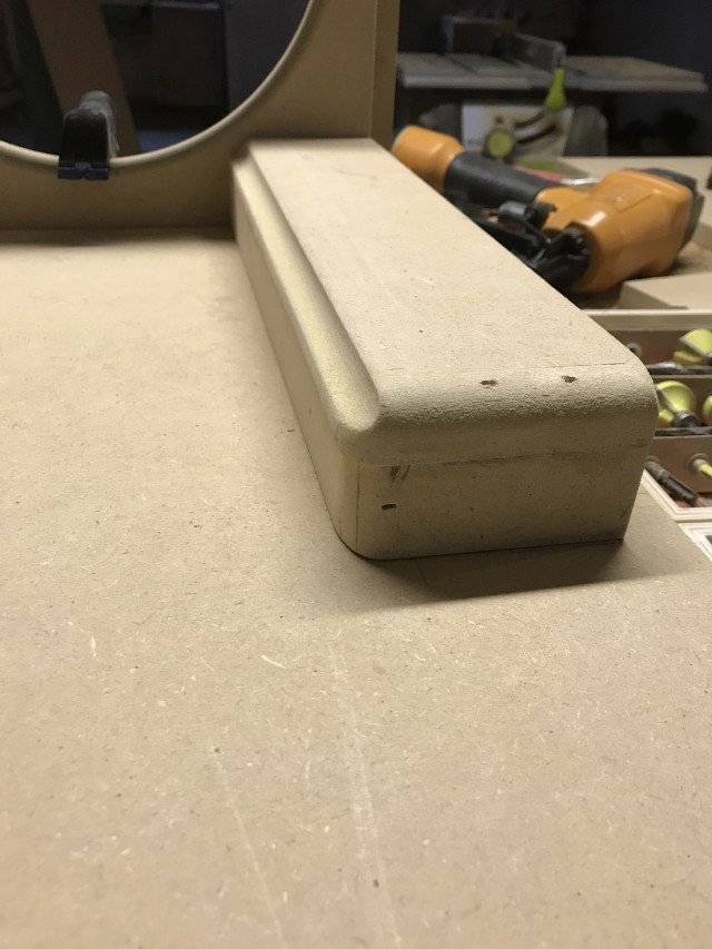

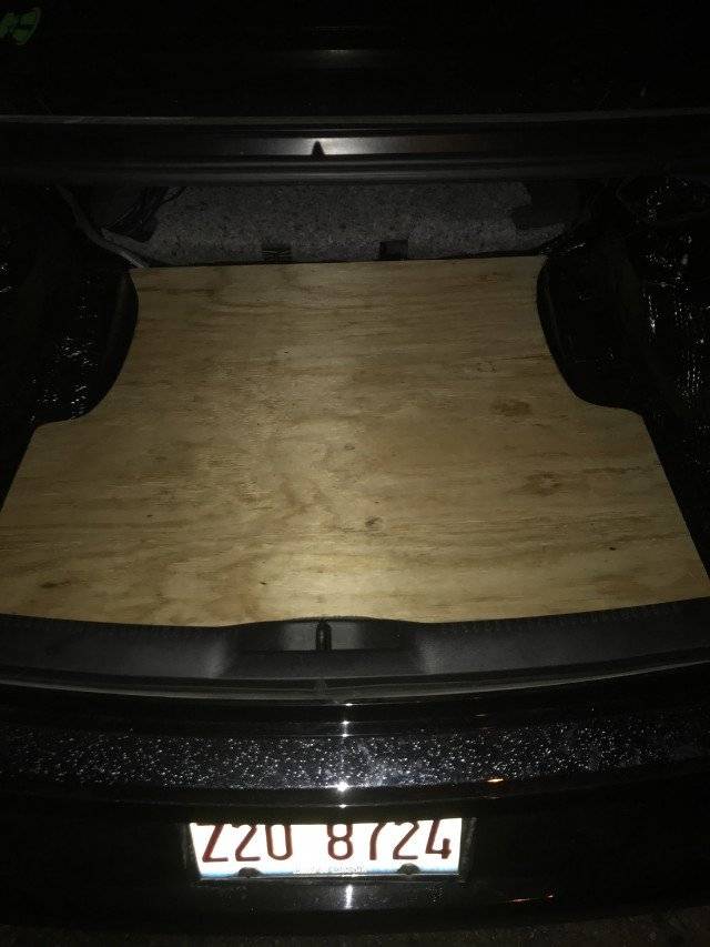

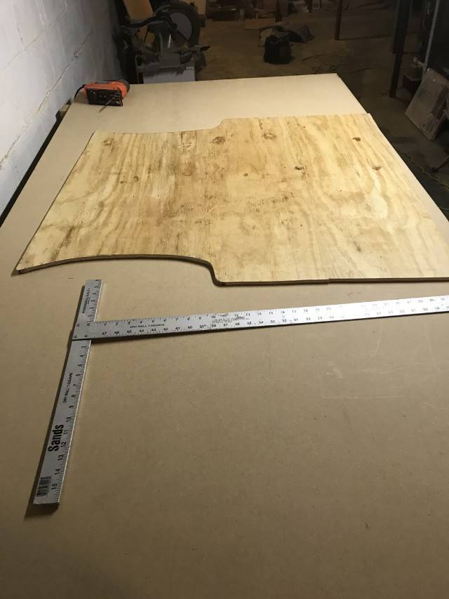

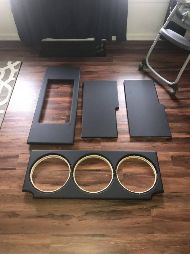

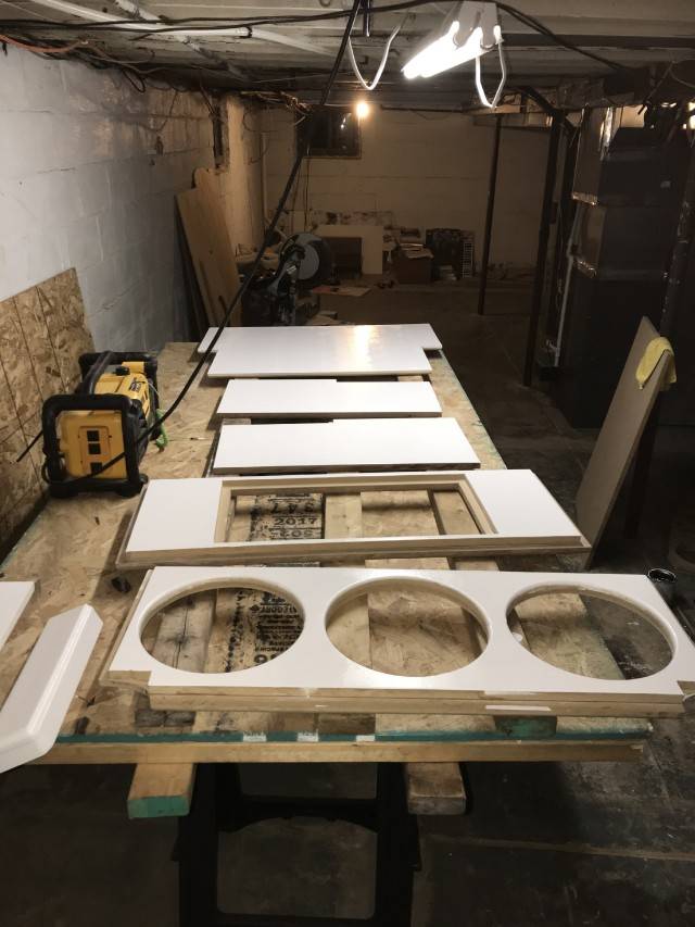

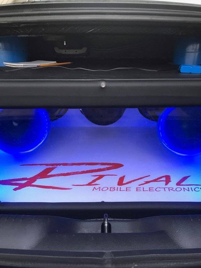

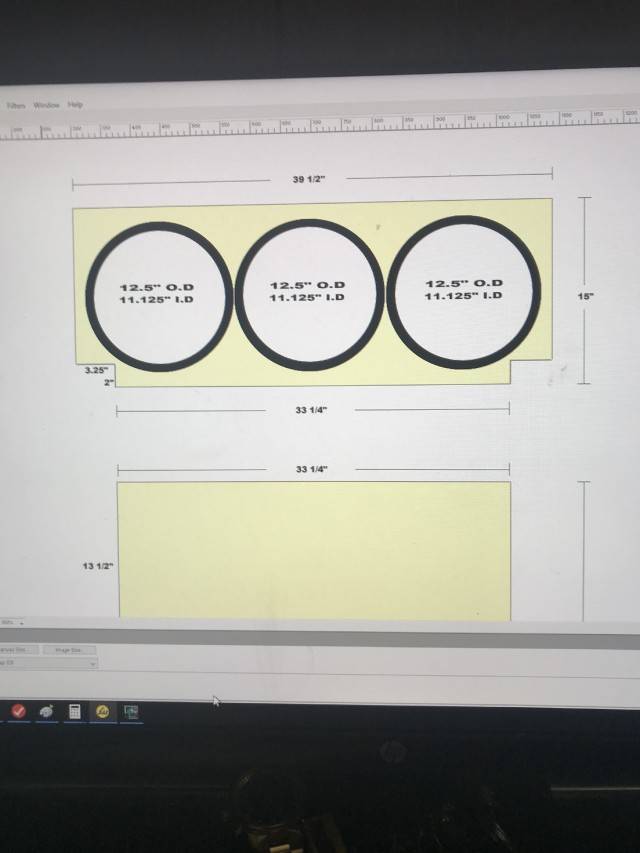

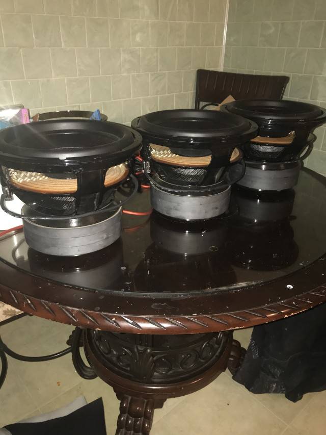

Ill post some some pics shortly I have tons being this is only my second box //content.invisioncic.com/y282845/emoticons/smile.gif.1ebc41e1811405b213edfc4622c41e27.gif fun hobby! Just got into car audio a couple months ago
the two 12 version of this box porting in firing in did 146.9 on window. hoping for 150 this go.. tuned to 30hz
---------- Post added at 09:58 AM ---------- Previous post was at 09:57 AM ----------

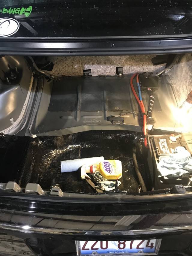

Does your back seat fold down?
yes, seats drop and raise. can still fit the 3 kiddos in
Very nice dude. Great work. I get super jealous when I see this stuff.
