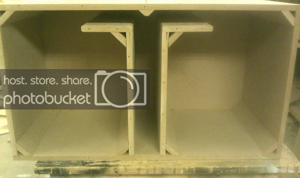

I have different desires from my audio system now so I designed a different box, one that will be tight and clean while simultaneously delivering MOJO fabled power.

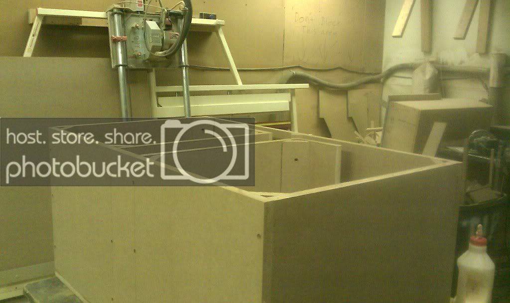

Here are some pictures of the MOJO box and then the box that I built for the FI.
Memphis recommends 30 sq in of port area. I made that decision on their recommendations.Im not saying that they are completely correct, just giving you and Idea of how/where I started.
Why do you think the port is too small?
Im not implying that your wrong, just interested in getting a more holistic ideal.
I was thinking of supports but I don't know the rule or guide lines of their distribution.
If you have any Ideas about it would you please share them?
AS ALWAYS thank you for the critiques.
I say this based on my experience building boxes and from what I have seen others do. On a higher excursion woofer (xmax > ~15mm) a bigger port will help to increase the amount of air moved. When doing a slot port you should aim for 12-16sq in per cu/ft of airspace. A woofer like yours would be towards the upper end of that. It looks like your box is somewhere in the 3.0-3.5cu/ft range so assuming that on the low end of that figure you should have 36-48sq in and the upper end would be 42-56sq in. By having a small port you are more at risk for port noise (whistling or chuffing) because of the higher air velocity, especially if you have hard edges at the port openings.
