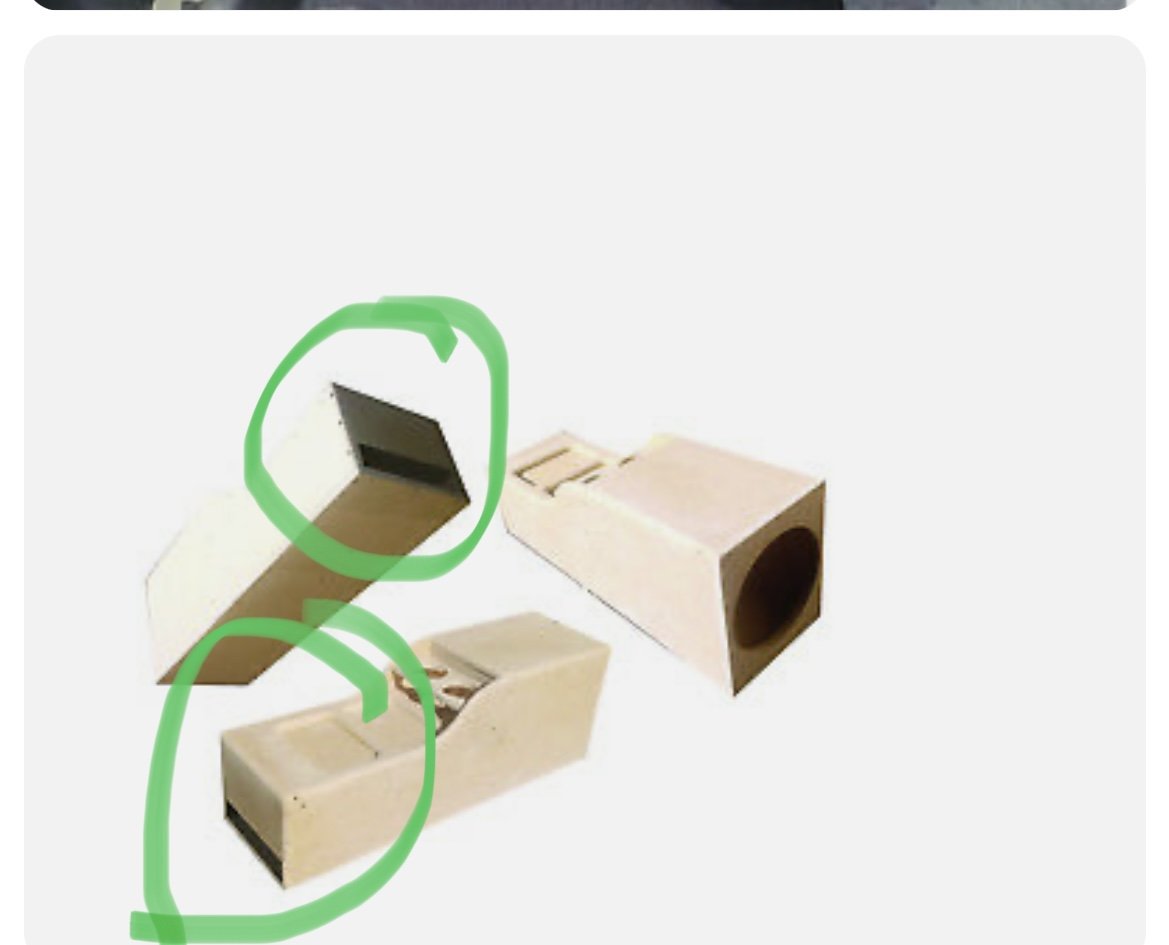

See the port in this pic, having the port in the bottom off the box is not possible due to having the subs mounting on that plane. So, seems my option it to design with the port on top, if that makes sense

I like the behind both seats idea and have proven results with one of the designs you did for me. I’m going to try firing foward close to dash this time. This way has me very curious thanks to @deez283 advice
Hmm, I’m trying to get a mental pic but I can’t,lol. I know your not feeling well but can you kind of give me an idea of what you mean?
You can put the subs at the back of the box and bend the port like an accordion at the front of the box. I’m not sure if I have an example. The port doesn’t have to L, you can make the port bend into a U or S shape, that way it doesn’t run into the subs.
Gotcha. My problem is I’m not good with calculating the port area/volume. I used bassbox pro and got a design. It was simple straightforward. It did the calculations for me. It’s limited thought when trying to place a port a certain way.
