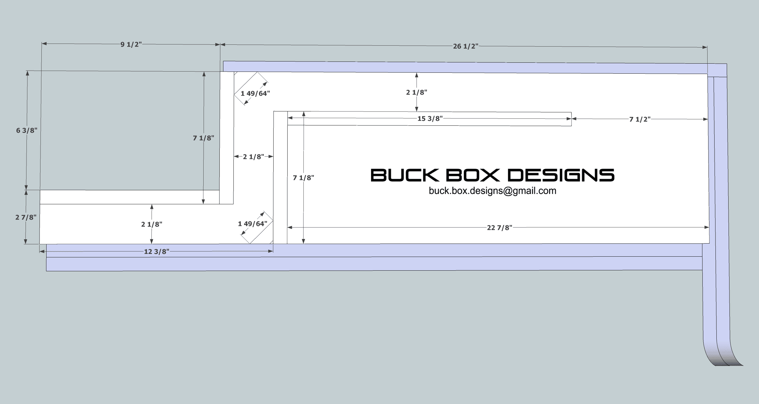

Here's how the port layout in my box is, It keeps the port on the bottom and allows a long port the way it wraps around.. I then changed the sidewalls (made them taller to fit a console cupholder out of a newer suburban) while keeping the port the proper size..
dustin s 1994 silverado 2 dayton svc 4 ohm reference ho 10's ported downfiring back wall.png
Gotta check the mounting depth. What’s the airspace of this enclosure?
