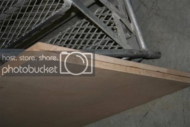

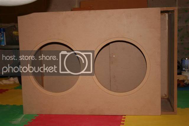

this is the new box that will be the home for 2 15" DC lvl 4s w the D1 lvl 5 coils in em....the box is 7.5cubes w 100sqin of port tuned to 30hz LOW AND LOUD :good:
on to the pics tho we all no you guys like them....
just the double baffle just sittin there...you get the the idea...
that is all for now :ph34r:

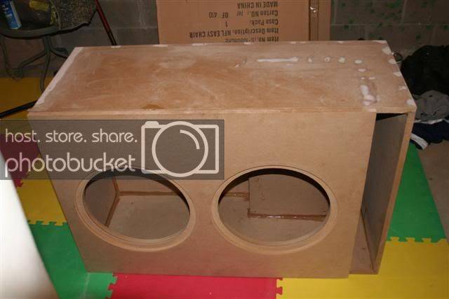

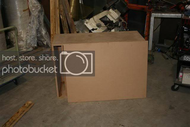

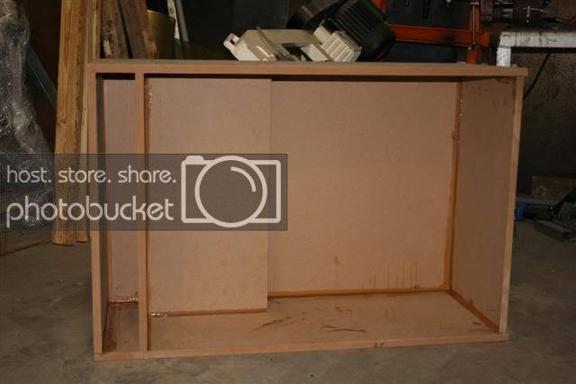

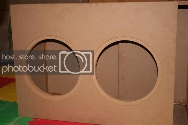

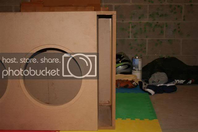

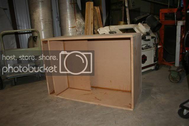

new pics from 2nite....its done just need paint....it goes to the painter 2moro!!! but here are the pics!!
there ya go for now!! new pics with it painted should be added friday!

huge box, and since its tuned so low you can always put in dividers later to up frequency.
yessir!! well see how it sounds by this time next week!! subs get ordered 2moro!

looks good so far, just some pointers though-
looks like your double baffle ist flush with the port? unless you plan to sand it down to round it over more than you could with a single layer of mdf. fyi, your better off bracing your baffle than doubling it up with no bracing. but double baffle plus bracing would be best. esp. with a big *** box like yours with 2 15's. brace it!
