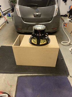

i glued and srewed the box tonigh. tomorow i will make the hole and add the carpeting.
im not realy sure it will fit in the trunk too :)  i think it will be necesary to remove my wiper motor in the backp to keep my rear seat and close the trunk... i will send you picture and the end of the day.

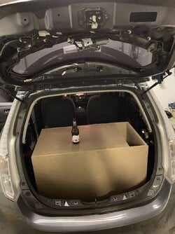

to much to do today so i only finish to screw and glue the last panel.  and i work for the rest of the week. maybe try to make the big hole after work tomorow. slowly but its fun to take time :)  i keep you updatated.
it fit!!!!
