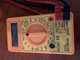

You can sort-of test if it is either good or bad, but you'll need a meter that specifically tests capacitance to know anything more than that.
A standard multimeter will not have the capability.
Mark Rumreich? Electrolytic, Mica, capacitors. Or ceramic capacitors, or Coupling capacitors. As filters. Which one is the capacitance mode? That is a good book. Though he doesn’t state it, assumed color to color as the basis of wiring procedures. And few other tricks​

For accuracy, you will need a spectrum analyzer and a sound processor that will generate the exact frequencies you are looking for. However, there are cheaper methods by using a phone app.
