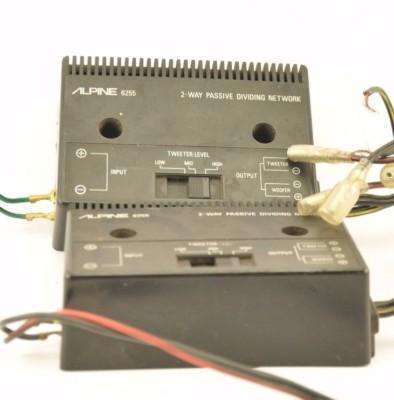

Need information on testing passive crossover capacitors.
Are those Nichicon or Panasonic caps,electrolytic caps or metalized polypropylene capacitors.Also anyone know what brand Alpine itself originally used in their electronics.
replaced,Should I just stay with the original electrolytic caps,same numbers on them
A 38 year run is not bad at all. Leave nothing to chance by erring on the side of safety
They make them all. You can even find those cap in eBay. In the search bar, type in "Nichicon audio grade capacitors". You do not need to add "audio grade" but it helps you locate the higher graded ones.
Just be aware that the standard tolerance for aluminum electrolytics is +80/-20%. That's fine for a power supply filter cap, but not good for a crossover. This may be where the "audio grade" tag can help in a search.
Hi Sorry for the late reply Maylar, I,m just geting back in,and back to the computer. Thanks for the heads up on the standard tolerance for aluminum electrolytics is +80/-20%. That's fine for a power supply filter cap, but not good for a crossover information. That information makes a lot of difference in choosing replacement capacitors for the crossovers. With your obvious experience in this. Is there a certain audio grade capacitor brand ,and company that you would recommend and trust in their capacitors,Also would you recommend I just put original electrolytic capacitors back in ,or put metalized polypropylene caps in.Thanks again for all your help.
Thanks again Mitchell for the advice on testing a capacitor with a multimeter.I found out the multimeter I planed on using didn't have the capacitance mode on it,So I will half to use your method to confirm things. Keep up the good work everyone.
Mitchell's method for testing caps is wrong. Mitchell is the class clown here, I'd be cautious about following his advice.
A cap charges when you check for resistance; in an ideal world, you would see this in the form of increasing resistance. With a digital multimeter you may not see the resistance increase (aka charging). An "open" cap isn't necessarily a good cap. Additionally, caps can "drift" with time, so you really a true cap tester.
