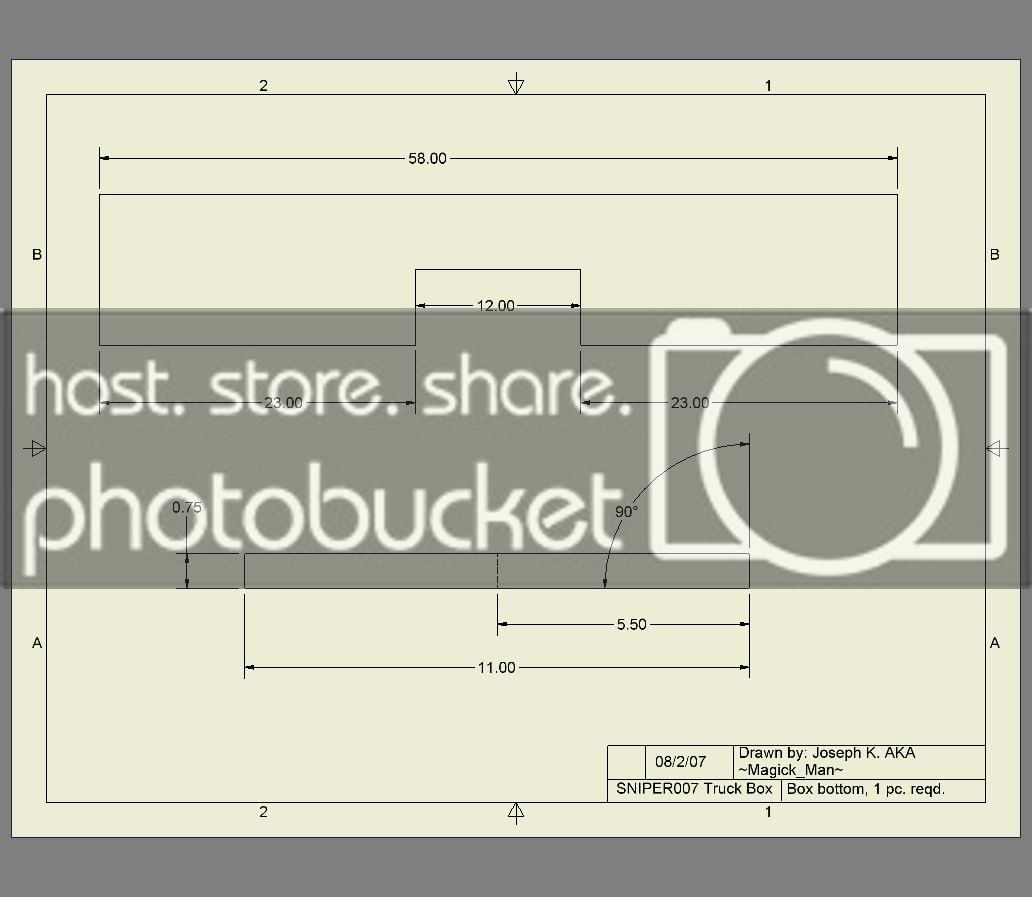

well i gotta jet right now ill be back in a hour or so, Thank you magic for helping me dude awesome job. Also dinty for taking time outta his day to explain a lot of things about my project.
i dont think i will have time to finish it right now.
i have to go to work.

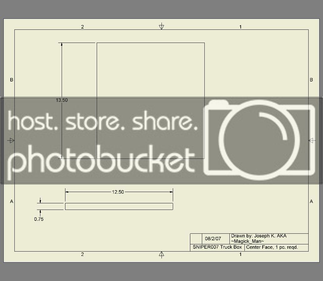

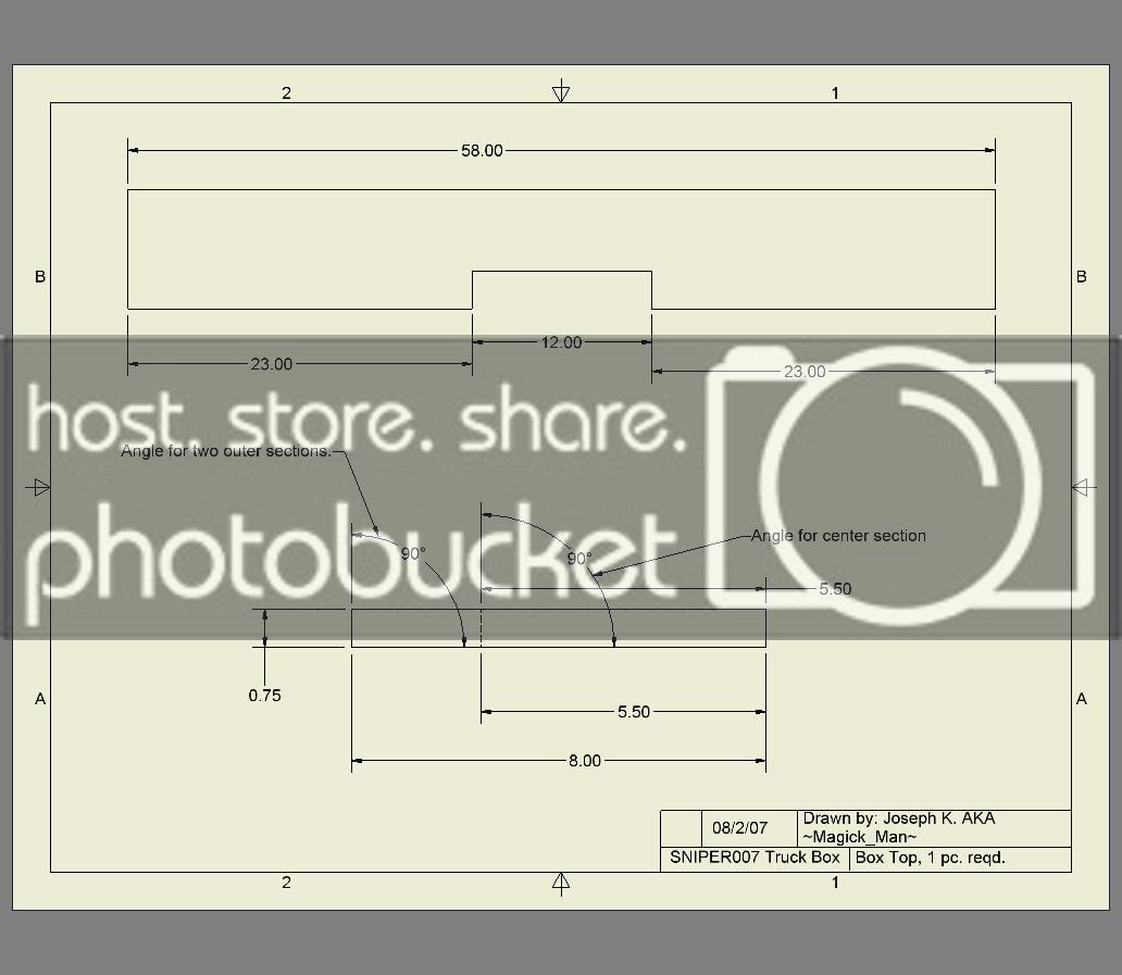

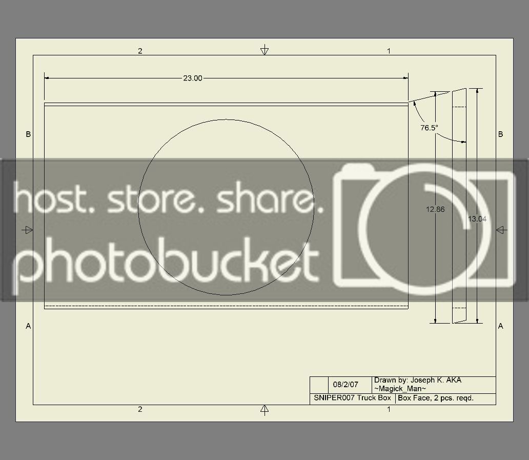

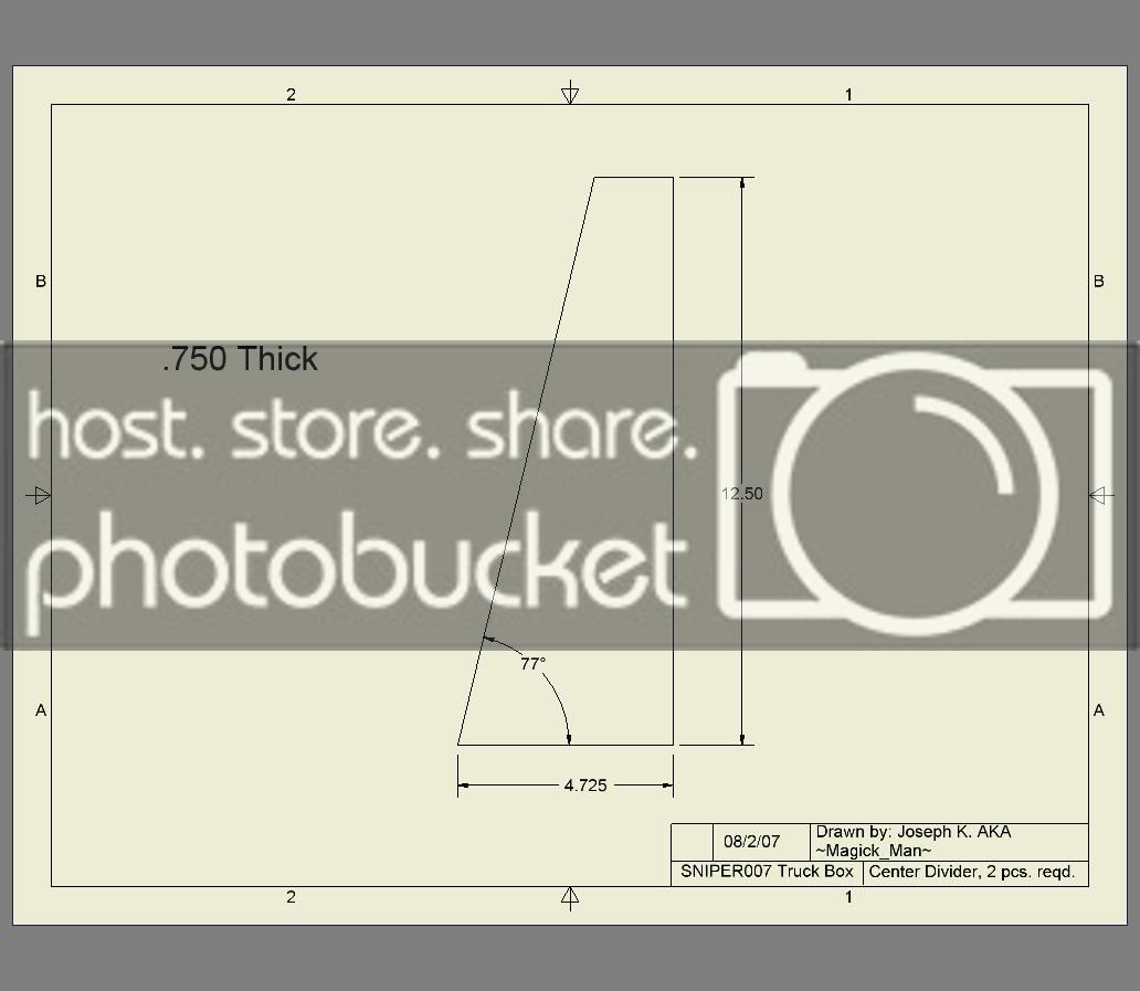

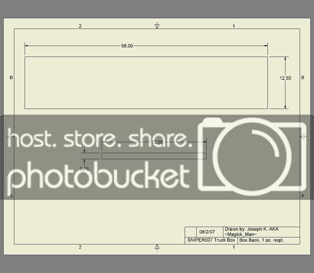

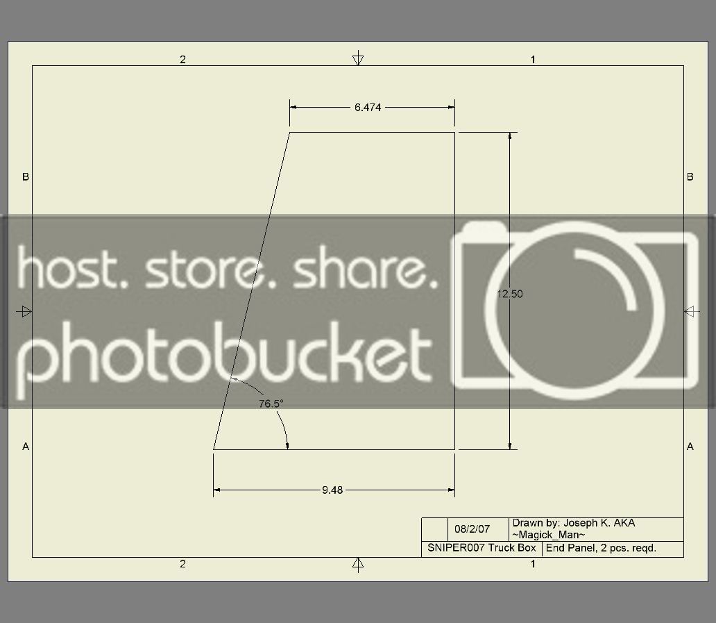

so i will give you the two different angles the faces are on.
and you should be able to sit down with a piece of paper and figure out the pieces since you have the dimensions.
the faces that the subs mount on are on a 73° angle.
and the center console section is laid back on a 83.5° angle.
you should be able to get the cut list with that info.
but if not and nobody else has done it by the time i get off work i will finish it up for you.

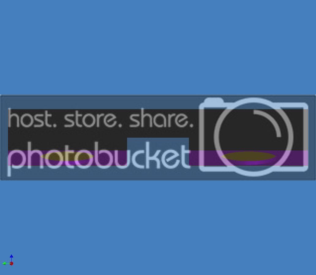

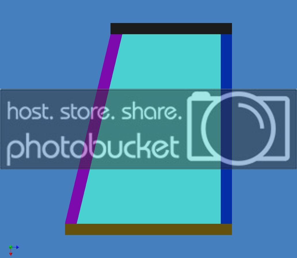

Are you wanting to build in seperate chambers like this
or build it whole like this??
btw, I ask because you can make small cuts like in the 1st pic and just screw the boxes together.... or like the second pic, you'd have to cut larger pieces for the top bottom and back all the way across.
alright give me a lil bit I've got to run somewhere but I'll either work on that tonight or sometime tomorrow.
edit: will you be able to figure out the angle cuts on your own??
