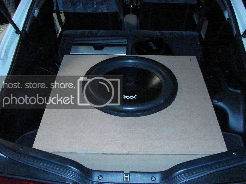

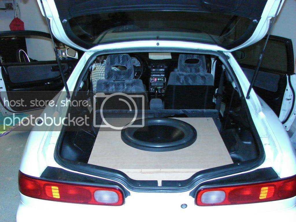

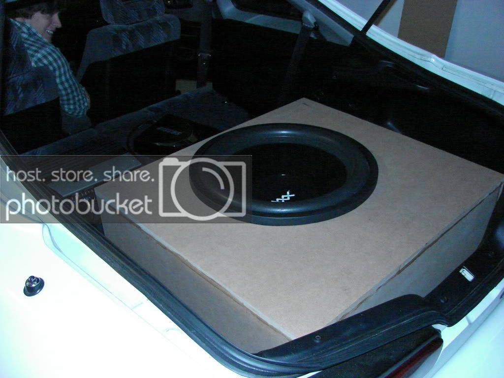

Go ahead and forget all the rambling that is in my above posts. I have an integra, and it has a XXX 18'' in it(now) lol. Got it in on monday, and will pull it out tomorrow till I get done with school for the semester. Just decided to build the box and throw it in on my spring break due to boredom.

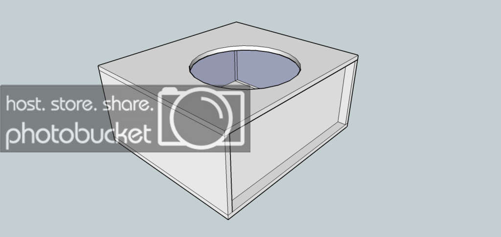

Well anyways, 4.5 cubes, sealed. I have my DSC2000.1d in there temporarily running the sub at 1 ohm. I have just been watching my voltage and make sure it doesn't drop past 13.5ish.
But anyway, it is by far the coolest sounding setup I have had in the trunk. Never heard bass like this before. I can back the sub down to match up perfectly with the mids and just listen to the thing for hours. Picks up every note imaginable(LPF=63hz, 24db/octave) and does so with precision. My collection of rap sounds completely different on this sub, but it feels like it is being played the way it was meant to be played.
Sub can destroy my ears on command and I can say it is honestly the loudest thing I have had in my car(to the ear) to date. Beats out a couple of low 140db setups I have had in my car in the past.
