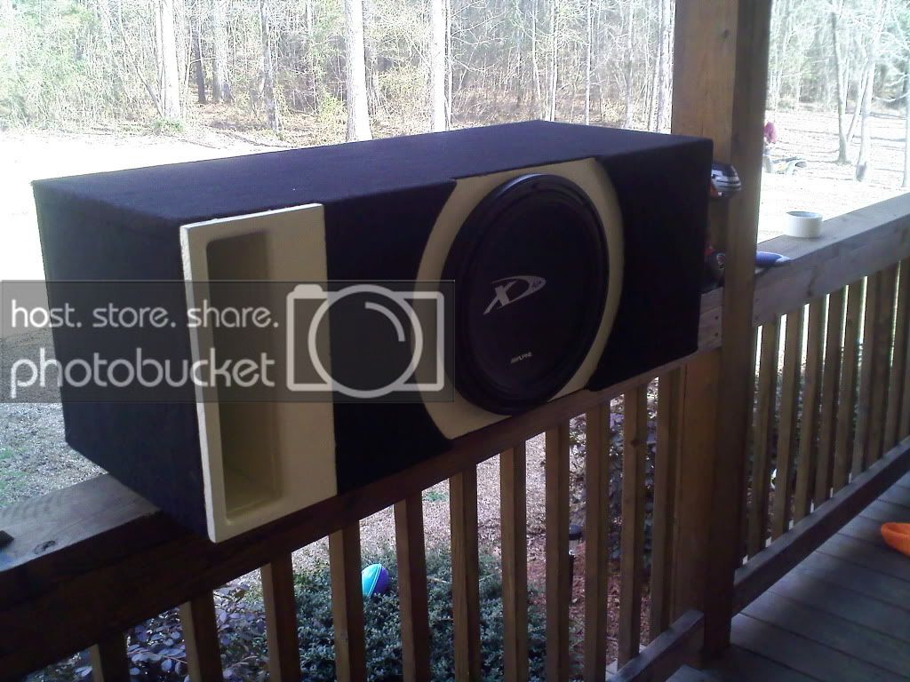

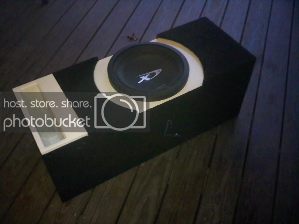

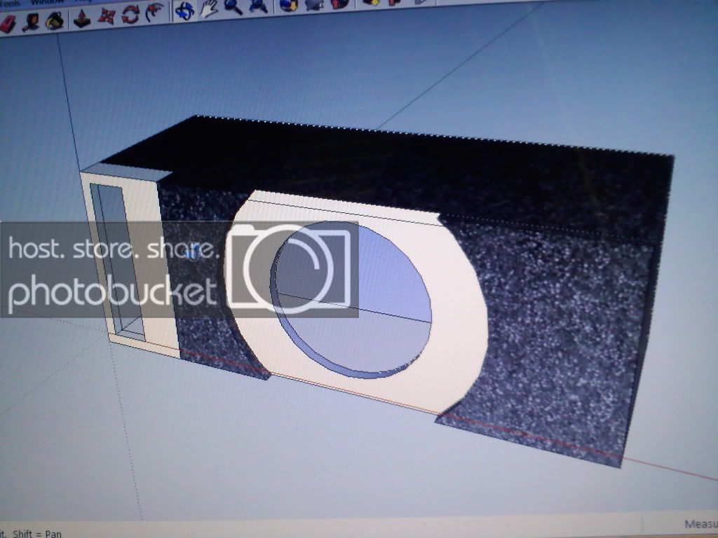

this is my latest box built for a friends scion tc....its for a 12" type x, 1.8cubes after displacements at 31hz....
here's the design

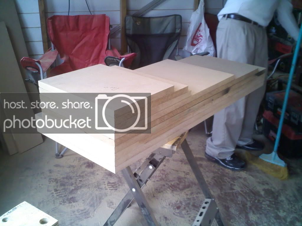

pic of the pieces

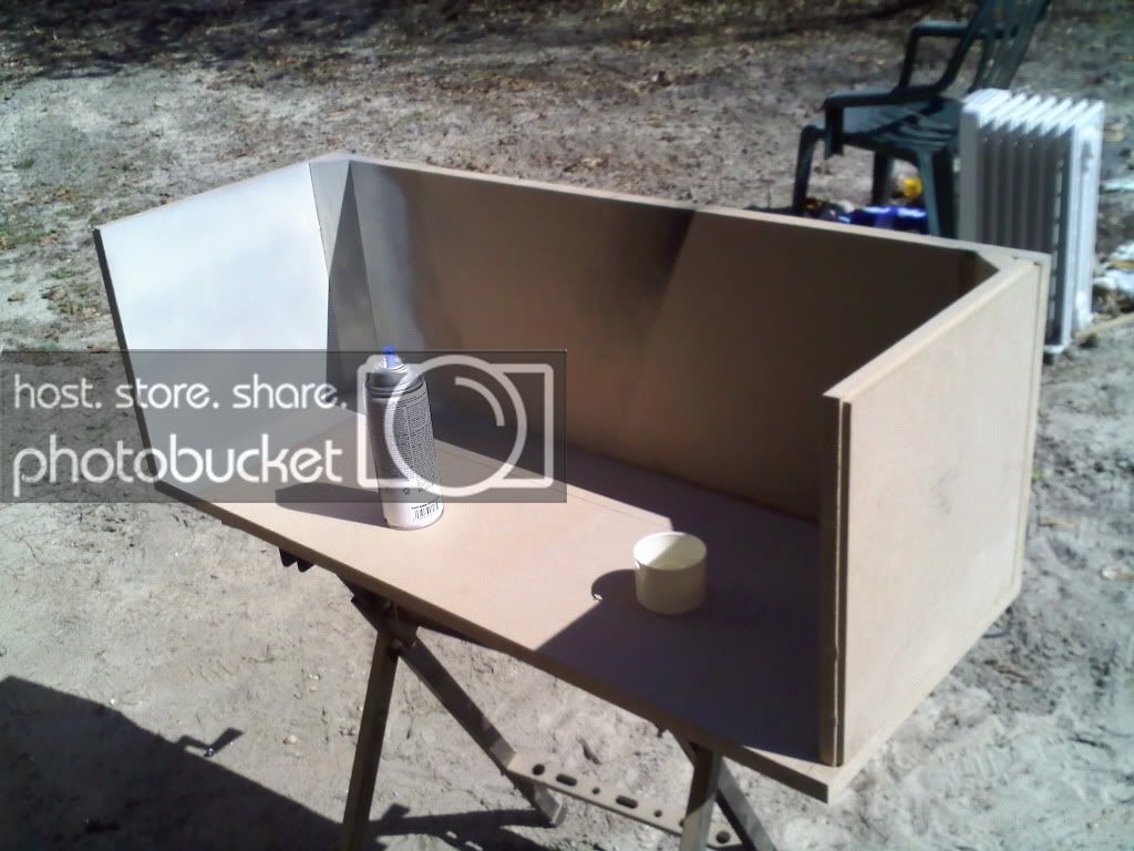

painting the port

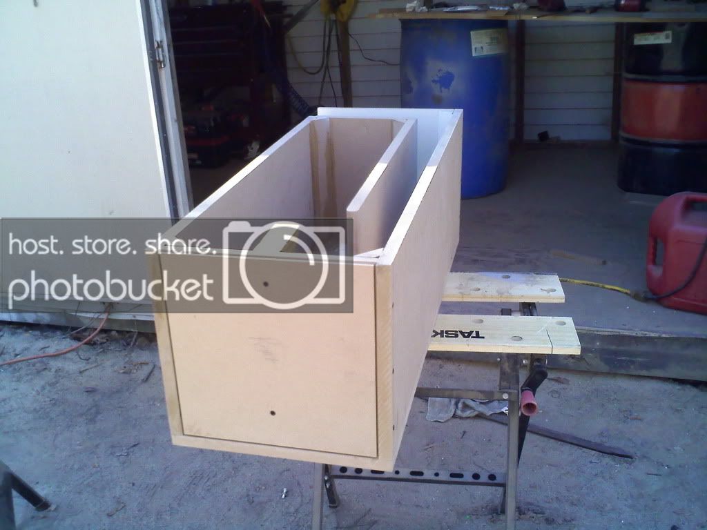

pic of the inside

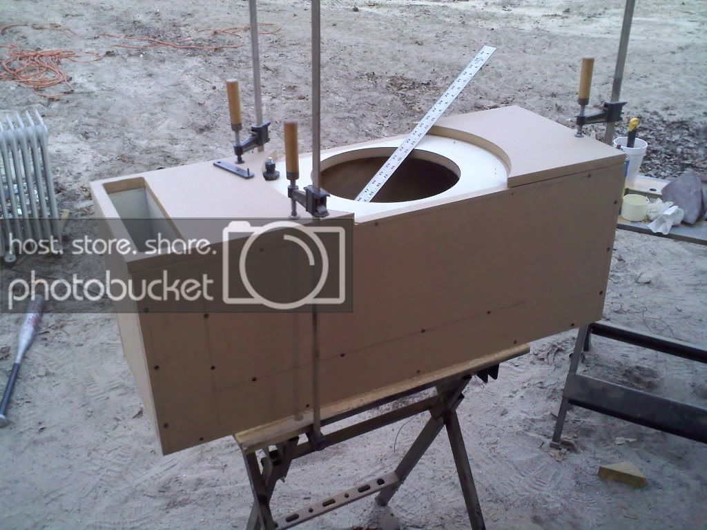

finishing the baffle
